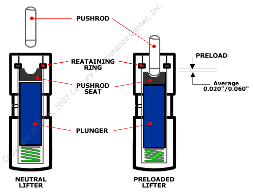

I'm still having trouble understanding how to put pre-load onto an oil filled, or pumped up lifter.
Left the car overnight, expecting the lifter to have bled off a bit, but it was still really hard, and tightening the rocker made the valve spring compress.
I guess I will have to make a mess and do it while it idles...now that i can get it to idle.

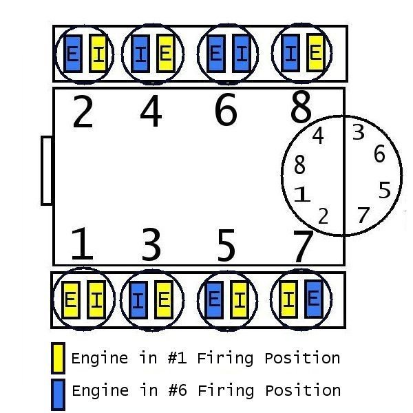

The engine pros can correct me but hot/cold lash is a solid lifter thing. Because a hydraulic lifter has a stiff spring inside backing off the rocker on either a hot or cold engine the plunger will be in the same position. The difference in expansion with a hydraulic system is negligible....that's the beauty of it.
Try this.
1. Warm engine up.
2. Set engine to TDC on balancer
3. Set lash on half the valves as per the picture below
4. Rotate engine 360 then set the other half
5. Done

They can not "bleed off" because they have no oil left in them to bleed off.
You are still too tight. If the valve is moving at all while you are adjusting, there is no adjustment left in the lifter.
The lifter has an ability to compress slightly to accommodate the adjustment (and future wear). The oil will leave the lifter as it compresses when you tighten the adjusting nut but we are talking only a second or two max for that to occur.
Back the nut off and wait a minute for the lifter plunger to come up. They are designed to pop back to the top by themselves.
Lifters do not "pump up" with oil. They will FILL with oil but not "pump up" ...unless the engine is revved past the valve train limiting speed (that event can "pump up" lifters) but even with that, the oil will be pushed out in a second or two once the RPMs come back to normal. The excess oil is pushed out and lash is returned to normal
Try this.
1. Warm engine up.
5. Done
Exactly!
That was the diagram I was referring to in an earlier post.
The "while it is running" procedure is great but you have to deflect the oil so it is not a mess. And while doing it that way remember that these are hydraulic lifters. Make sure they are new or recently new as you don't want a stuck lifter in the down position that you tighten more. Wiped cam lobe is a possible result there. Watch the effect as you tighten the rocker down that 1/2 turn. By the end, all should be pumping oil and running smoothly.
I totally understand what you are saying, and it makes sense. Maybe just a little more information on what I am seeing and doing.
I loosen the polylock until I can move the pushrod up and down, so there is clearly lash.
I slowly tighten the nut just until it can't be move up and down anymore; the rocker is still loose and the pushrod can be rotated. This to me would normally be 0 lash, and then would tighten another 1/2 turn.
BUT, when I do the 1/2 turn, it compresses the valve spring. The spring in the lifter does not appear to compress at all.
I tried loosing the rocker so there is noticeable lash, and I can move the pushrod up and down, then turn the motor over 2 times. (I don't know why i did this, but my thinking was that maybe the lifter was stuck in a compressed state, and somehow rotating the engine would free it up.)
So I did this, and I had the same result. The lifter does not seem to compress at all.
Currently, that valve is set to 0 lash, with no preload.
The "rotated" push rod is where the issue is. While you are in the "adjustment zone" of the lifter, the up and down motion will be eliminated AND the pushrod will still rotate freely. If you actually feel drag on the pushrod, you are past the range of adjustment (too tight) and the valve will be lifting off the seat.
You are not damaging anything with the cam so no worries there. Roller lifters will not wear funny because of the start up procedure.
If the static adjustment method is still not working out you probably need to use the running valve adjustment method. Best to do on a cold engine. Set idle as low as you can and back off the nuts one by one until you hear the lifter "clicks" then tighter them 1/4 turn down past quiet. That will get you going.
Uh-oh....
With the engine not running, find a valve totally extended up. Loosen the rocker arm nut until the pushrod is just loose. Using a wooden dowel or something not to scratch your rocker arm and push the rocker arm down at the pushrod end. If it does not move downward (visualize it pushing into the lifter and pushing down the inner spring of the lifter - it should move enough to feel like a small spring pushing back), then you might have solid lifters.
Tightening up solid lifters one half turn after taking out any play will ruin that cam and lifters in a VERY short amount of time.
Look at this diagram to get the idea.
https://www.google.com/search?q=expl...jhG0SWM:&vet=1
A solid lifter has just the upper cap and snap ring and will not compress at all when pushed downward with a push rod.
Let us know what you know....
Can you say with certainty that you have a hydraulic cam?
It is zero lash when the rocker JUST touches the pushrod. The point where it goes from air between them to metal touching metal.
At that point you could still push the pushrod down in to the lifter against its very light spring. You could still rock the rockers a little by hand by compressing the little spring in the lifter. You could still spin the pushrod with your fingers.
You go from rocker arm and pushrod JUST TOUCHING and add 1/2 turn. That is your preload. Your just pushing the little lifter plunger down off the lifter's retaining ring a hair.
Hopefully you didnt end up with solid lifters but I think your just over estimating how much force that little spring in the lifter is going to push back up. Hopefully thats all.

Hydraulic lifters only "move" .060" Hopefully the problem is just over-tightening and the valve is hanging open. It's been a while but once they are full of oil I don't even know if you can compress them by hand and "feel" it.
Yes you can feel the spring compress if filled with oil. The oil will move up into the pushrod. Solid lifters will feel rock solid because the cup inside has no place to go.
