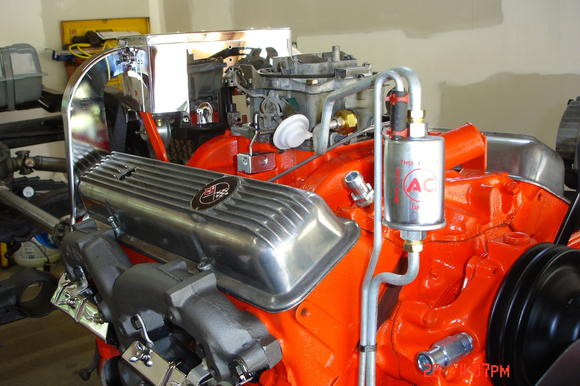

Since my car was a base model 69 350/300 the motor was bored .030 over, mild cam like a 350/350, 4 bolt main and had Lar's rebuild the carb/distributor and the car really runs well with 3:08 gears. However I will change out the gears. I have a complete 4:56 rear and also 3:55 or 3:70 ring and pinions that I can go with. I get to the next red light pretty quick for a little base model but original motor car.
Just sayin................................... ........................................ ....................................
