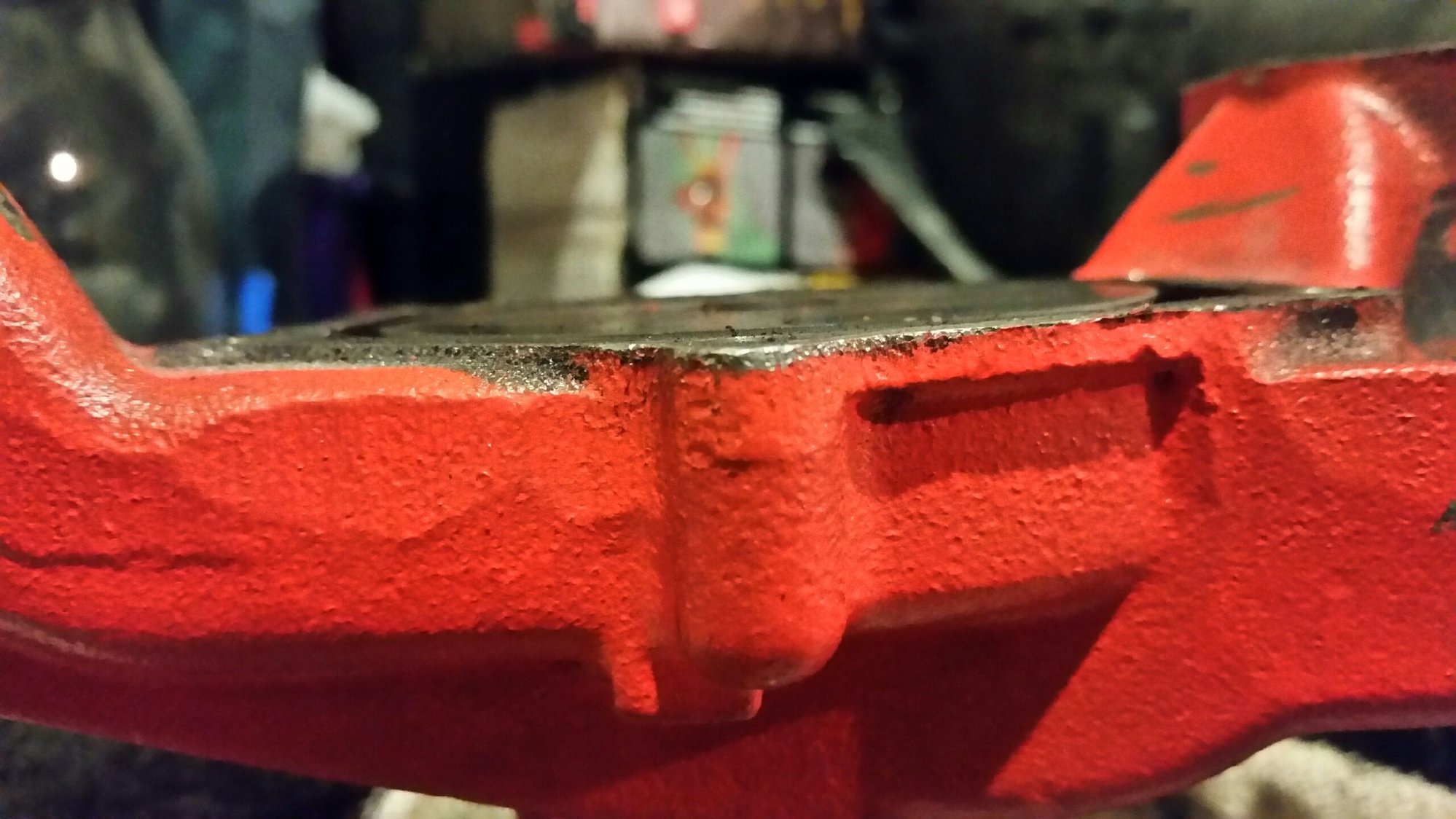

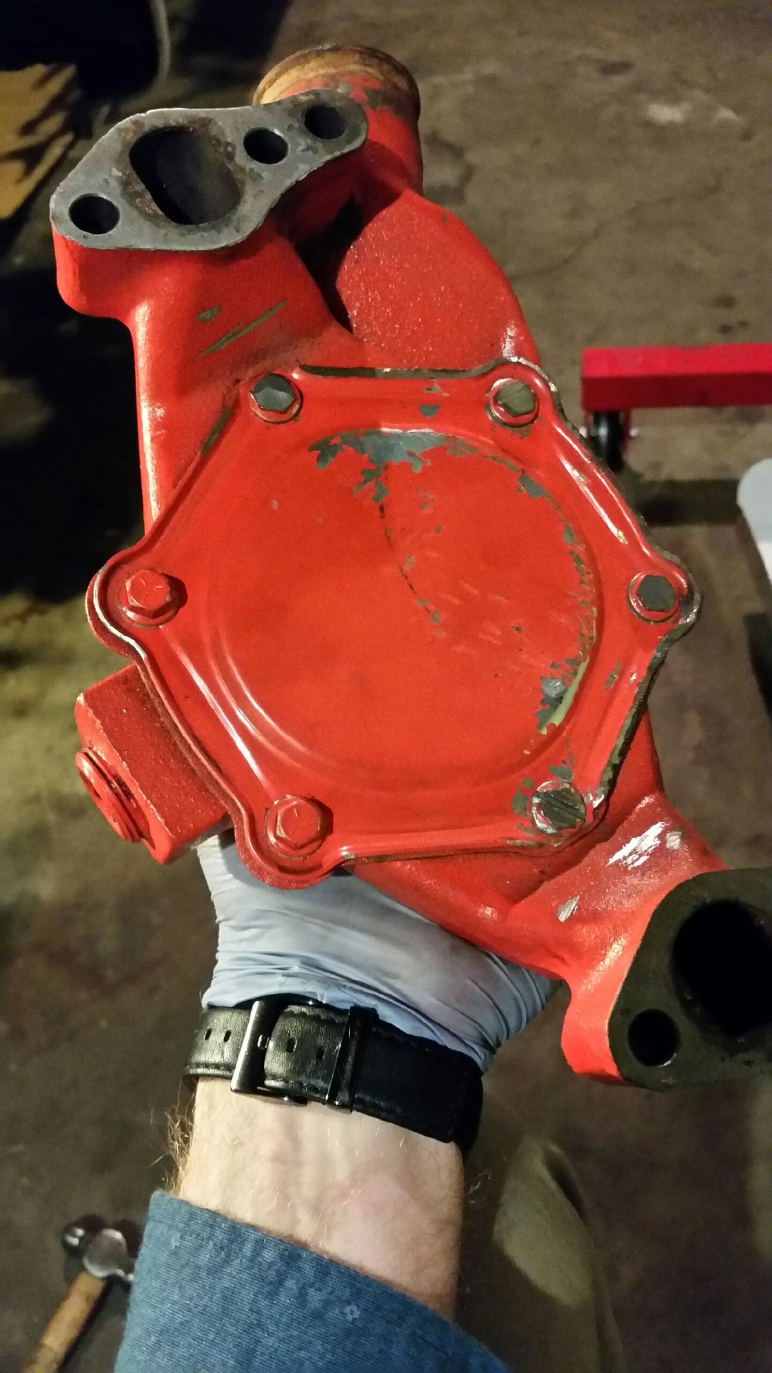

You can see i did a little bit of hammering to slightly flatten the circular protrusion on the water pump plate
Before buying the Cloyes timing cover with the end play button I read a lot of info about people who have issues with the short corvette water pumps. Most of the posts I have read said to grind down the bolts on the back of the pump to get the clearance needed, but that didn't give me enough clearance. The bolts dont seem to be a problem, its the plate on the back of the pump facing the timing cover is not getting enough clearance.
I did replace this pump about a year ago, and I can't remember if I bought a "high flow" pump. Is it only the high flow pumps that have a big of a protrusion toward the timing cover?
I opened it up to see how close the impeller or pump wheel was to the plate, and it seems flush with the body of the pump, so not sure why they added the extra room there inside the pump.
Has anyone ever just used a hammer to pound on the plate to give just a little more room where the water pump and timing cover meet?
Since this isn't the original pump, I whacked on it a little bit, not totally making the protrusion totally flat in the area needing clearance, but just a little bit. After doing this the water pump seems to fit, after torquing it down with the WP bolts.
Is there any reason why the water pump won't work with this tiny bit less space inside the pump behind the wheel?
Should I go buy a regular output water pump?

you can see the pump wheel is flush with the body of the pump
is there any reason why i cant put some RTV on the old WP gasket and reinstall it with the plate slightly hammered in?

I think it is kinda crude but effective on the water pump.....I think I would have taken the cover to the machine shop and had it milled down in the offending area.
That way if you ever put another pump on it it will just bolt right on.
Jebby
Jebby
For how much i paid for the timing cover, I think I'd rather beat on my existing water pump or replace it with the regular flow one. I may do a little more tapping before I paint it again and install.
Are there any risks or pump failure or cavitation by using it with the plate slightly bent in?
Anything i should watch for other than leaks and quickly rising water temps?
