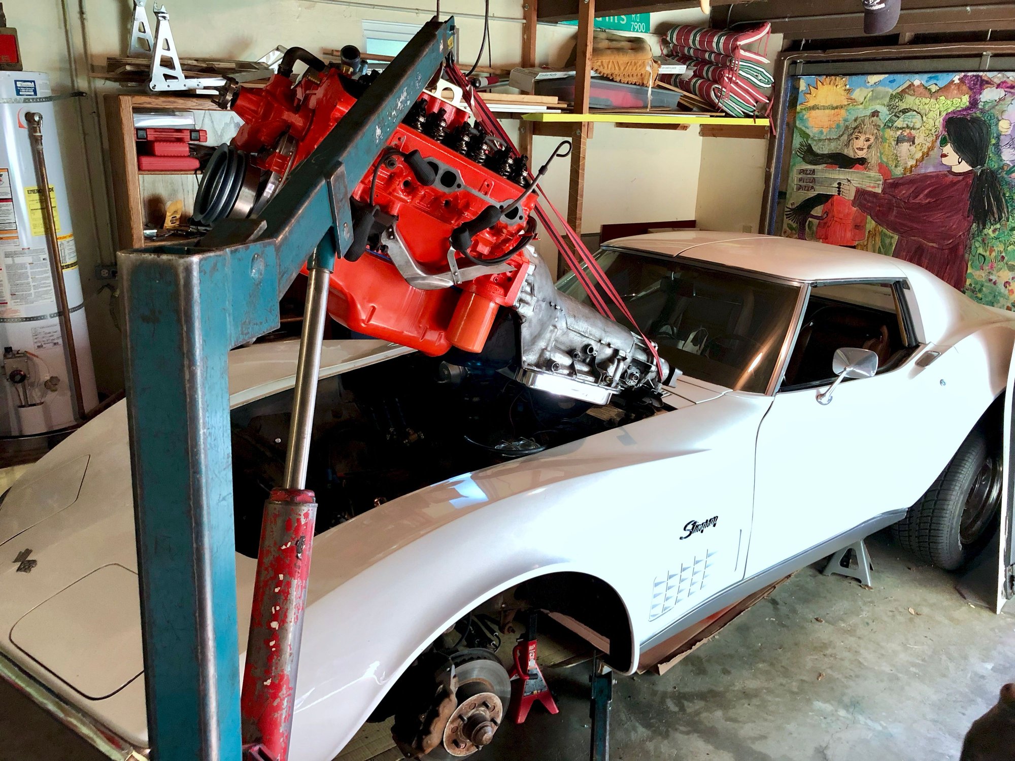

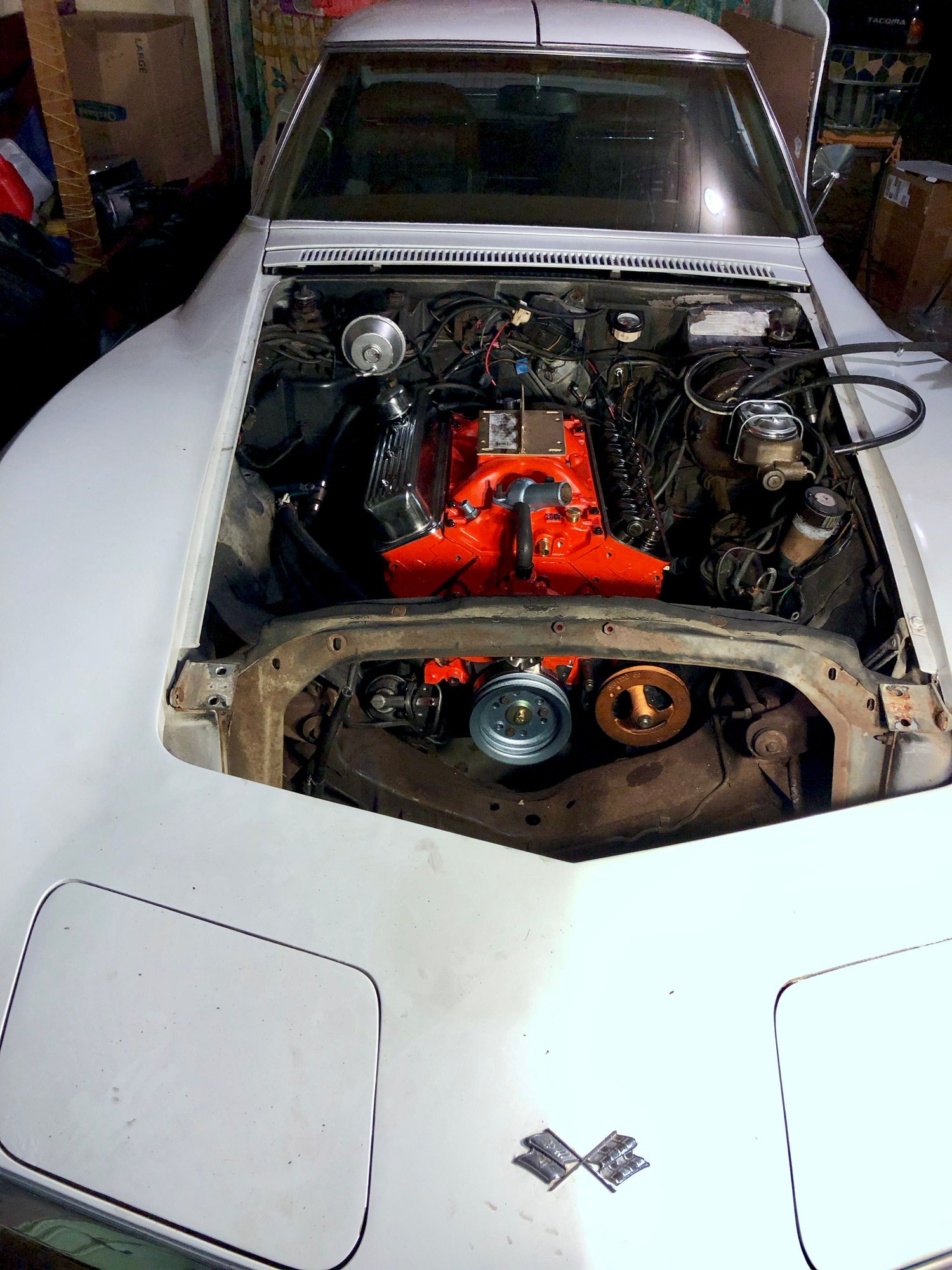

I have been putting all the components back together on the engine, and finally put the engine and transmission back into the engine bay.
WHAT A PAIN IN THE ***!
It definitely wasn't as tough getting it out.
Getting the transmission under the firewall and all the back onto the transmission crossmember was really tough when having the engine hoist coming from the side.
A little side note for the things I did on the transmission; I didn't end up putting a shift kit into the th400, although I'm not really sure if the previous owner did. I didn't open up the valve body. This won't be a race car, so I thought the smoother shifts would be better, and it shifted somewhat firmly before I took everything apart, especially at heavy throttle. The ATF that came out was still red and didn't have anything particularly alarming in it.
I did get a reseal kit, which included front pump seal, tail shaft seal, speedometer gear seal, as well as all the rest of external seals. I didn't change the front pump or tail shaft bearing, but they didn't have any scoring on them when I looked. So I changed all those seals out and put a new filter into it, and hope it will hold up and not leak on me...fingers crossed.
I also used an aftermarket cheapo pan because it has a drain plug on it. I hope this wasn't a mistake.
Before I started taking things apart, the trans leaked more than engine, but it appeared the previous owner filled it far past the top top indicator on the dip stick, probably past the trans pan seal.
I know people love the poly motor and trans mounts, but I ended up going with regular rubber. I like the idea of them absorbing some of the engine vibrations, and the headers get kind of close to the driver's side engine mount, and I am worried it would melt poly. I actually put a ding in the headers to give a little more clearance with the mount.
During the removal process I cut the hose from the hard trans cooler line to the radiator because it was old and the flare nut was kind of corroded onto the radiator, and I'm having a tough time finding the correct hose to replace it.
Any ideas?
Still trying to decide if I should get these cheap ebay headers coated or get some wrap.
Even with the hood off, when I look at the height of the performer intake it is definitely higher. I read a bunch of people use the performer with a drop base without it being a problem, but I wonder if they were talking about the later hoods without the wiper door.

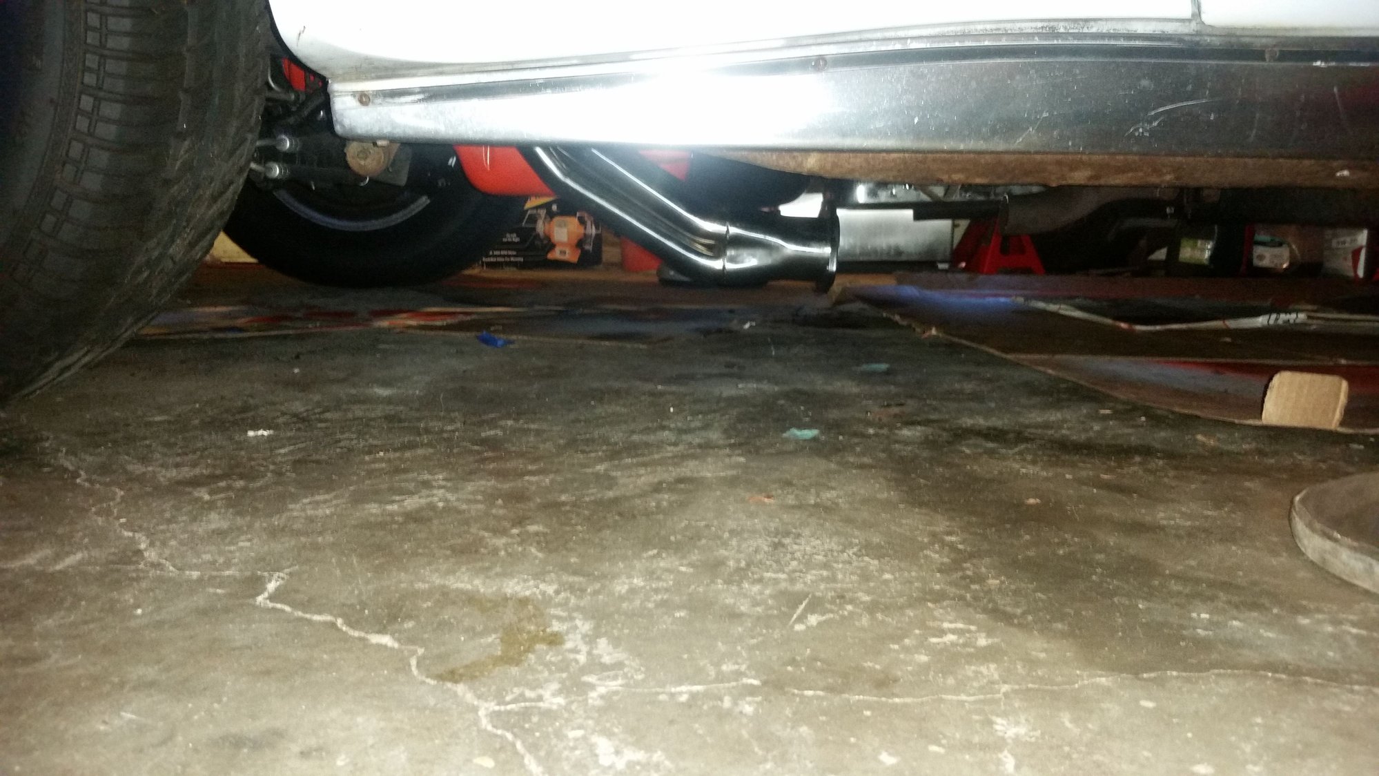

Default Header ground clearance
Well, I bought some 304 stainless headers off eBay a while back when I was beginning this project for about $140. In the engine bay there is very ltitle clearance issues, but ground clearance is only about 3 inches.
I guess that's what I get for being a cheapo.
I'm curious how much ground clearance others have with more well known systems like headman and hookers.
Is it 4-5 inches?

I don't know what my Doug Thorley headers have for clearance but those look like you will have problems.
