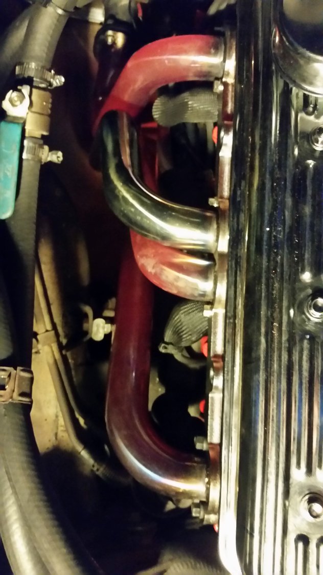

Default Driver side header during break in
Passenger side header during break in. #6 looks dead

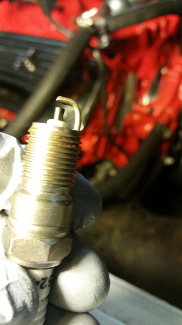

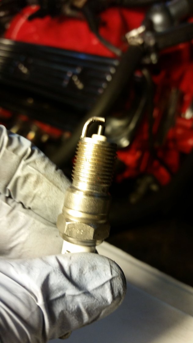

Default #3 plug
#3 plug after 25 min break-in. Looks like it was sparking to one side.

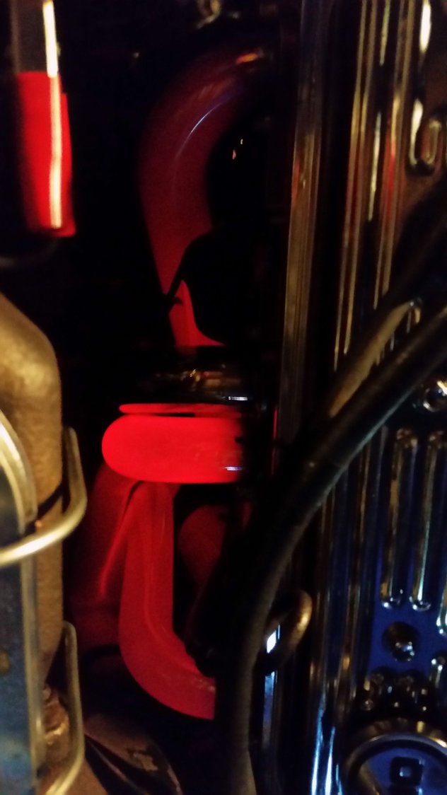

Default Drivers side header during break in
Drivers side header during break in. #3 looks dead

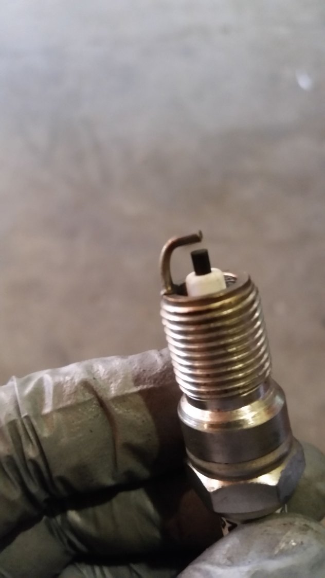

Default #1 plug after break in
Just for comparison, #1 plug after break in

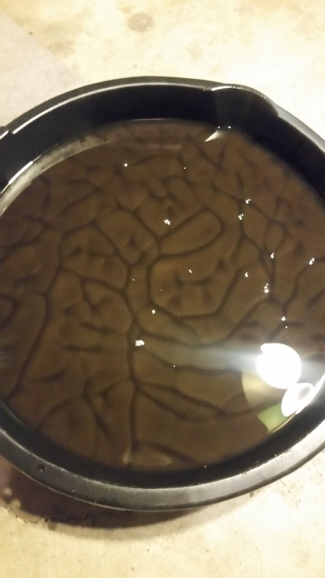

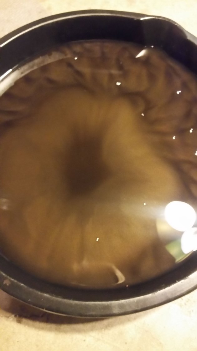

Originally Posted by mongoose87
So I did a break in procedure this weekend, but had a few problems along the way.
It turned on great and cranked right up and went immediately to 2200 rpm. There was a ticking noise that got louder and louder, until it sounded like an issue, so after about 5-7 minutes I turned it off. I know, not supposed to do that, but was hoping since it is a hydralic roller cam, there is some wiggle room.
Opened up the valve cover to find 2 off the rockers had came off their studs! Holy crap!
I used roller rockers with poly locks, and I guess I didn't tighten the Allen bolt in there tight enough. Luckily for me those pushrods weren't broken or the rocker, or the rocker stud. I'm glad I was using those crap ebay stainless headers, because they blued quite a bit.
After seeing this I adjusted the valve lash on all valves and tightened the Allens screw real tight.
When I finished about 25 minutes at 2200- 2600 rpm, I turned it off and drained the oil. Some would say this break-in procedure is overkill with it being a roller cam, but I wanted to play it safe.
When I looked at my oil, it looks different from normal. I'm not sure if I would say it's milky or not.
Could this be from the assembly lube and particles of the rings from breaking in? (I hope so)
What do you think?
After i blew at the oil
5 minutes after being drained
Haven't read your thread in detail, but looking at the pics of your old rod bearings and this picture makes me wonder if water is getting into your oil somehow...via a cracked or warped block or head, The reason being is that the ~scoring on your bearings could be due to dilution of the oil and heat/pressure causing the water to turn to vapor and decrease the lubricity of the oil film on the bearings.

those plugs look awfully white. red hot header tubes. high idle. = vacuum leak?

#6 and #3 are not burning for some reason. Look for ignition wire short circuit and double check firing order. #3 and #6 are next to each other on the cap in the firing order.
Are those the 2 cylinders the ones that lost rocker arms???
You have a 6 cylinder engine as it looks from here.
...yeah, that would be the worst case scenario. I really hope that isn't the case, and that the oil looks that way because of the white lithium assembly lube.
I had the block and heads professionally magnafluxed, but I guess there is always a chance they missed something, or that this happened when the 2 rockers became loose.
I really hope not, especially since the temperature gauge never went above 180-190. I also checked the water level in the radiator after the break in, and it looked all the way full. I couldn't put any more water in.
I'm going to put the oil into a milk jug and see how it separates; if it is water there should be some clear separation if left to settle and hopefully it will be an indicator.
What would cause an ignition wire to short circuit?
The rockers came loose on #6 and #4, I can't remember now if it was exhaust or intake valve on each. So maybe it caused something on #6, but it stil doesn't explain what happened on #3.
I want to believe that didn't cause the cloudy oil or dead cylinder issue, but I'm obviously being optimistic.
I fired it up again last night, after changing the plugs (Delco R44LTS gapped at 0.045) on #3 & #6, verifying the firing order, and making sure I didnt get mixed up with the wires. It still seems to be not firing in those cylinders. I was hoping it was something simple...
I put the timing light on the wires going to cylinders 6 & 3, and both made the light flash, although this was connecting the timing light probe pretty close to the distributor. Since it was running at this point, I didnt remove the plug and check for visual spark against the block. It could be that somehow the ignition wire has a break closer to the plug, but it seems like a low possibility. The wires don't look burned or damaged.
The more I think about it and look at the first plugs I put in, the plugs look like they are trying to fire. Right?
Would closing the gap to 0.035 help?
If I can't figure it out I'll swap wires with another cylinder to hopefully rule that out.
I'll disconnect all other ignition wires other than #3 and #6 and check for visual spark tonight.

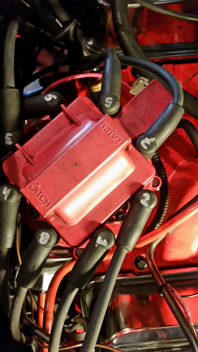

Just so I'm not crazy, firing order below.

Are you sure you are not 180 Deg out..It will run like that but not good. The back firing issue is a sure sign of being 180 out. By the looks of how you have the dizzy stabbed in the picture doesn't seem to be in the right location. I know you can make No 1 plug fire anywhere on the dizzy, but why not set it up like it should be.

Its not always the wires getting mixed up. Looking at your cap #3 and #6 criss cross over each other. Not much you can do about that...maybe reposition? Not saying that's the issue but hey, you never know.

Valve lash too tight? Pop out intake and exhaust. Need a compression check.
Distributor looks like it is clocked funny to me. Not saying it will not run there where it is but I would re-clock it to be more like it was originally.

As long as you are going to do a piston stop test, and re-clock all the wires, I would also check the wires with an Ohm-meter. They can break internally and not fire well and you would never know by looking at them. Much better than looking for sparking in the dark. Could be #3 & #6 are broken.
But I also agree the distrib could be 180 degrees out.

If your distributor is 180 off you would be firing #6 when #1 is at tdc.
That could be why you are getting the backfire through the carb.
Once you get #1 tdc on the "compression stroke and not the exhaust stroke", pull the cap and verify the rotor is at the #1 position.
