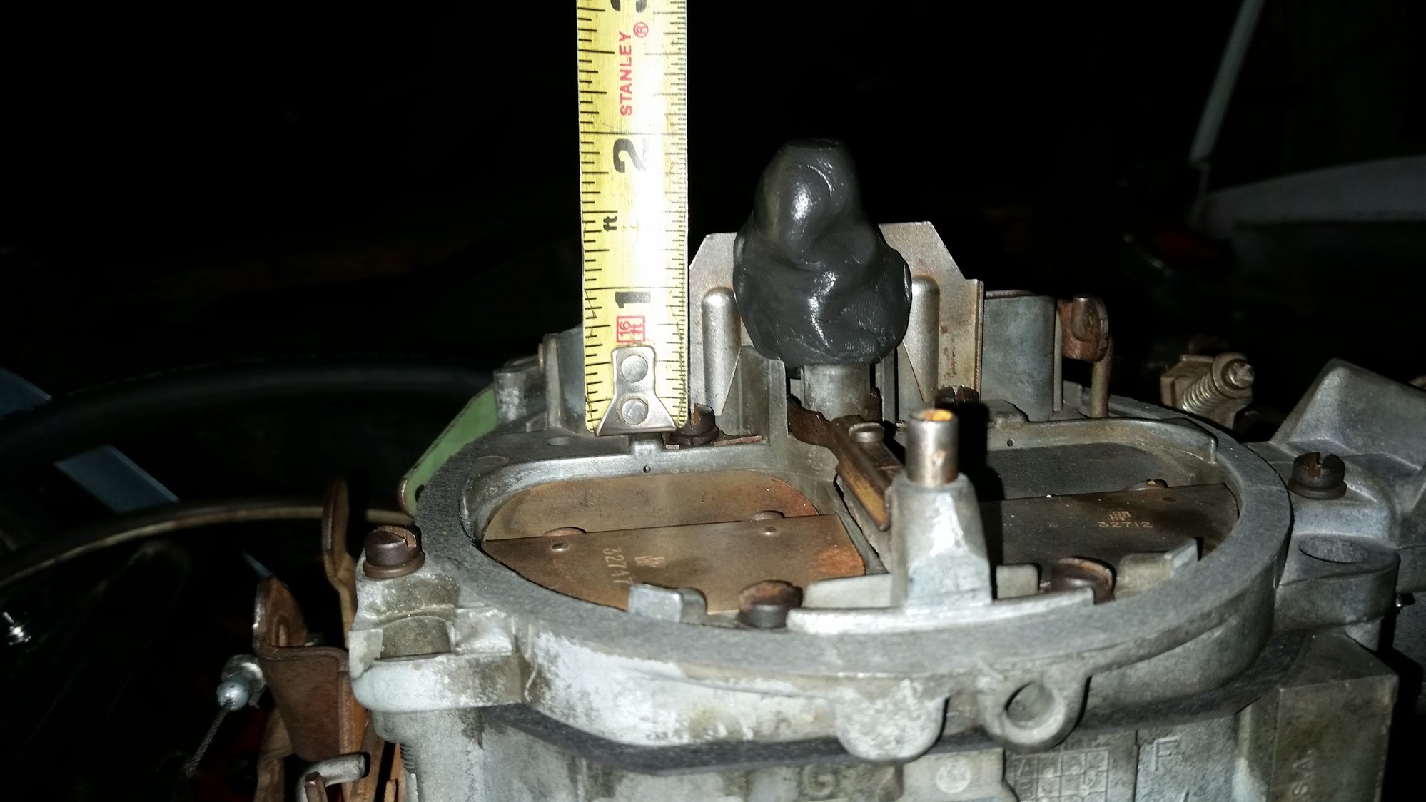

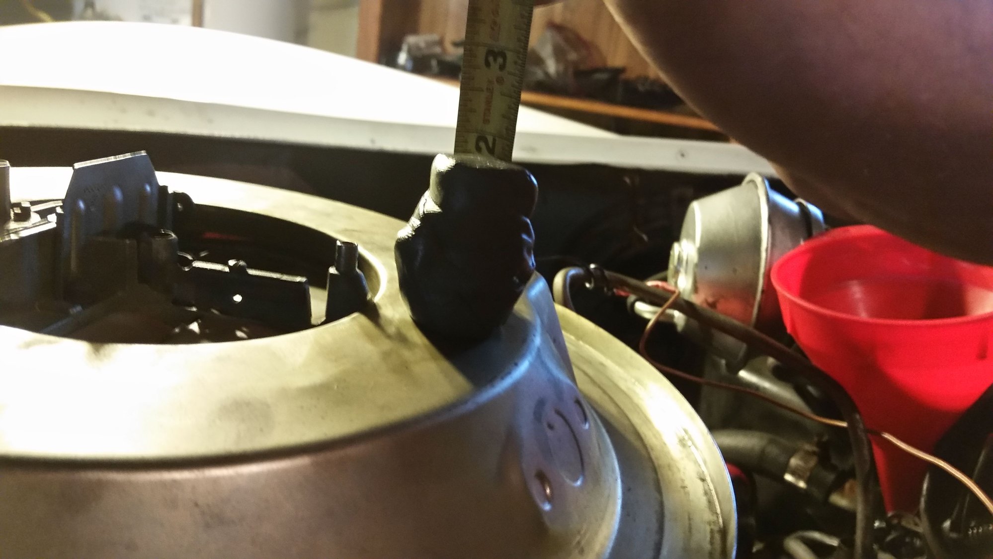

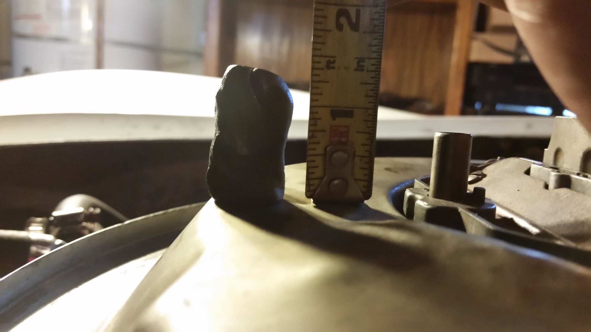

I have almost everything assembled for the first fire up, so I tested the clearance on the air cleaner to the hood.
Just a reminder, I do have a 1972, so it has the lower hood than later years.
There is definitely clearance issues.
Despite reading about others using the performer intake with just a drop base air cleaner, it didn't work for me.
I have a 1.35 inch drop base air cleaner with 3" filter, but had pretty obvious issues.
When i remove the air cleaner, the quadrajet carb stud still doesn't allow the hood to be closed.
If i remove the carb stud the hood can be closed.
Ugh.
I'll try a 2" filter to see if that helps, but if the carb stud is still contacting, seems like i need a new lid too and shorten the stud a bit. Seems like a 2" filter and lower lid would choke the engine down a bit. I saw that engine masters when they tested all the different filter options; even the drop base looses power with a 3" filter...damn.
Has anyone run one of these carb hat things?
https://www.uniqueautodepot.com/Spec...q4ZRoCwbjw_wcB
My windshield sprayer doesn't currently work, so maybe I could remove the wiper fluid bottle and pipe this to over there near the side vents. Maybe even make a shield to better pull the air from outside. Seems like that could be an improvement while sitting in traffic anyway compared to the open filter element.

Are you running a spacer between the carb and manifold?
Send us some photos with and without your air cleaner.
No carb spacer other than the paper one between the carb and intake.
Here are some pics

If you can't afford a new high rise hood you could always cut yours and install a scoop when you see fit. But really cold air is much better for performance than using air from the engine compartment. You will leave a bunch of HP on the table using engine compartment air. Every late model muscle car can be found with hood vents for a reason. And the right scoop makes that old stingray look menacing. I kinda like the C5 hood that has a bulge that tapers down on all sides. Give it a killer whale look. Looks extremely good on a C5 for some reason.
Or even a small cut to clearance that carb bolt can always be repaired later. Hey it's only fiberglass. Cut a small hole and put one of those tiny snorkel scoops dragsters use to vent the fuel system. You'll have someone ask you about it every time you gas up.

Well, I ordered a k&n 2.5" filter element, and it looks like that solved the hood clearance problem. phew!

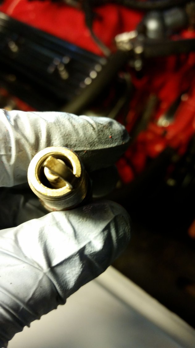

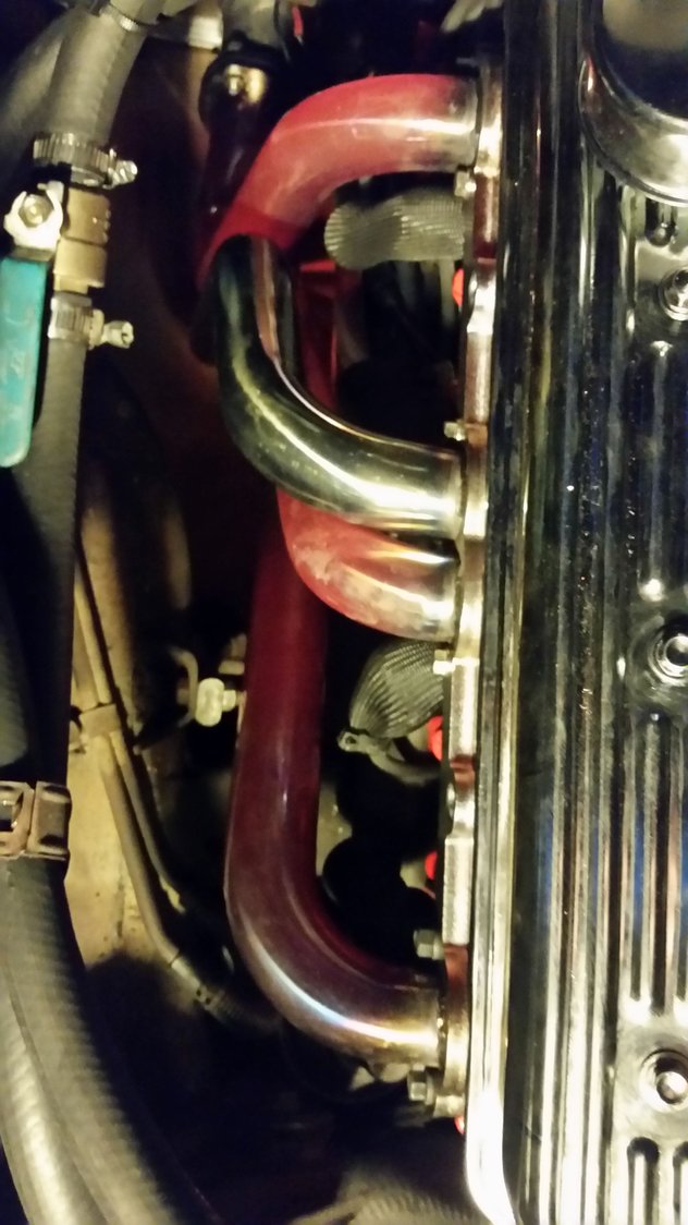

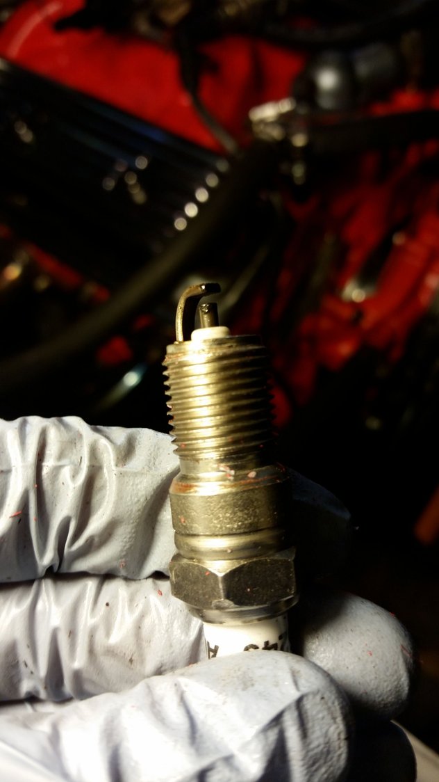

I noticed another thing during break-in.
The headers got really hot, and glowed red, but not on all cylinders. I should have moved the timing light over to the plug wire for cylinder #6 to verify it was getting spark, but I was stupid and didn't do that.
There was another cylinder on the drivers side that also didn't glow red.
They glowed red especially when I was setting the timing. With the heads being vortecs, I wanted about 30-32 degrees at 2800 rpm without vacuum advance, and targeted 44 degrees with vacuum advance. (Does this sound about right?)
Once I got it set and vacuum advance connected, they still glowed red quite a bit.
Before I did the break in procedure, I did go from a size 40 primary rod with 72 jet size, to a larger jet, at 76. I was hoping this would largely take care of any super lean conditions that could cause this.
Since the crappy headers from eBay were on the engine for break-in, I figured it would be best to allow for the full 20-25 minutes rather than stop.
I just ran straight water during break-in, and thought it would be good to do one last flush before adding coolant. I didn't see any overheating on the gauge, with the sender on the head. It probably got to about 190 degrees.

Did you use white lithium grease as an assembly lube?
Red pipes often means retarded ignition timing ...
... Are you using a damper with a scale of timing marks?....
... or a dial-back timing light?

Water in the oil. Not good.
Cold pipes could be cylinder not firing.
Not that I have much experience with them, but I believe poly locks work better with a locking technique It is not just tighten down the set screw. The lash is adjusted where it needs to be first and then the nut is backed off a partial turn then the set screw and nut are both tightened together at the same time back to the original set point. Probably a U-Tube video out there for it. If you just tighten the set screw by itself, it can back off.
I did use white lithium assembly lube. I've read a bit about some people noticing some weird things with the oil when white lithium assembly lube is used, but haven't seen any pictures from others. I've also never seen first hand the oil when water gets into it, but I hope the assembly lube is what I am seeing. I replaced the oil last night, so I'll probably fire it up again and see that "fixes" anything.
Red pipes...
I would have thought with about 30 degrees mechanical advance I wouldnt be having this problem.
I am using a damper with timing scale on it and a basic timing light, but I'll get the piston stop tool out again tonight and see if it is off.
The car still needs to go to the exhaust shop to make the exhaust system, so it is just running straight out the header to muffler. I tried to richen it up from 72 to 76 size jets, but could the red pipes be from a really lean condition?
Does anyone have any similar experience with re-jetting and how many sizes they had to go up?

I'll fire it up tonight to see if those wires are getting spark by connecting the timing light to those wires.
Not sure why else these would not be firing.
Old Jun 17, 2019 | 02:06 PM
  #159
stingr69's Avatar
stingr69
Joined: Mar 2004
Posts: 7,502
Likes: 1,510
From: Little Rock AR
Originally Posted by mongoose87
Thanks for the tip on poly locks.
Pull the plugs. You will likely see the issue.

Default #6 plug
#6 plug after 25 minute break-in.
Looks like a bit of oil is on the tip. I can't tell
