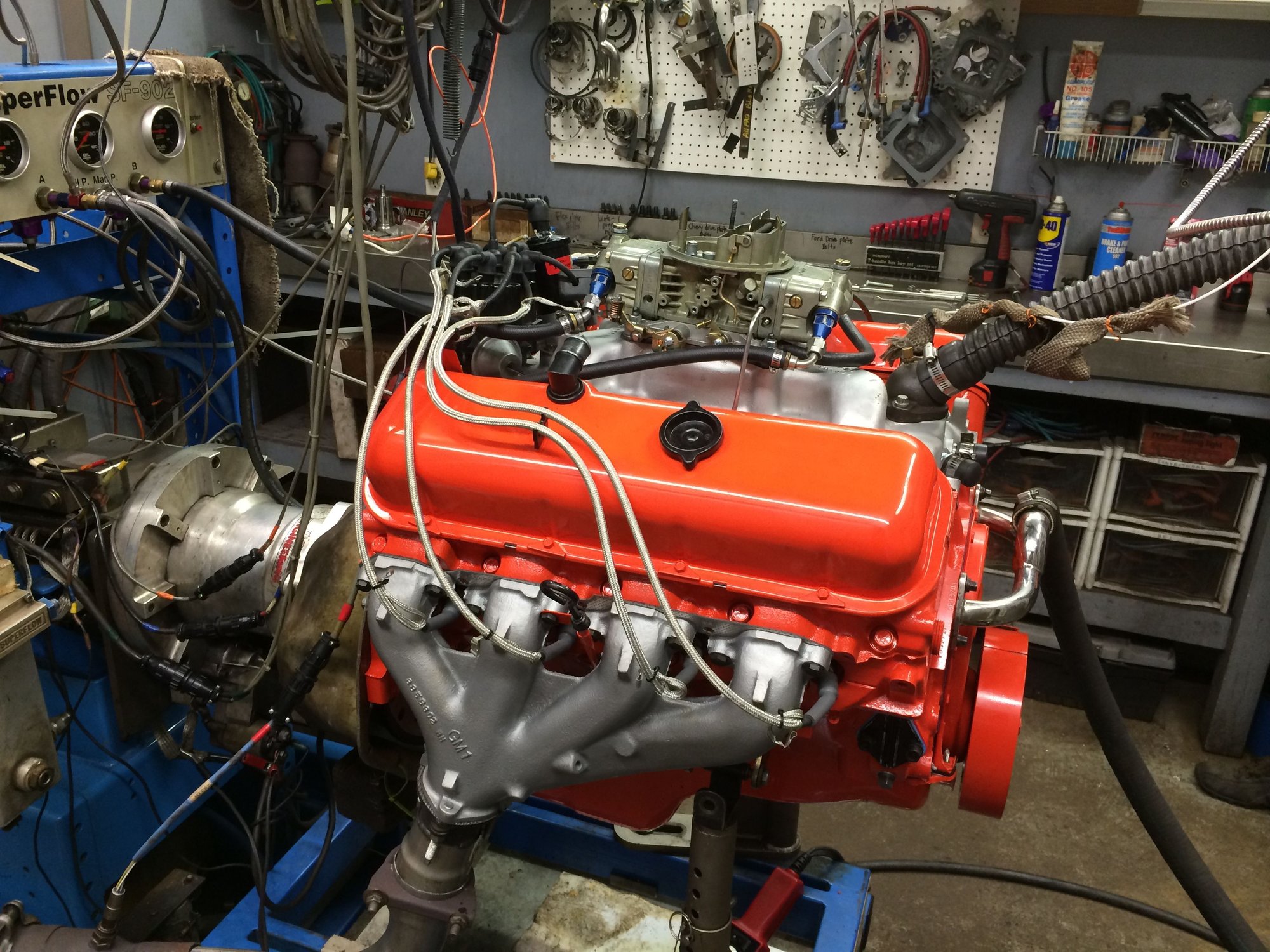

Ok ready for Dyno Test next Saturday!
In the meantime I thought I would detail my engine build costs for you here if anyone is interested.
I probably could have had a 454 rebuilt for about $3500 or so, if I handed him a complete engine to start.
But I did not, I had to buy everything from the air cleaner down to the oil pan, as I started with nothing.
And I wanted an authentic 4 bolt main, steel crank, aluminum snowflake head, forged crank/pistons,4803 Holley LS6, or as close as I could get, and all blueprinted..
So I had to buy a LOT of parts.
Here's the results
$2,100 in machine shop work
$9,600 in parts
$11,700 Total
Detail is attached in case you are building or rebuilding a BB and want to do some estimating.

Damn!! That’s pricey... but good stuff is expensive these days. Hell I spent $5600 refreshening my 496 and that was keeping the same rotating assembly and heads...even the same pistons when back in it. Majority of it was valvetrain and head work...but the little stuff will nickle and dime you to death.
Good luck on the dyno!! Playing on the dyno is fun and nerve racking. Gotta get that power out of it though!

Thanks! Yeah it was a bit more than I expected, 'cause I had no way to estimate all the little extras. And last time I rebuilt an engine was like 1980 and it cost me less than $2000. But that was a SBC and I did drop off a complete LT-1. Different story these days!
I saw a couple of those original 435s dyno around 450-460. My dyno shop has an all original early '65 L78 vette that dyno' at 485. And he swears it is 100% original. But he does also own a cylinder head porting shop, just sayin' , so I wonder....

I have every part and component to complete my 496 sitting on a shelf in my garage except for seals, gaskets and the timing chain.
I read this and thought, I wonder what I have sitting there in parts and added up the receipts.
I think you got off pretty cheap so far.

My 496 new from VortecPro was $7800 shipped when I bought it 10 years ago which I thought was a great value. So 9 years and 27k miles later to refreshen it, was $5600... using 90% of the same parts. I was like “damn, I should just buy another new one for $2200 more”....lol
Once he sent me the parts/labor break down pricing, it all jived...and nothing excessive. We just spent a lot of money on the solid roller valve train this time... I spent $3k in parts, $2500 in labor..... good parts aren’t cheap, especially valve train stuff. We gained an honest 25hp on the rebuild and gained a lot of rev ceiling. Plus the sound....🤤
You mention the 65’ L78, we built one of those as well about 4-5 years ago. It was a “date code correct” type build, but we wanted a good driver so we lowered the compression to about 9.8-1, put a Straub hyd roller valve train in it etc. Stock heads, stock intake, stock exhaust manifolds. It made 441hp through stock exhaust manifolds and a 650 carb...(this was by mistake). I was hoping for more but... I figure with headers and a 750 carb it would have made 475hp or so.
Thats what I really want to compare this new 427 we are building too.
My dad also has another 67’ 435hp car that is built to 100% oem spec’s, and that thing sounds completely different from the 65’. It has a LOT more pop/crisp.. the 11.0-1 compression is very noticeable in it... I haven’t driven that one yet to see how it feels compared to the 65’ L78 but....just by the sound/throttle response, I’d say it’s gonna be considerably stronger.
