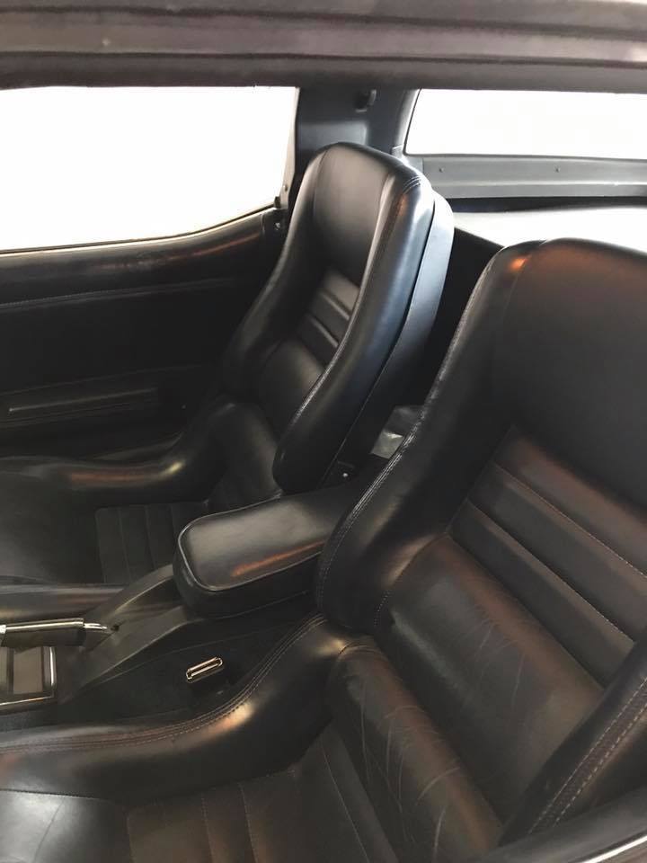

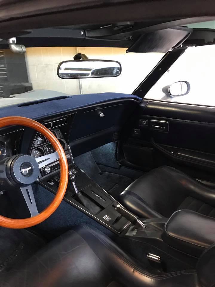

There aren't a lot of pics - all the exterior is going to show you is a primered albeit straight 'Vette. The undercarriage which I don't have any pics of is really the most impressive view currently, it's very clean.
Here's a few that show the engine bay and interior. There's also a front-facing scoop-type air intake, whatever the official name for those are.
