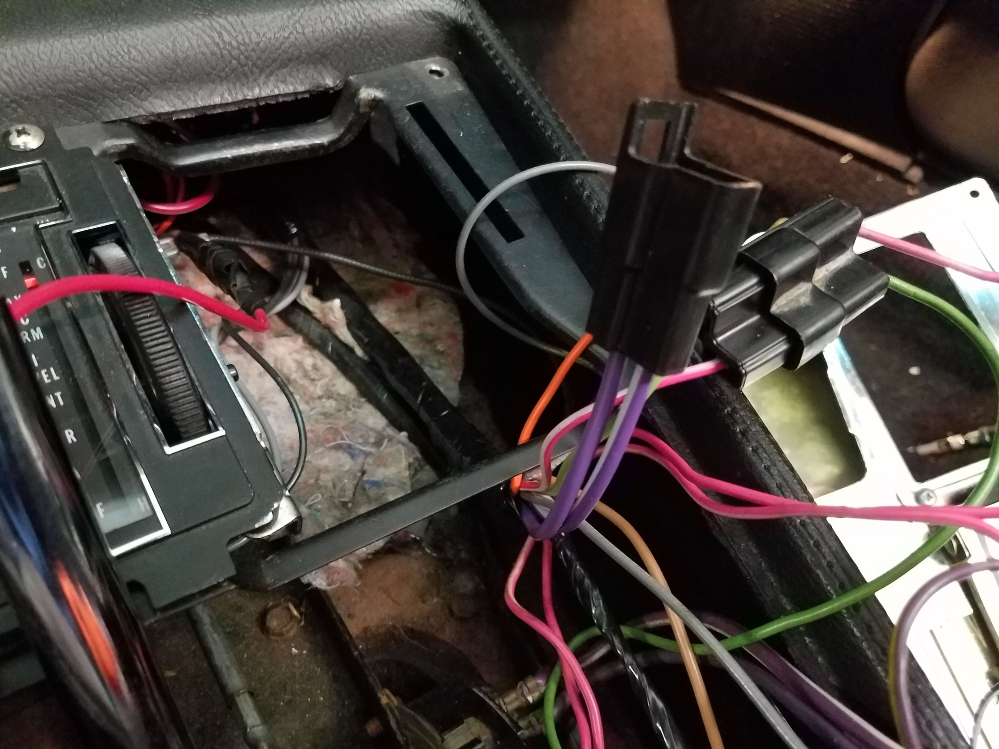

Peterbuilt - Yes followed Jims procedure on adjustment. Could not find a clutch pedal pig tail for purple wire under dash - Could be when the PO bought the new harness he got it for an automatic trans which I have. So I took the console apart to get at the wires. Here is what I have
1. On harness side from dash - Green /Orange - Pink with white stripe has 12 volts with key on. This is the back up light. Note: back up lights did work before, but now do not work?
2. On harness side from dash - purple and purple/white - No voltage with key on. This should be Neutral safety switch

That red wire with the tape on it is a temp ground wire coming from key switch to make sure the harness is grounded at that terminal on temp controller. When removed same results so that's not the issue. Also cig light works and cig lighter gets hot when pushed in.

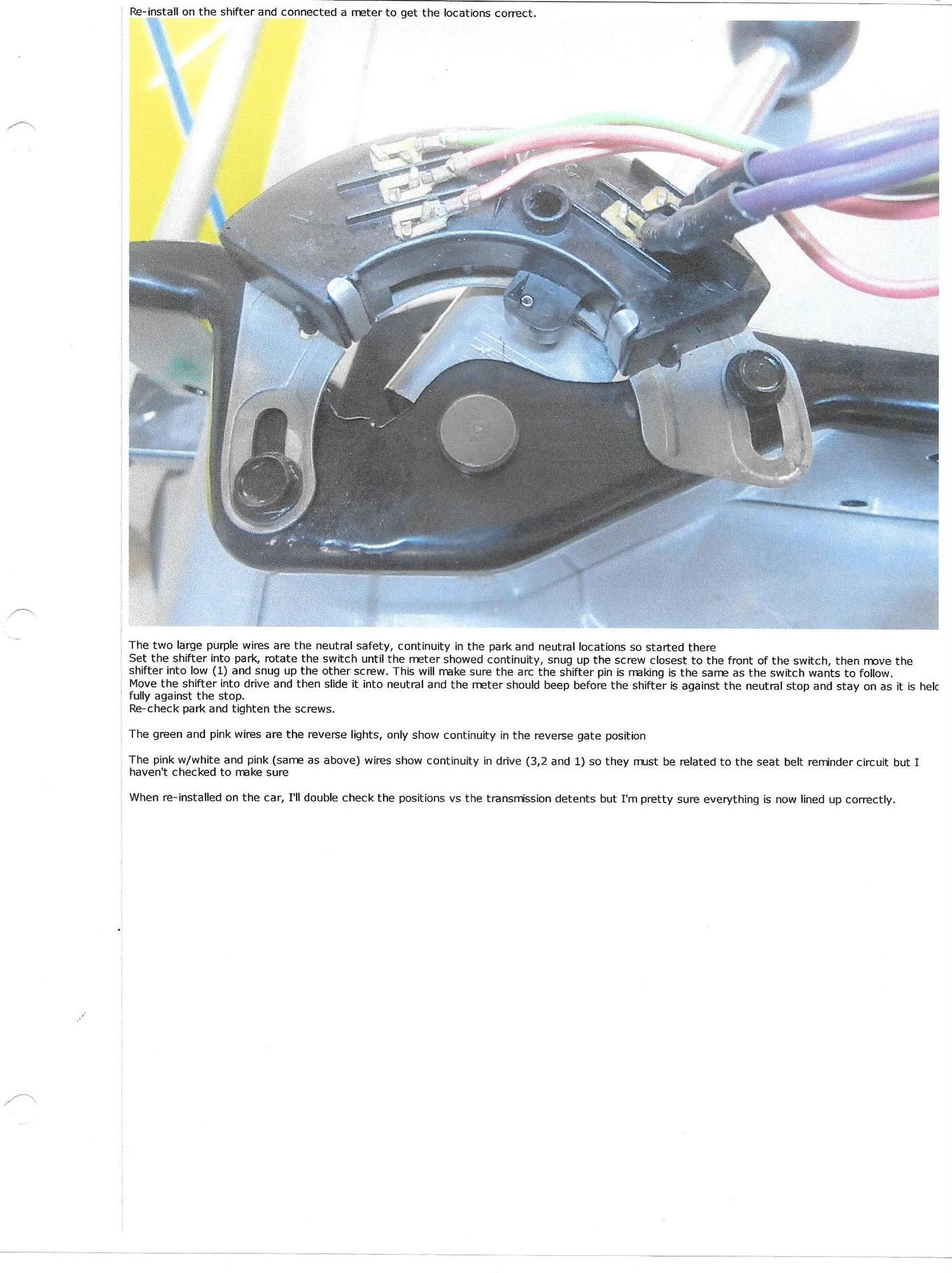

Peterbuilt - What kind of writing is that on the first picture. Cursive who writes in cursive anymore? Thought you might get a laugh.
