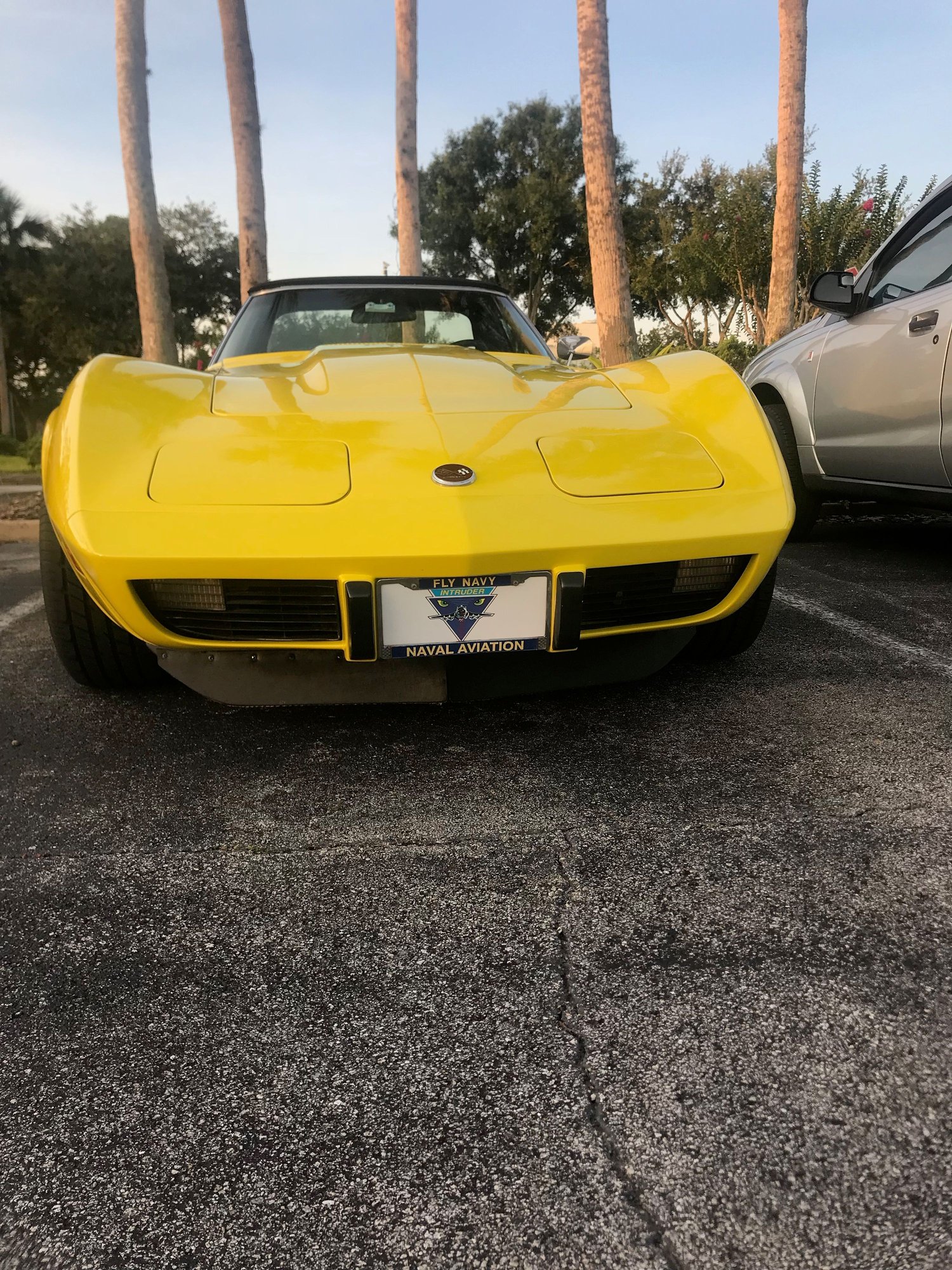

Here’s what I put on my car since the diffuser was completely missing. I got the stock chin spoiler plus the L88 extension.

Stock 1975 spoiler with the 1979 only L-82 extension. Works great to keep my 496 cool.
