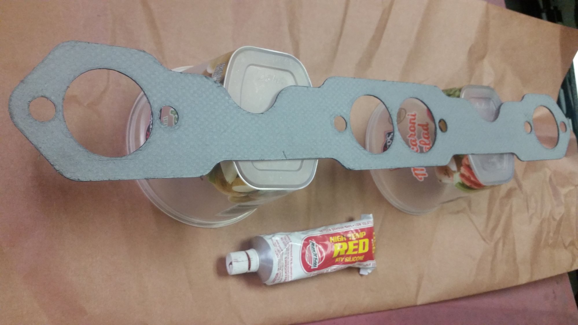

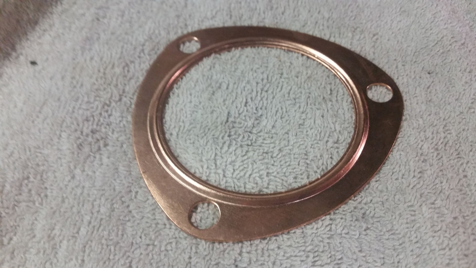

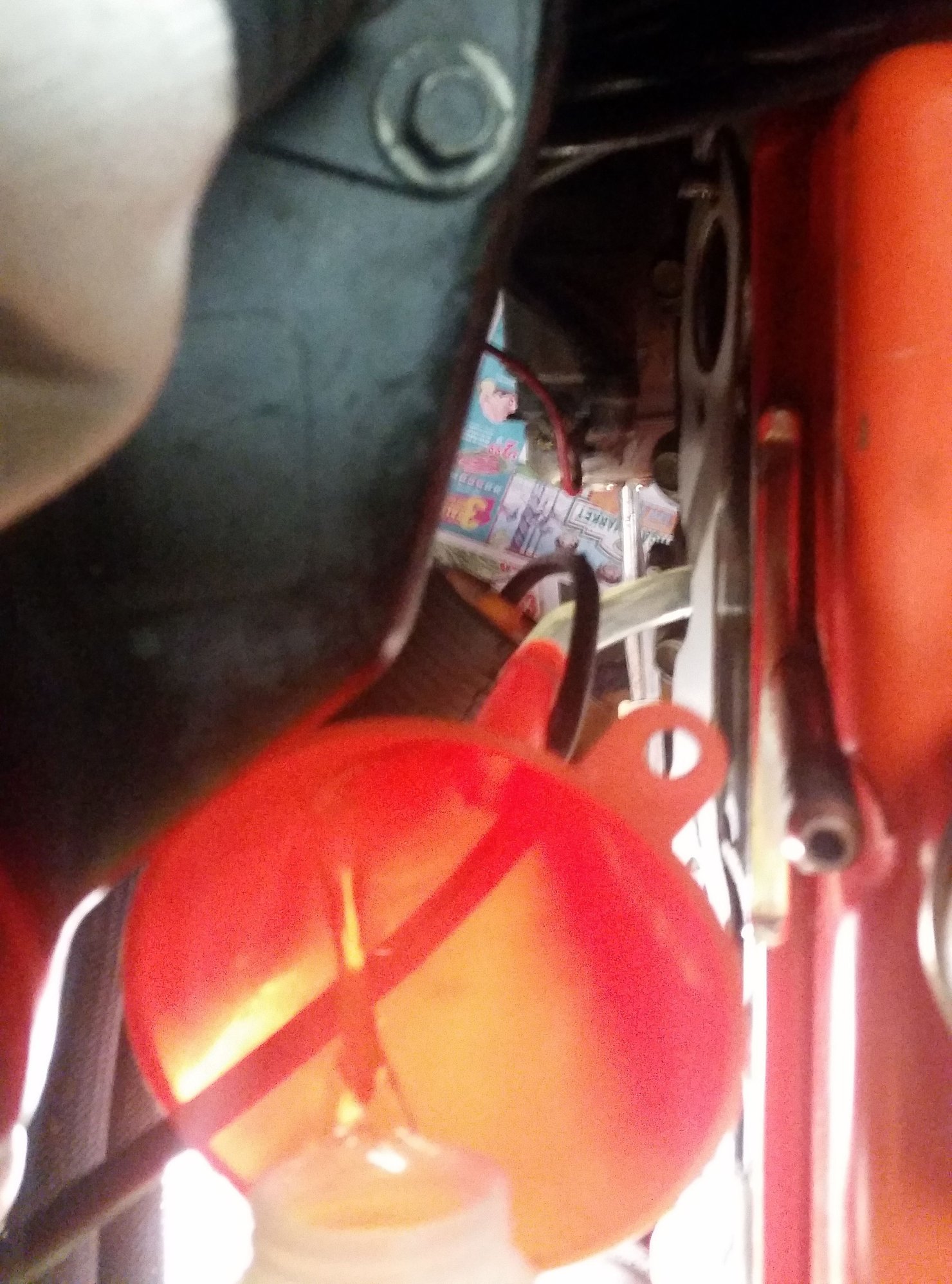

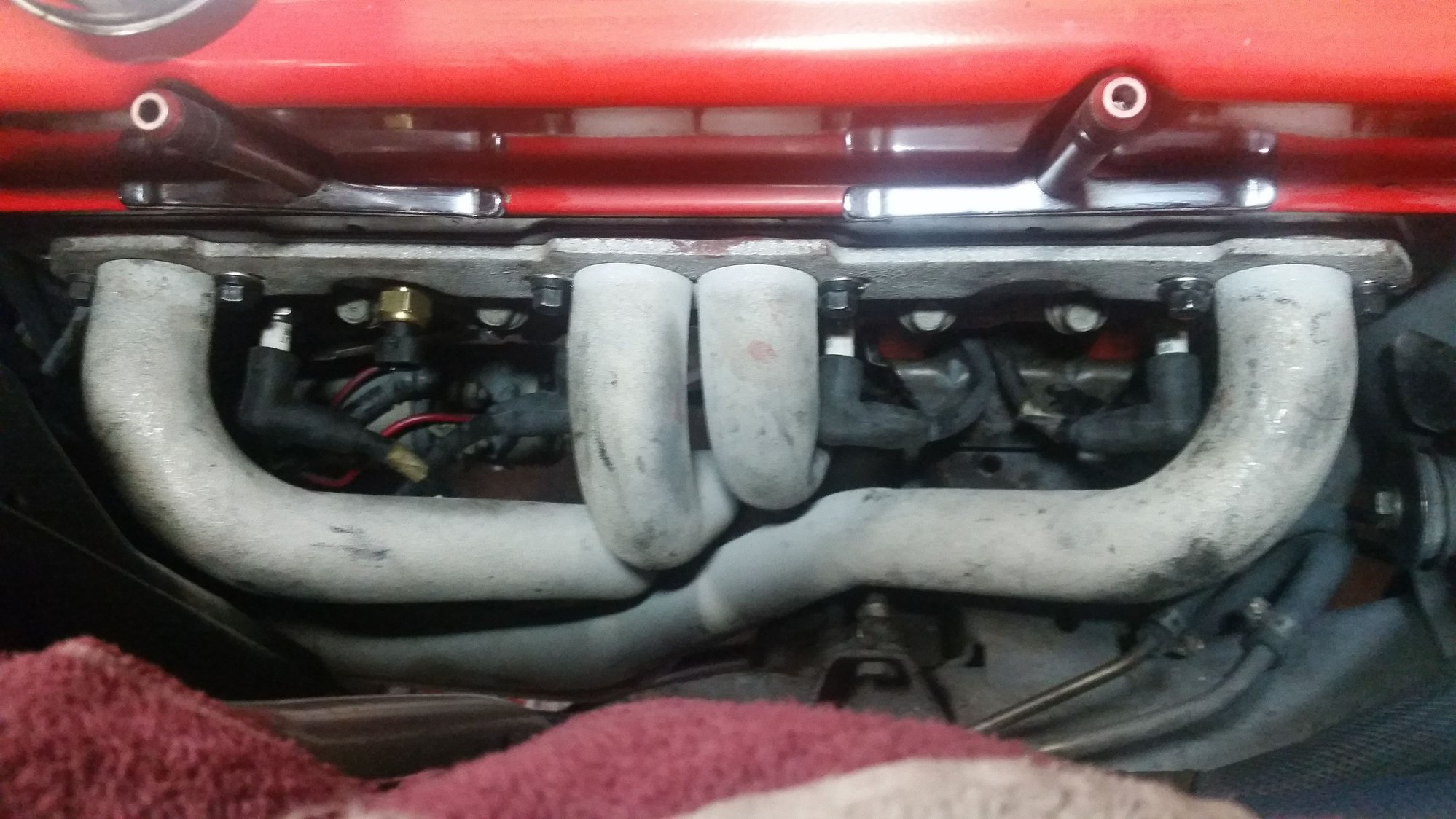

HEY! All assembled, wheel on, jackstands removed, back on the ground.
Filled.
Header attached.
Solid copper Collector Gasket used.
Spark Plugs and Temp Sensor installed last.
No leaking yet, but of course the real test will be heat and 16 psi. Will hook up the Negative Cable to the Battery tomorrow, take it for a drive, and see.
This thread could be done.
Steve

Well, it appears this leak is fixed, as the Freeze Plug is holding great after 2 days of driving.
The thread started out as WHAT was leaking, and I was glad it wasn't the Cylinder Head.
Then it went to how to replace a Freeze Plug that was directly under an engine mount.
Got lotz of good help and suggestions along the way, of which I am truly grateful.
Thanks much.
