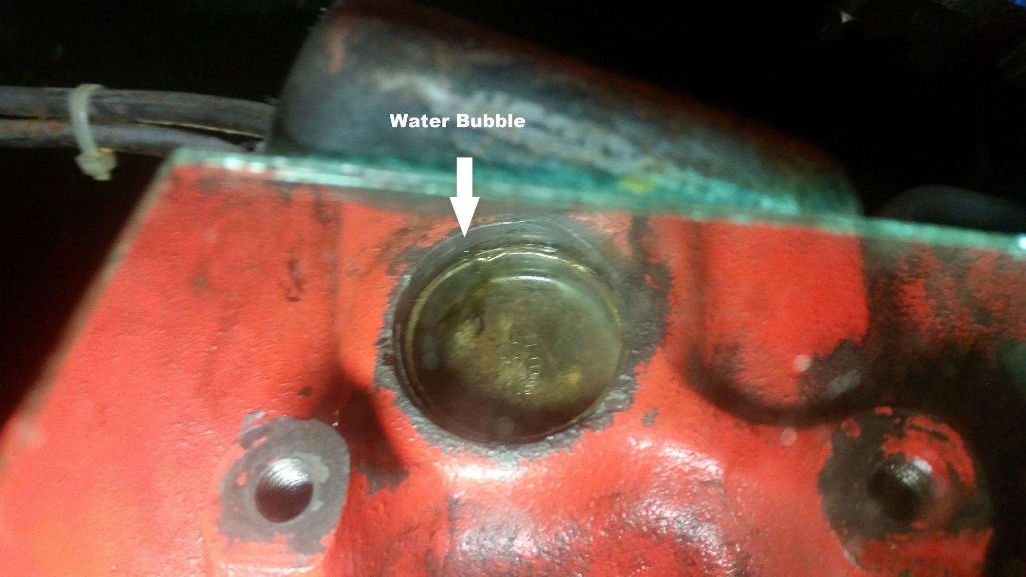

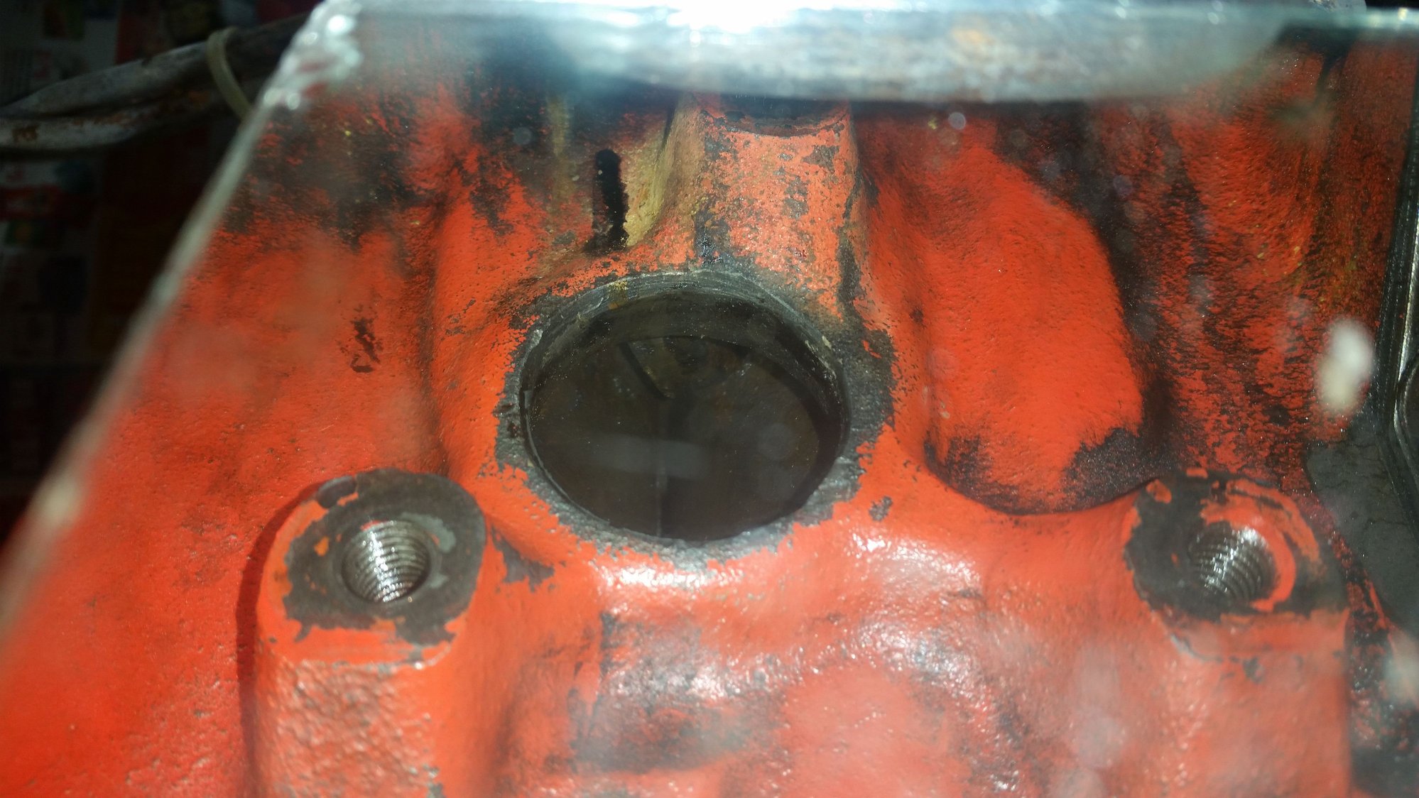

Thought I might try working from the top of the engine.
Set up a mirror to see the leaker.
Add coolant through the Temp Sensor hole.
Didn't leak at first, dammit. But after a half hour, got a bubble starting to show.
The case integrity where I thought the crack might be was cleaned off and looks alright.
And the inside edge where I thought the crack went across looks good too.
But the main point here, I feel anyway, is the plug is just too far driven in. It's a tough perspective we get looking up AND to the side when driving this plug in on our back. Hard to get started into it's hole and everything.

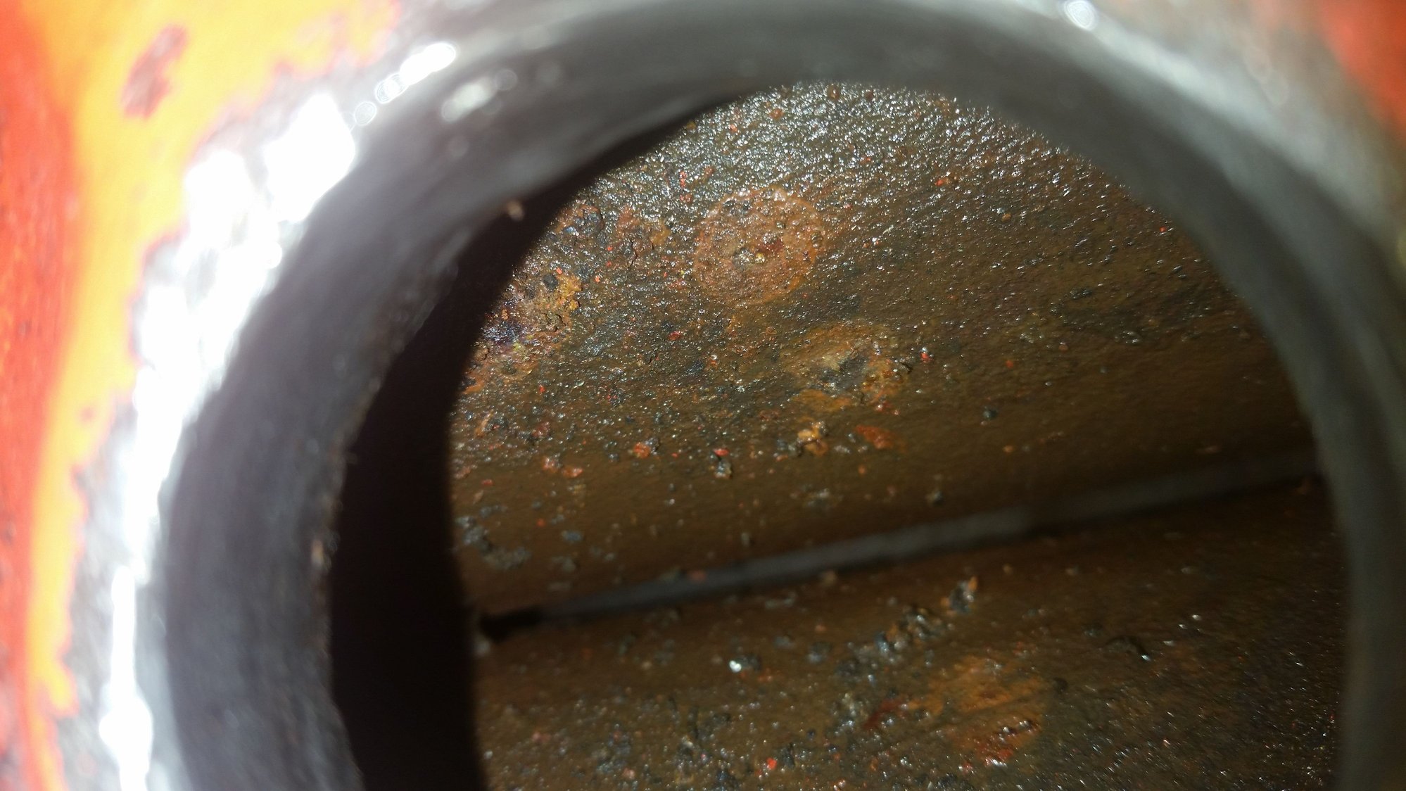

Cleaned up the hole with acetone, got out the borescope, and here's what it saw.
Not cracked, but gouged bad from the drift when the plug was knocked out the first time. Pretty damn sure that's the leaker cause.
Anyone think I should de-bur it, maybe with a Dremmel sanding drum, before plug installation?
Permatex 22071 "Out for Delivery" today.
Steve

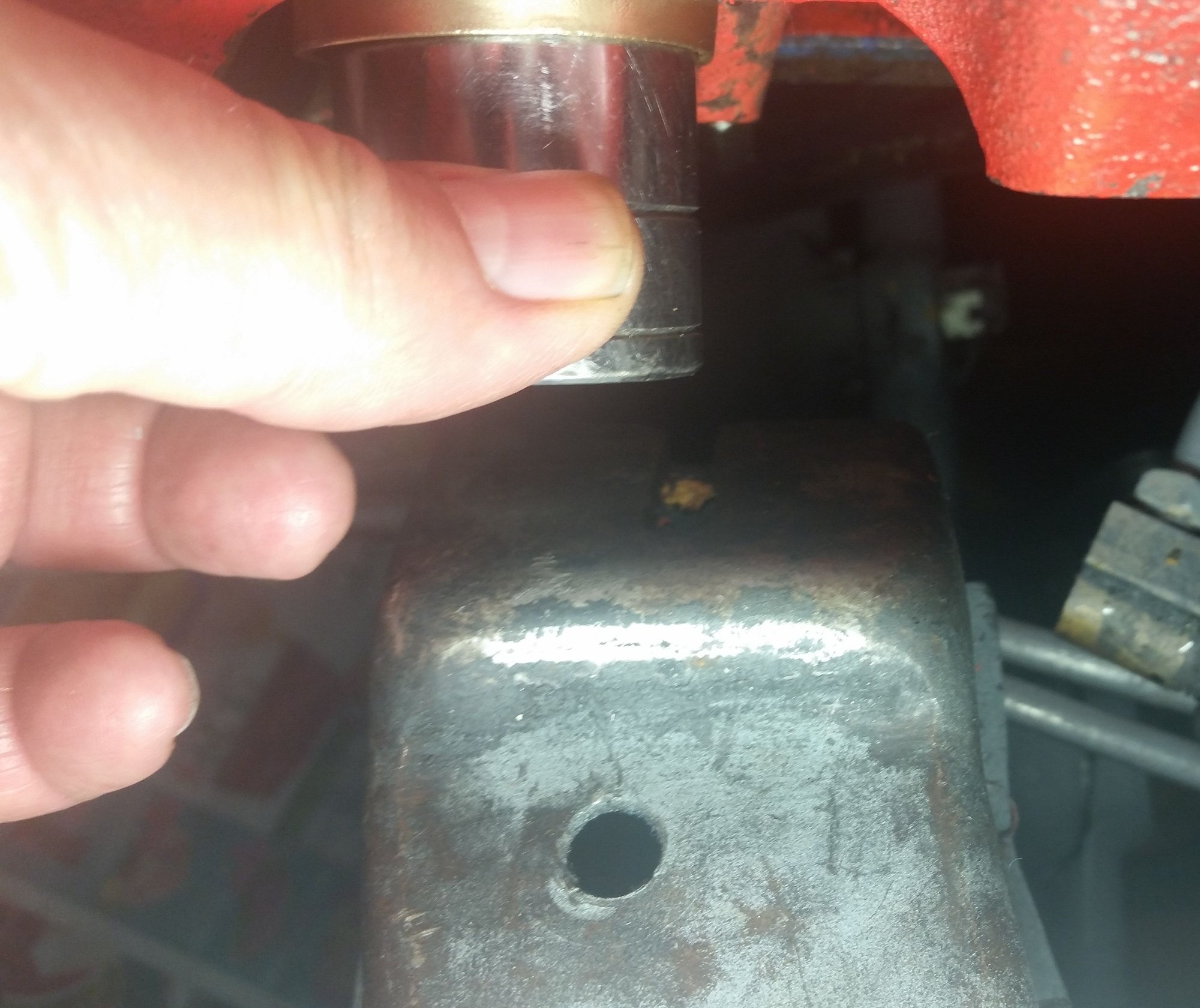

Default What a Bitch!
So little room to drive.
I'll figure somethin' out.
Steve

Oh yeah. Just positioning it up there to show what a pain it is to drive it in.
Going with this product.
The motor is raised about as far as it can, as currently configured, with the Radiator Fan Blades just starting to touch it's Shroud Extension and the Distributor is like a half inch away from the Windshield Wiper Motor housing. Plus there's probably enough stress on that left Exhaust Header plumbing that I want to put on it.
