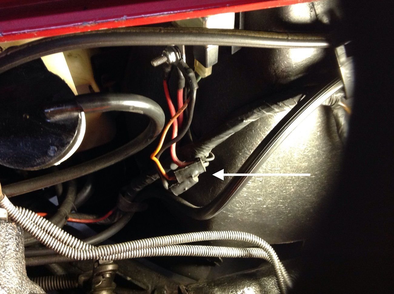

Could you describe what the fusible link looks like?

Do you have a picture of the fusible link?

Heres a picture posted not long ago by Tooch1:

Heres what I found.i will go to Napa today.

Thanks for all your help. The wire from the starter to the fusible link was fried.
