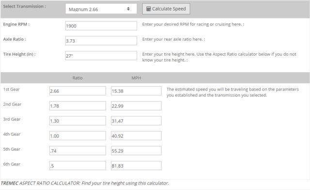

Thank you all for the feedback thus far, I truly appreciate it. I should have included the cam specs when I was making my original post
Xtreme Energy XR276HR Hydraulic Roller Camshaft & Lifter Kit
Lift: .502''/.510''
Duration: 276°/282°
Lobe Separation Angle: 110°
RPM Range: 1900-5600
Also, I totally forgot to mention that I am running an 18lb flywheel so my concern is that the tall gearing which is stock might cause bogging off the line. Also since the cam is happy 1900+ I was figuring on 75mph near there. I don't know why I completely blanked out about the online gearing calcs so thanks for the suggestion. I am off to play with those for a bit and see what I can find that will work for me.
**EDIT**
Some really interesting stuff here, thanks again to all who suggested the online gearing calculator.
So, given that I have absolutely no need to be doing 100mph at 1900rpms, the 3.08 is out
Going shorter down the list, even the 4.1's barely put me into the cams operating range @ 75mph so it looks like that will be the way that I go.
