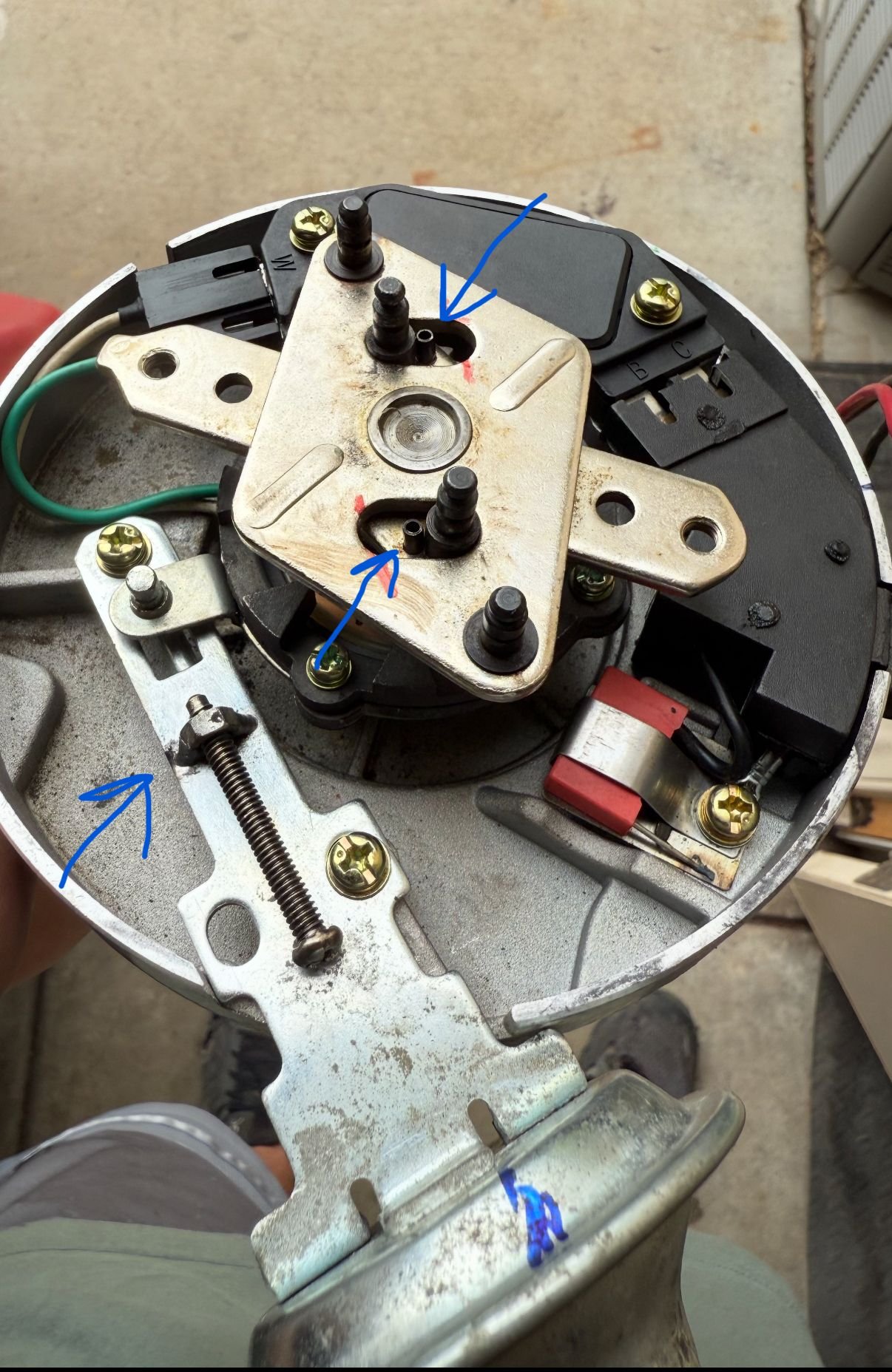

Yes, I started to dismantle the dizzy weights/springs and planned to both weld and change bushings on both your and @lars recommendations.
But it seems as previous owner already been there with a weld. If I limit it even more it will be more or less stiff 😏
Added pic below on current setup.
Thanks!
The brass/bronze advance limiter bushing, as shown in the photo, should be replaced with a plastic one as this will cause the advance plate to bounce around.
