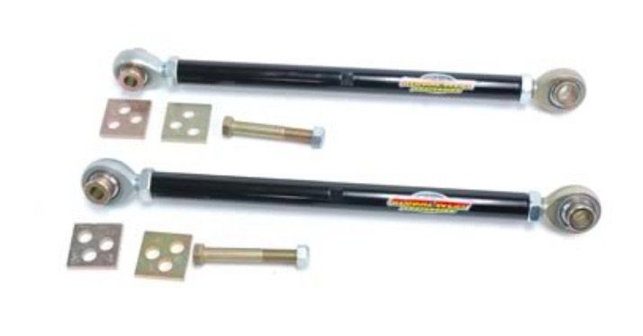

One additional thought on the twisting motion inherent in the C2-C3 trailing arms. The arms twist + - about 5°, because of the strut rod configuration used on these cars. The result is trailing arms twist as they go up and down. The C3 actually has less camber change than the C2, but both twist the trailing arm as they move in an arc. If you switch to a Smart Strut setup the trailing arm camber change is about 1° as it moves up and down. By the way, the strut rod pickup point on the rear spindles also moves in an arc causing the strut rods to twist.
I installed poly bushings in my '73 back in the 90's when I was autrocrossing it. I also installed a Smart Strut setup I purchased from Dick Guldstrand back then. It used Heim jointed strut rods like Global West currently sells. The back of the car always stays planted when autocrossing as aggressively as the car will handle. Poly's are still in there and doing just fine... so far.
Of course the ultimate solution would be Heim's in both locations.
Good luck... GUSTO
