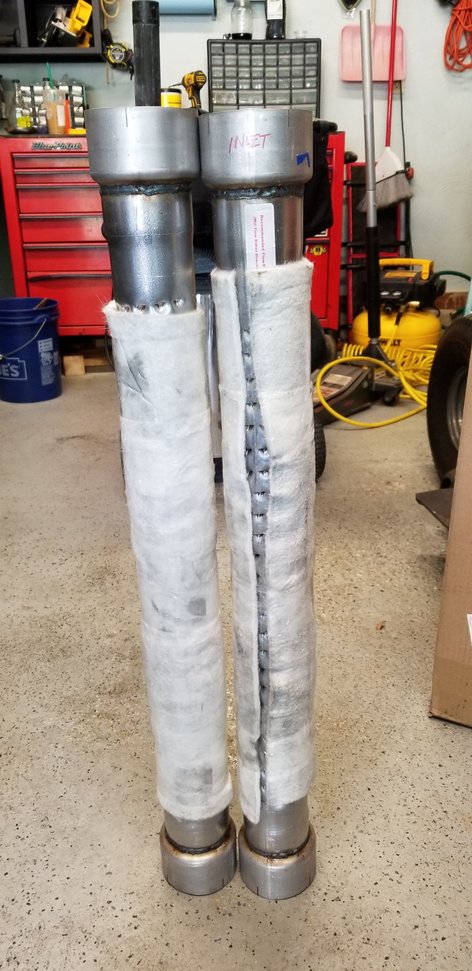

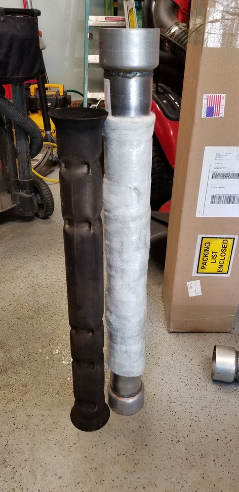

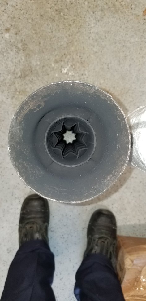

Alright, so after about a month of waiting, my new inserts finally came in. As a refresher I got the Classic Chambered louvered inserts with 3" cores. They are louvered with a fiberglass mat wrap.
First impression:
Excellent build quality. These inserts are lighter than the sweet thunders and look really nice. Although lighter, they are larger and fit better. The larger cylindrical ends vs the cone shaped ends on the Sweet Thunders help create a snug fit in the pipe, as does the notches in the ends to allow for tweaking the diameter.
Design:

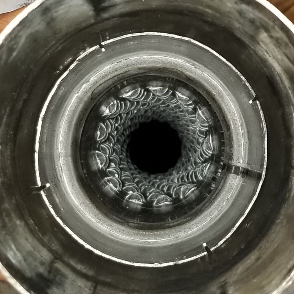

The cores are louvered, as are the sweet thunders, but the two are nothing alike. The sweet thunder has very large louvers and less of them, while the Classic Chambered have much smaller louvers, with many more of them in a spiral pattern. In addition they are wrapped in fiberglass exhaust packing to take the edge of a little. The 3" cores are impressive and look like they will really flow.
Sound:
AWESOME!! These inserts are exactly what I was looking for. I'm very relieved because although I did my research it was all sort of a shot in the dark. Believe it or not the Classic Chambered with the 3" core is actually quieter than the Sweet Thunders with 2.25". However, I would think as the fiberglass breaks in a little it will get a little louder.
Although they are quieter, they are still loud when you get on it, and the sound overall is just SO much better. The best way I can describe it is it's just a more organized, deeper, bassier exhaust note. It sounds like the exhaust tone was purposely tuned to sound the way it does, whereas the Sweet thunder was just kind of loud and almost harsh. I might take a beating for this, but the deep bassy tone makes it sound almost like a big block.
Final impression:
After over 9yrs with the Sweet Thunders this is exactly the change I was looking for!! The Classic Chambered inserts got rid of the harshness of the sweet thunder, and gave the car a much better, cleaner sound, all while opening the exhaust up to flow better! I'm very happy with the results and am glad I took the chance.
I will update this post with some videos soon!!

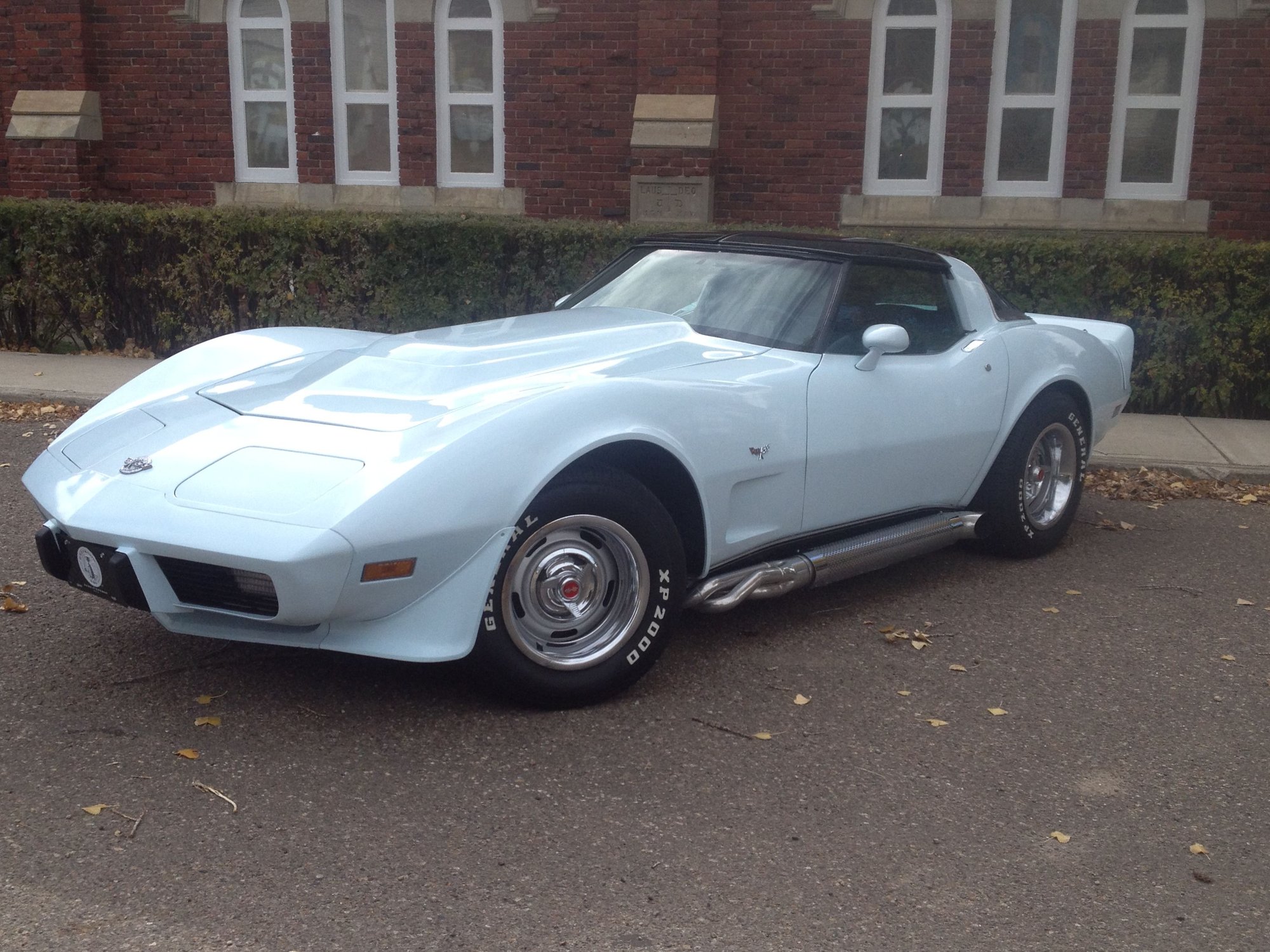

Default Classics chambered to the rescue
78 with 383 stroker and TKO 600
When i first intalled the side pipes I went with the Sweet thunder 2.5 inserts and for me it was too loud,next was a set of smaller sweet thunder inserts which were better but as time wore on they also were starting to get on my nerves. I found the sound was too raspy or sharp,as noted sound is very subjective.
July 17/19
Contacted Eric for a set of 2.5 vette pack inserts and at present I'm very satisfied with the sound of the pipes.Its got a deeper toned down sound but when you open it up it's got a nice side pipe bark to it,in my case i found the car has better performance with these inserts as well,win win in my case.

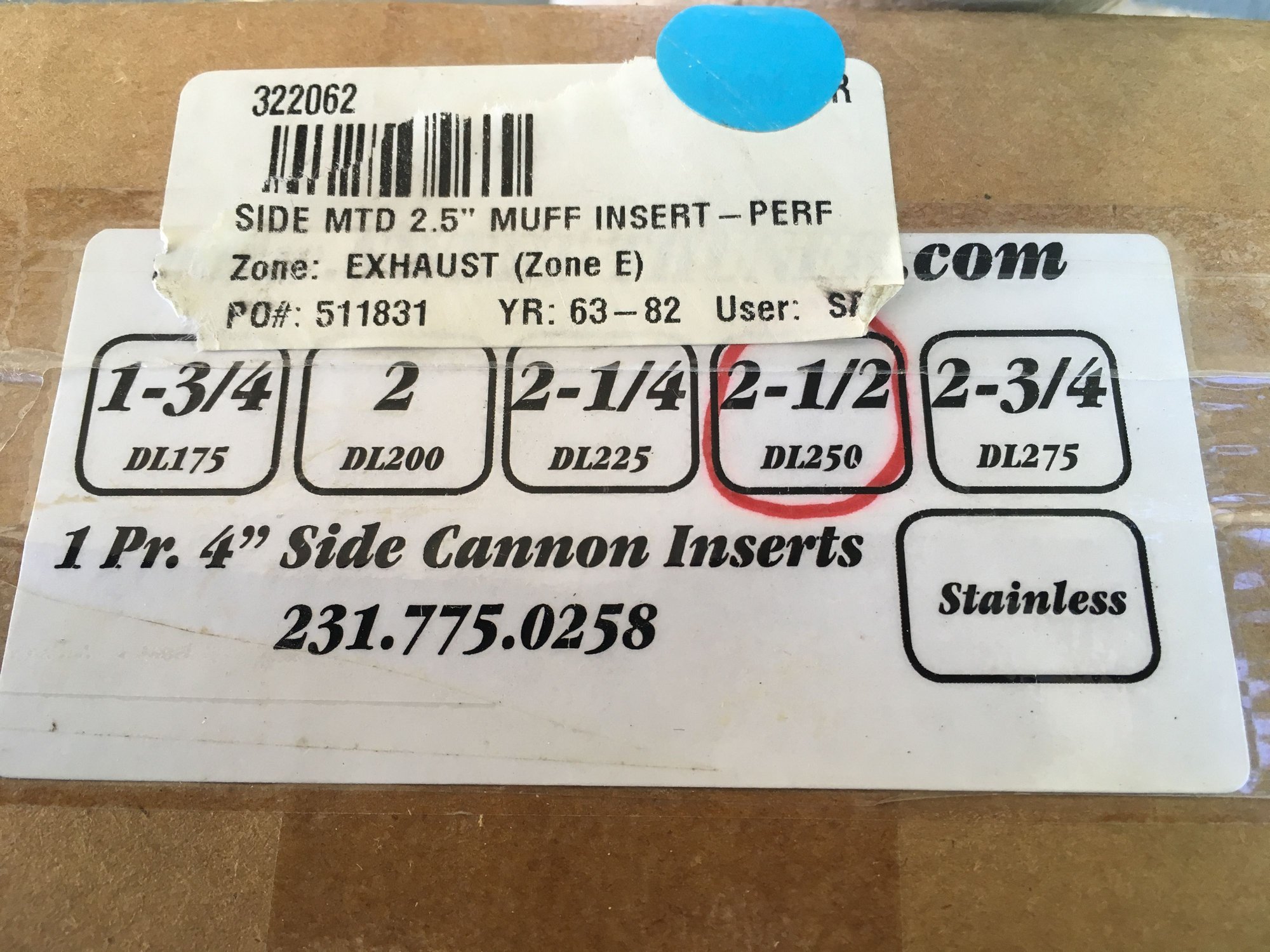

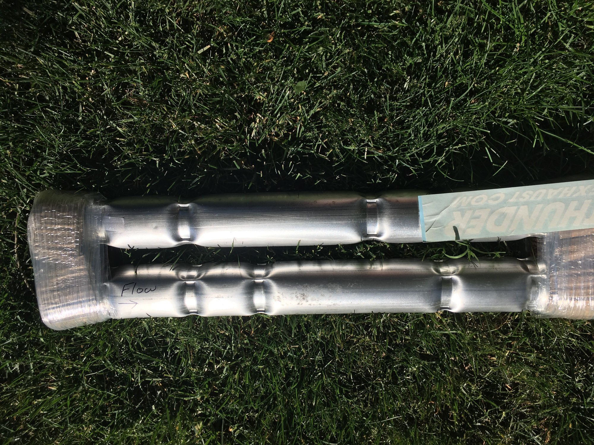

I have a supercharged 496 with 2 1/2 sweet thunders, yes they are very loud, but the dino shop said thats why my HP is fluttering around 520.
Latter I took them out and measured the inside pipe and it was only a little bit over 2 1/4 inch on both pipes---ouch.
