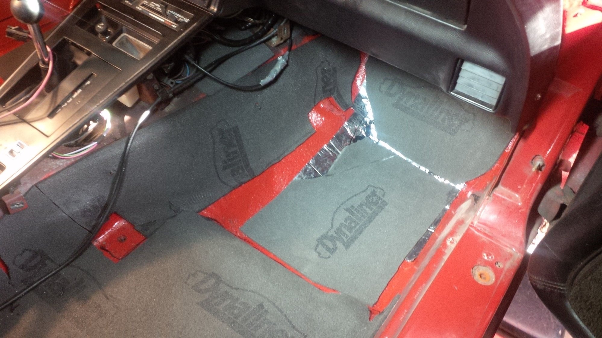

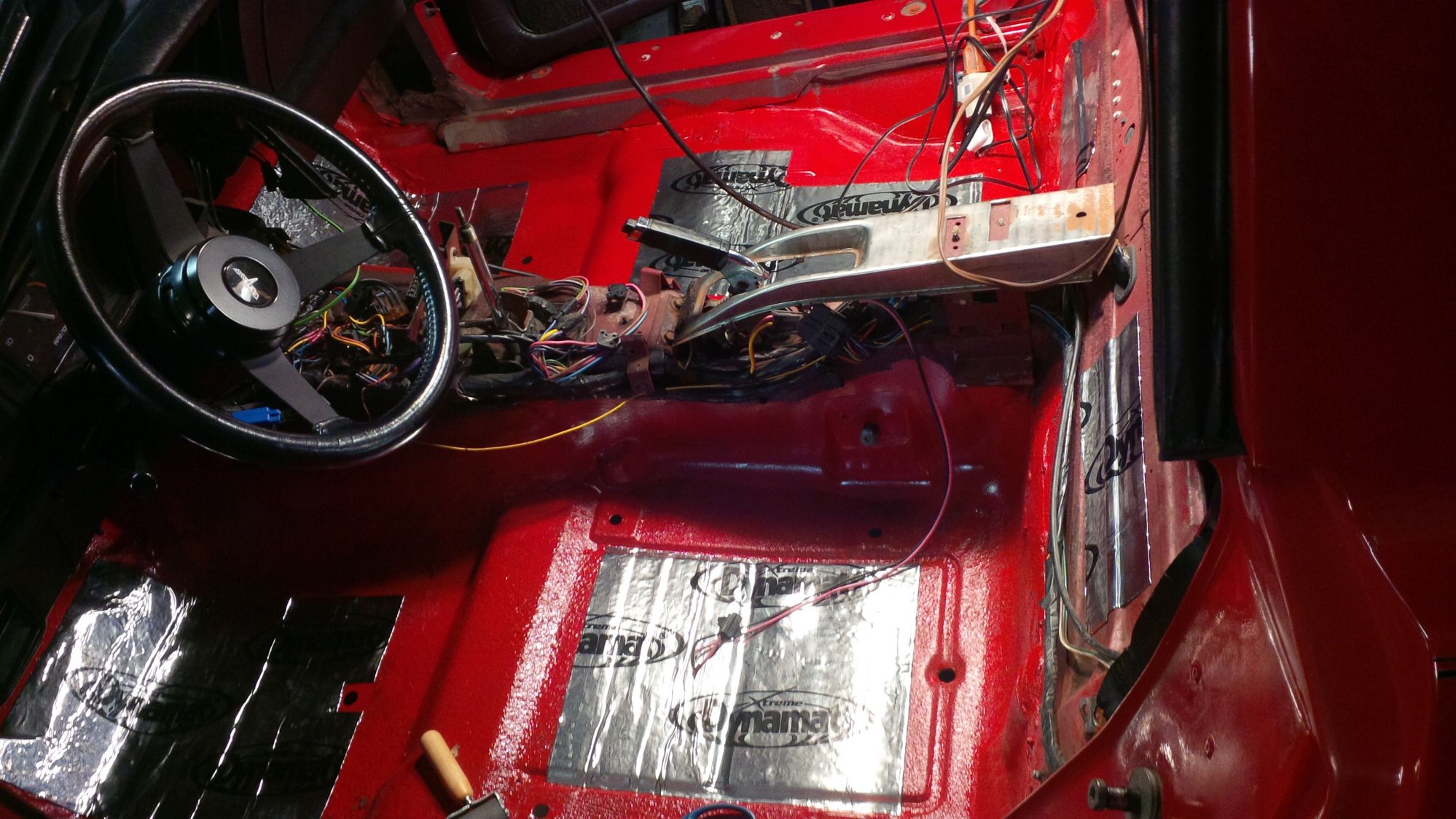

I found a couple pictures of when I did this back in 2014 -
this is the dynamat I installed for sound deadening
And this is the dynaliner on top of it
I could have used more but at the time I didn't want to spend any more money on it. It has held up well.
