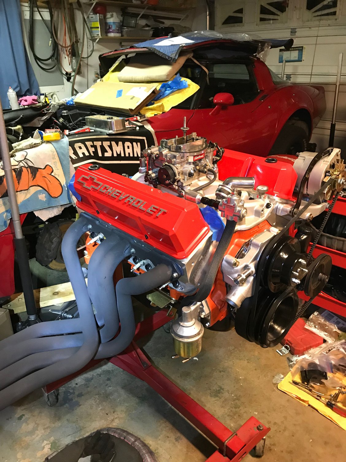

I am strongly considering wrapping my (sidepipe) headers to reduce under hood temps. Currently they are OUT, so now is the time. It seems like it would be worth it, although it's not cheap, especially for side exhaust. I would probably just wrap them until before they exit out the side of the car. I'm figuring almost 200 ft of wrap. Any reason why I shouldn't? (besides $$)

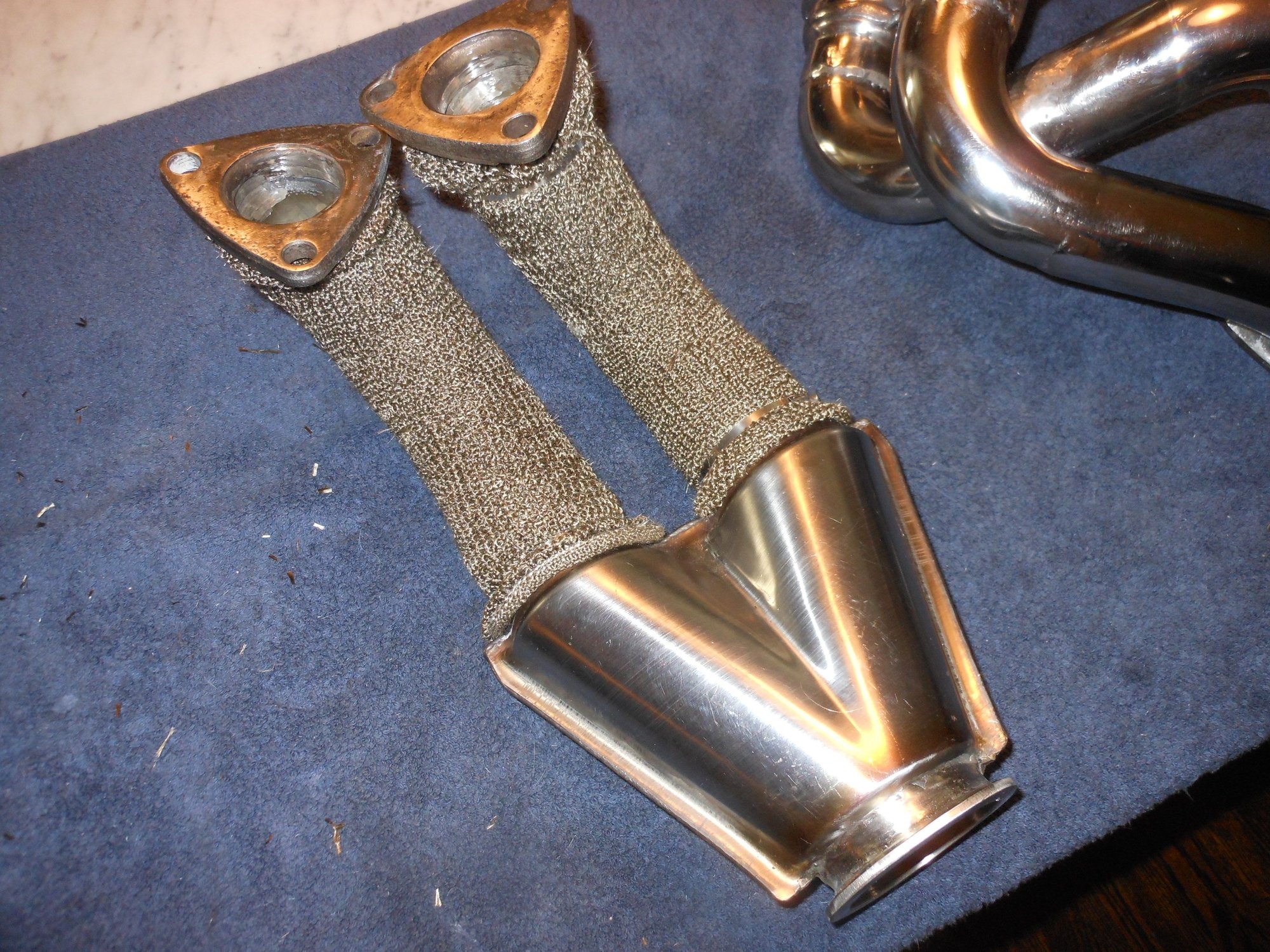

I'm running basalt "socks"-Federal Mongul Thermoflex.
I wrapped inside the sidepipes-
Also protected the sparkplug wires-

Well I went ahead and wrapped them with the DEI stuff and wow is that stuff cool! Looks like gold! I used one 100 foot roll and most of a 50 foot roll. I only went as far as before the pipes exit the side of the car. Lots of conflicting info on this stuff but it seems like it would only help keep temps down. I did paint the headers before I wrapped them so they have a good couple of coats of header paint on them. This was before I was going to wrap them. As always, wrapping pipes is a pain in the butt. Lots of feeding the fabric around the pipes and then when you get to the end, hopefully you don't cut it too short (like I did) or too long and waste it. On the passenger side, I ended up grouping all three middle pipes for a short section because they are so close together. They definitely look cool! (not hot lol)
I also used almost three packs of the Summit clamps and bought the DEI clamp tool.
