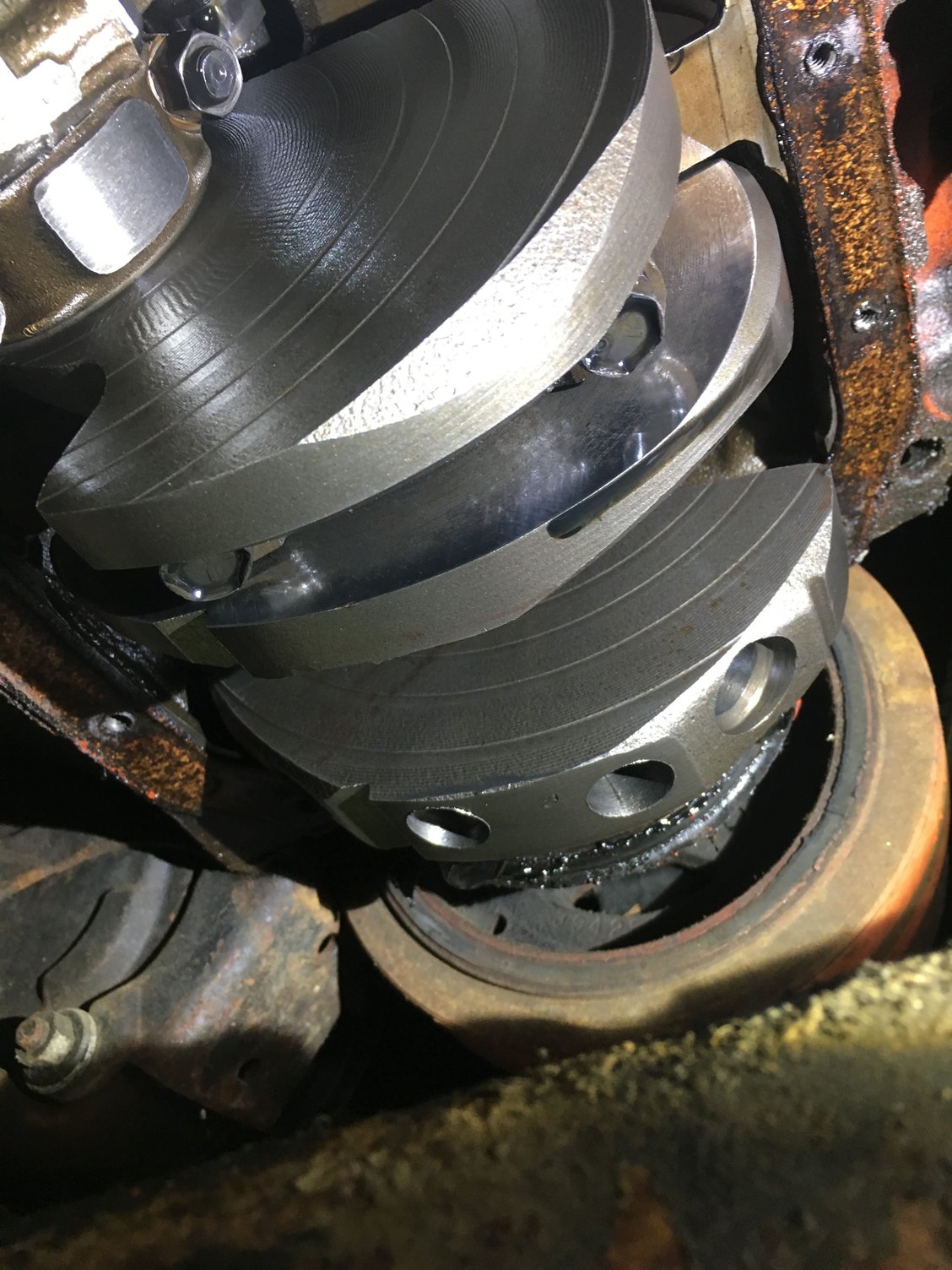

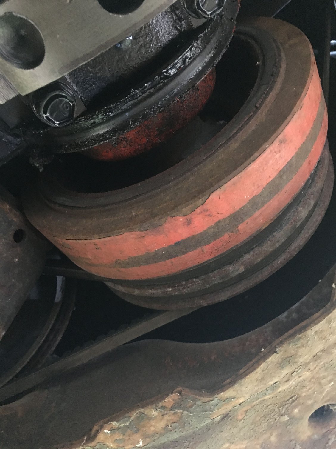

That sucks that u have a vibration. Rule out the bad cylinder and then move on to see if those counter weights are in place. On the front and rear of the engine. An aftermarket harmonic balancer will have a weight bolted to the inside of the ring. A stock balancer will just have a casting with a chunk added to the inside of the ring.
your flywheel will have an 8 inch plate of steel welded to the inside of the starter ring. Make sure that you check both areas for the weights. If one is missing you have a conundrum. Was the engine externally balanced and someone forgot to add the weighted part or is the engine internally balanced and they added the weighted part (flywheel and/or Hormonic balancer) ? You may need to drop an oil pan to find out because you can tell from the counter weights on the crank which set up do you have.

Someone was really grinding down those connecting rods but it looks like they were doing it for clearance issues rather than balancing. Can you get a pic of the large counter weights?

Here is the pictures of my crank lobes and my damper it is smooth all the way around with no weight bolted on
a friend said my crank numbers go with a 400 crank this is my crank number 3951529

just as I wrote above ... 3951529 ... your friend is correct
block 3970014 is typical 350 block from early-mid seventies with 2-piece rms.
some 400 dampers have the "imbalance" cast into the OUTER inertia ring ... it'll be sort of "scalloped" on one section of OD of the outer ring ... pics don't show it all
some of the balance-holes drilled into counterweights appear factory ... some maybe not ...
... it's unlikely the 350 4" bore rod-piston combo weigh same as OE 400 ...
... let's hope the assembly was balanced as a 383 in machine shop.

Download Pioneer damper catalog
pns DA-400 & DA-400HD ... pics on page 77 show the outer ring.
