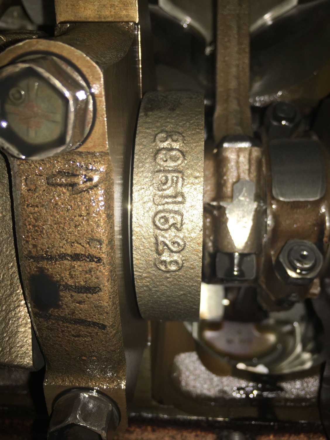

I finally found the number on the crank its 3951925 can any one tell me if it requires to be externally balanced with a balancer and flex plate

? How about answer the questions post #7 ? ... Answers might help us to help you.
3951925 not within my lists ... perhaps in someone else's resources
Pics are very important in these situations.

Sorry I miss typed the number not really text savy I measured the stroke by rotating the crank an measured the bottom of rod an rotated 180 deg an the steel ruler said 1” an 3/8
