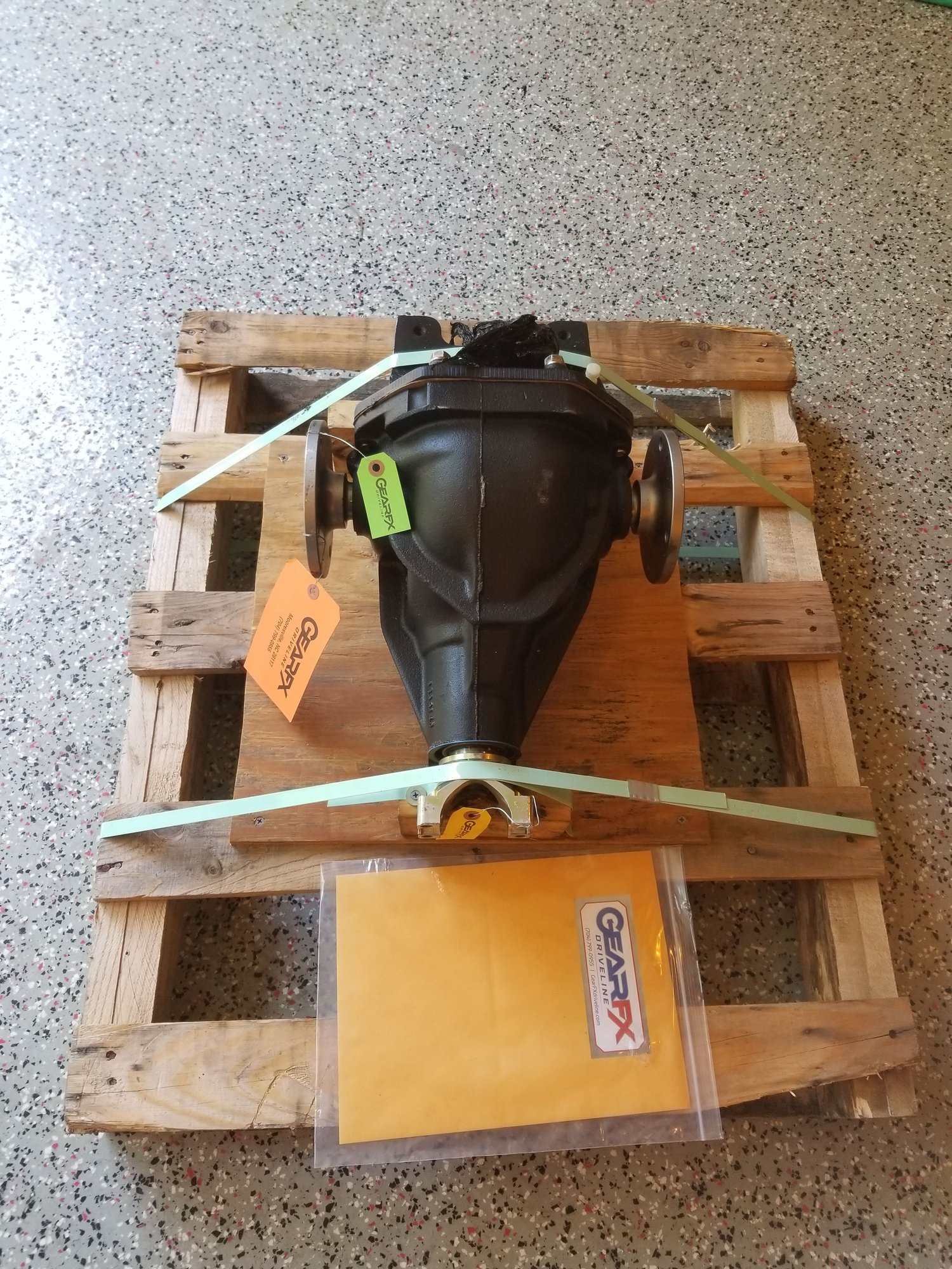

Honestly, as far as I can tell, it looks like we have an unfortunate assembly error. I only have a bit over 2500 miles on the 12 bolt rear end. I haven't even came close to testing the limits of the 12 bolt. I've been struggling with a valve train issue, timing, tuning issue, and rarely get to even get down on the car. After four years, I never even made it to the track. It broke while I was just driving it la de dah to work and home. As I was leaving an intersection, I heard and felt a loud clunking shake. 100yds later I was stopped at the next stop light wondering what the heck(?). I pulled away with all the other rush hour cars and bam clunk no more forward motion. I luckily coasted into a low use turn lane and poked around wondering if my transmission, or diff broke. I ended up getting flat bed towed home. I put the vette up on the hoist, and isolated the problem to the rearend. I dropped it out, and as far as I can tell, it looks like the ring gear bolts backed off and chewed up the cover, and bearing cap. Thankfully, there was absolutely no way this broke from abuse, just an assembly mishap.
It was built by Mike (Tracdogg2) one of our forums two "reputable" 12 bolt builders. I had a lot of issues working with him when I had him set up my diff, control arms, and half shafts, so I didn't do a all praise the great Mike write up on the forum. I've been ghosted, just like when he told me 3weeks to build, all parts available, and it took nearly 3 months to receive my diff, half shafts, and control arms. It wasn't until I scheduled a flight to texas, and asked him to pack it all up and send it to Gary that he finally started to work on my parts. I'm fine within reasonable delays. Just keep informed and have a legitimate excuse. I felt that once he has your money and parts he'll get to it when he feels like it. No updates, or explanations for delay. Your results may vary. Good luck.
I sent Mike pictures of the assembly mishap asking his thoughts, and what he could do to help me get back on the road, and never got a response.
Clearly the ring gear bolts backed off and destroyed the rear end. The ring gear wasn't pressed on. Ring gear bolts weren't hardened, or chamfered, Potentially not torqued, or maybe the bolts bottomed out, or maybe no Loctite, ring gear shifting around could have caused the bolts to loosen, I don't know, but at least it didn't break do to abuse, Honestly, I work in manufacturing, things go wrong sometimes do to distractions, or missing a critical detail. I didn't ask for money back, just help getting it repaired.
I reached out to Gary. He was beyond helpful, taking time to respond to emails phone calls, and estimating costs to repair, and give an honest timeline. I really wanted to drive my car this year, and Gary was pretty busy, so I reached out to Detroit Speed to ask about their hammerhead diff. Skip at Detroit Speed had me contact Fuzzy at GearFX driveline to see if he could rebuild my diff. 3 weeks later, I had my diff back! Great guys who went out of their way to help me out.
I'm disappointed in Mike, but I know others can't say enough good about him. Clearly, he can do good work, and provide customer satisfaction. It just didn't work out for me.
I attached pictures.

AJ thank you and everyone that offered sympathy for my situation. It was very disappointing when it "broke". I was very confident in the build, but disappointed with what I see as manipulative and deceptive on my build timeline. I'm totally cool with delays if there is communication and acceptable reasons for delays. Mike left me with a sour taste because he didn't personally respond to my questions on the status of my build. After I received my parts, I decided not to post any good or bad comments, and just move on. There was always a voice in my head telling me I should inform others what happened, but hey I was on the road with a bad *** 12 bolt that should allow me to safely and reliably beat on my car with confidence it would stay together. I have bragged to countess people about my cool custom 12 bolt and who built it. When the unfortunate failure occurred, I was sick to my stomach. I'm currently in a bad financial situation, and so so could not afford to have additional financial burden. I'm usually not in this situation. I had hoped Mike would offer me some compromise like you pay parts, i'll cover the labor, or vice versa, but I didn't ask for either, just help getting me back on the road. I didn't get a response from him, and thought well that just great. I'm happy that GearFX could help me out, and Gary was willing to step up too. I was excited to try out the Hammerhead IRS, but I'd have to wait until the end of the summer. That wasn't going to work for me. I'm confident that my new diff is assembled correctly.
I like OldCarBums comment its a good attitude: "I'm glad that you posted the possible cause and that others have chimed in with similar experiences.
Hopefully the information you provided to those, like Gary and Mike, who do excellent custom machining and assembly of our differentials, will cause them to look at these areas more carefully during assembly."
I'm not trying to get everyone all worked up. I just needed to get this off my chest and let people know what happened to me. I felt great going into my build with Mike, but clearly things didn't work out that great for me.
Thanks again to everyone who wished me good luck with my new rear end. I'm very excited to get it broke in and start testing it. When I rebuilt my short block last fall I installed Straub custom camshaft that is supposed to put me at a solid 757hp on pump gas. It was driving just great, I was having the best summer ever with my car. I'm hoping to get back to enjoying driving my car soon.

Yep, it was a mess inside, but I was surprised how good the gears looked despite all the metal particles inside the housing. Unfortunately nothing was reusable except the case. I was real happy with GearFXs willingness to help me get it back together. GearFX assembles the new Hammerhead differentials for Detroit Speed. They are someone to consider if you need a heavy duty C3 diff. 33 and 35 spline options instead of 30 like I have, plus you could go with a truetrac instead of a posi unit. Plus they offer more gear options! Thanks for looking.
The biggest bummer now is that I broke my wrist and can't put it back together. Although, I have a friend that may be able to help me put it back in next weekend. Driving with a cast may be difficult.

I'm glad that were getting some posts where ring gear bolts backed out, were loose, etc. It's comforting know it happens. I feel like Rodney Dangerfield...If it wasn't' for bad luck, I wouldn't have any.

I have heard of this happening before as well. Also heard of using incorrect ring gear bolts/washers etc... Im sure anything is possible. Looking at your pics, it definitely looks like the bolts backed out and caused the initial issue. WHY they backed out is the question.
At least you’re back in business, unfortunately on your own dime. Hopefully Mike will make it right. I won’t make excuses for him because I don’t know the situation but, I know he was working multiple jobs there for a while, and in the midst of moving, so maybe he got off track in the shuffle.
He’s a good guy though. I tore up a ring gear in my diff, Mike had me bring it to him, and he rebuilt the entire thing on one day, while I watched him, he ate all of the parts, labor, everything...I was literally in and out the same day. I’ve had that rebuilt diff in for 9 years now and 27k HARD miles... I had great service from Mike. I eventually had him do all of my dads 66’ verts front and rear suspension/diff and that car has been fine as well.
And you can never go wrong with advice from Gary Ramadei....dude is a genius on this stuff.

To OP. Sorry to hear about your diff failure.
But not surprised.
When I had Gary build my Super 10, I documented every step here on the forum with pictures so everyone could see how its supposed to be done.
An important detail missed by many is the use of ring gear bolts with lock washers. vs ARP ring bolts with loctite.
This issue is not the first time with cheap lock washers being used instead of ARP bolts.

bmans_vette I took a look at the post. One of my concerns was no relief for the radius on the ring gear bolts to washer fitment. They would torque, but not seat on the intended mating surfaces. The bolts and washers were to trashed to determine if it may have been the probable cause.

If you want to see the difference, check out my thread here
https://www.corvetteforum.com/forums...ial-build.html
Look at post #14 to see how Gary machines the case for the ARP bolts.
There's no question that Mike does great work based on others feedback, but this does seem unusual. They look like they might be ARP bolts (12 point heads) but if so then why the lock washers? Does seem strange. I did the ARP bolts with loctite and countersunk the holes to clear the chamfer when I built mine. ARPs always (at least from what I've seen) specify not using other washers under the heads.
