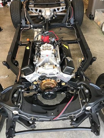

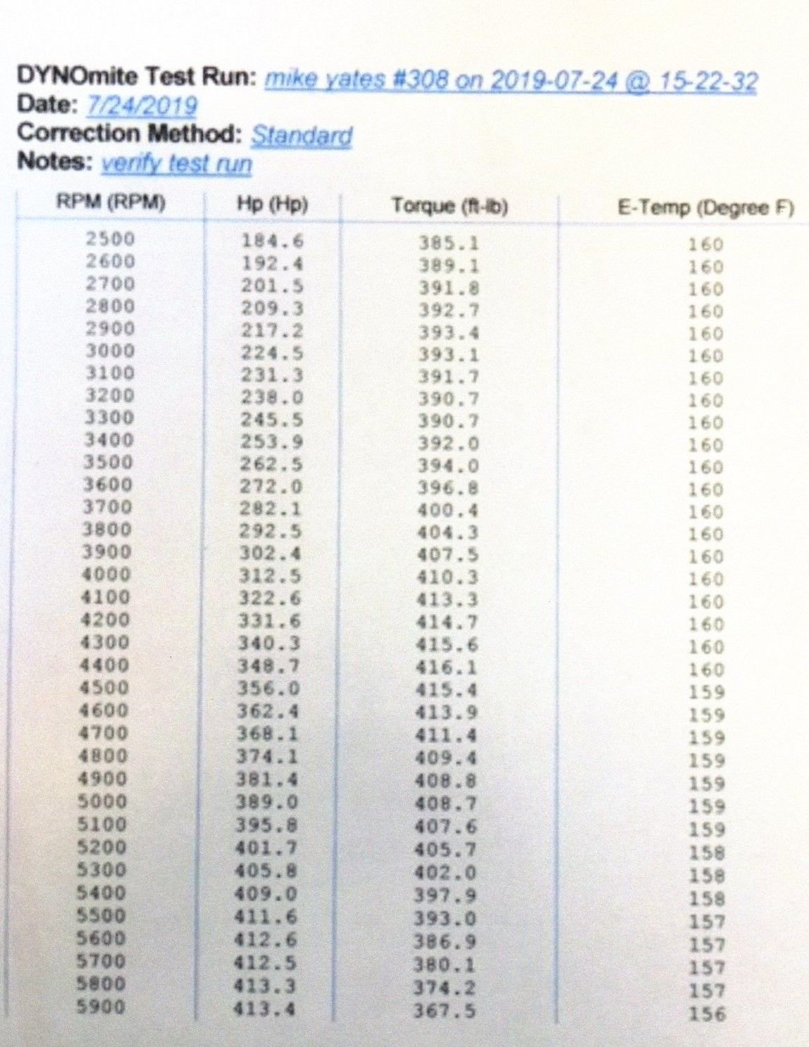

I am running the Pro Flo 4 too for all of these reasons. Haven't driven it yet but it was installed and tuned when my motor was dyno tested. Fired right up and kept running better each time it was started. Very happy with the results on my 350.

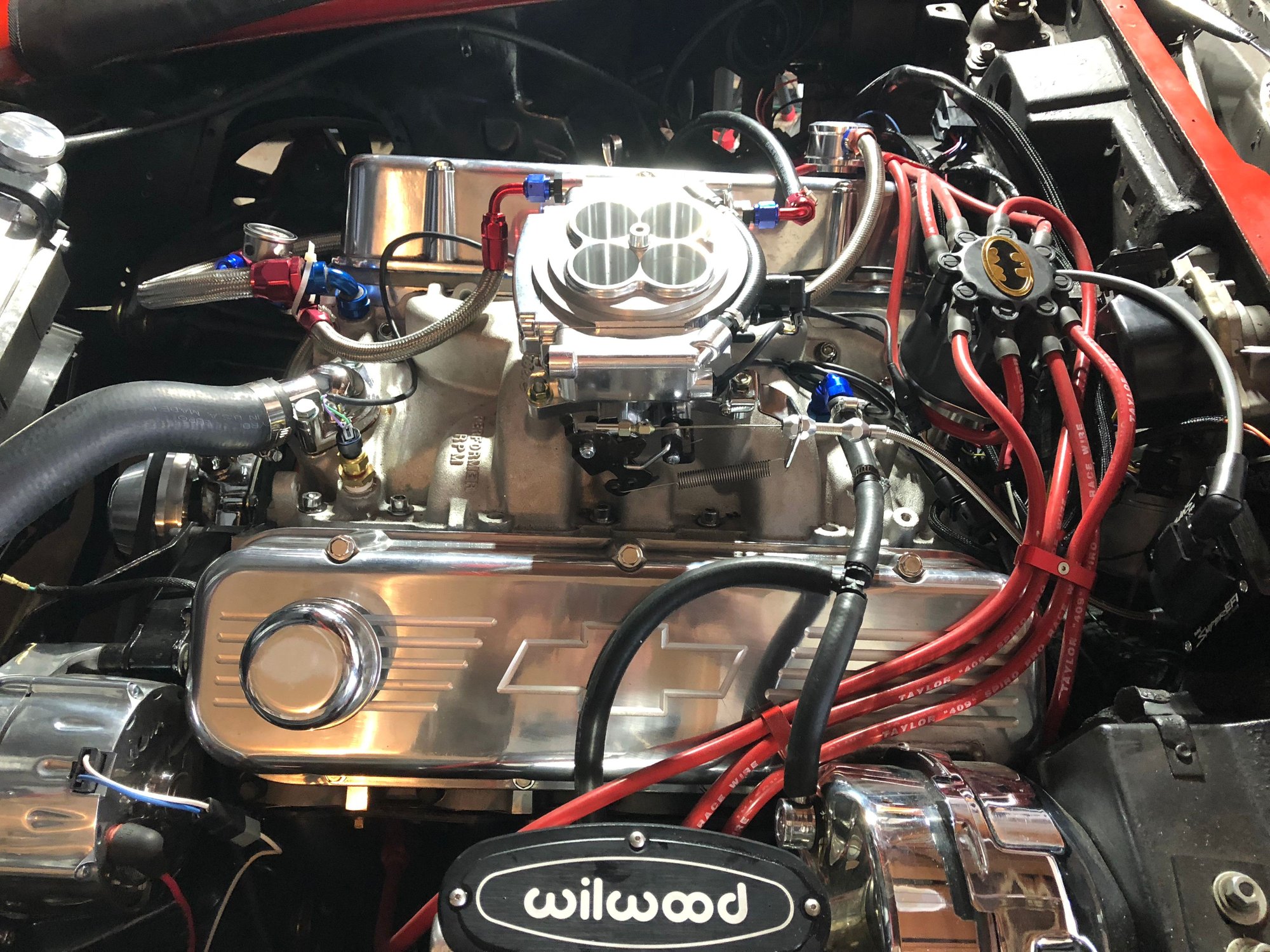

I switched to the Sniper with the entire Hyperspark ignition system. Super easy.
Better throttle response, no starting issues, no vapor locking, easy warm up. Depending on how built your engine is, you will want to eventually get it tuned by a pro.
I will say that I was disappointed that my fuel economy didn't get better. I think it actually got a little worse. Then again it is a 600hp 496, so its hard to tell.
You will want to get the throttle arm extension because without it the throttle is way too stiff and touchy.
https://www.efisystempro.com/sniper/...ter-lever-1952
I also put in the Holley gas tank with the internal fuel pump. All install was super easy.
