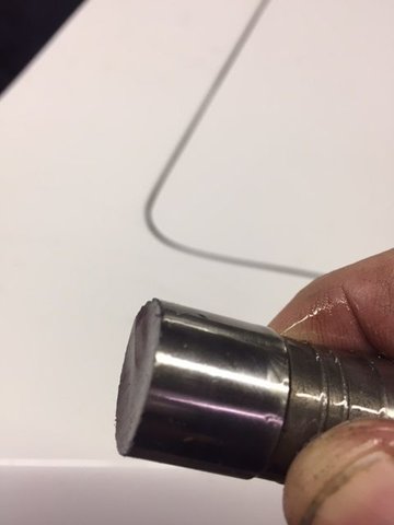

Old Oct 12, 2019 | 06:18 PM
1tazz's Avatar
1tazz
Joined: Feb 2015
Posts: 41
Likes: 14
From: NC
Old Oct 12, 2019 | 06:21 PM
  #33
HeadsU.P.'s Avatar
HeadsU.P.
Joined: Aug 2017
Posts: 8,336
Likes: 2,810
From: Cool Northern Michigan
Ok, seen worse. Scar across the surface tells me the lifter was not turning in its bore.
Or in laymans terms: death to a lifter. (quick death)

Thanks Heads up but do you not feel like if it was a lack of oil I would have had more than one lifter fail.

No, not necessarily. Maybe just a coincidence but that lifter appears to be the last one on the oil galley line.
And I thought it was more than just one lifter.
And I assume that lifter is up front? Farthest from the oil pump? Or is that in the back? Can't remember where that oil drain hole is.

Yes you are right all the way up front. Looks like motor will coming out mon .
