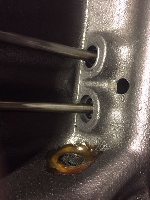

You know you are in trouble when you see a lifter seating this low in the bore.

From: Unreconstructed, South Carolina
sorry, so true
