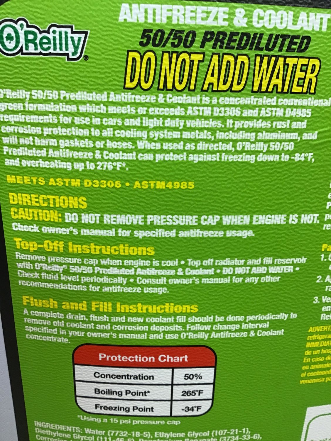

I did exchange the universal antifreeze to the 50/50 green for pre 1995 gm etc...
i feel better now thanks!

Is that compatible with your aluminium rad?

I had my lower rad hose spring a leak the other day. So I flushed out all the coolant and replaced it with Prestone 50/50 which says on the jug is okay for aluminum rads, the guy behind the counter said he uses the same stuff in his nova that has an aluminum rad. So lets see what happens, oh and I also put in a bottle of Lucas water wetter.

lol i had to look..i think so...
