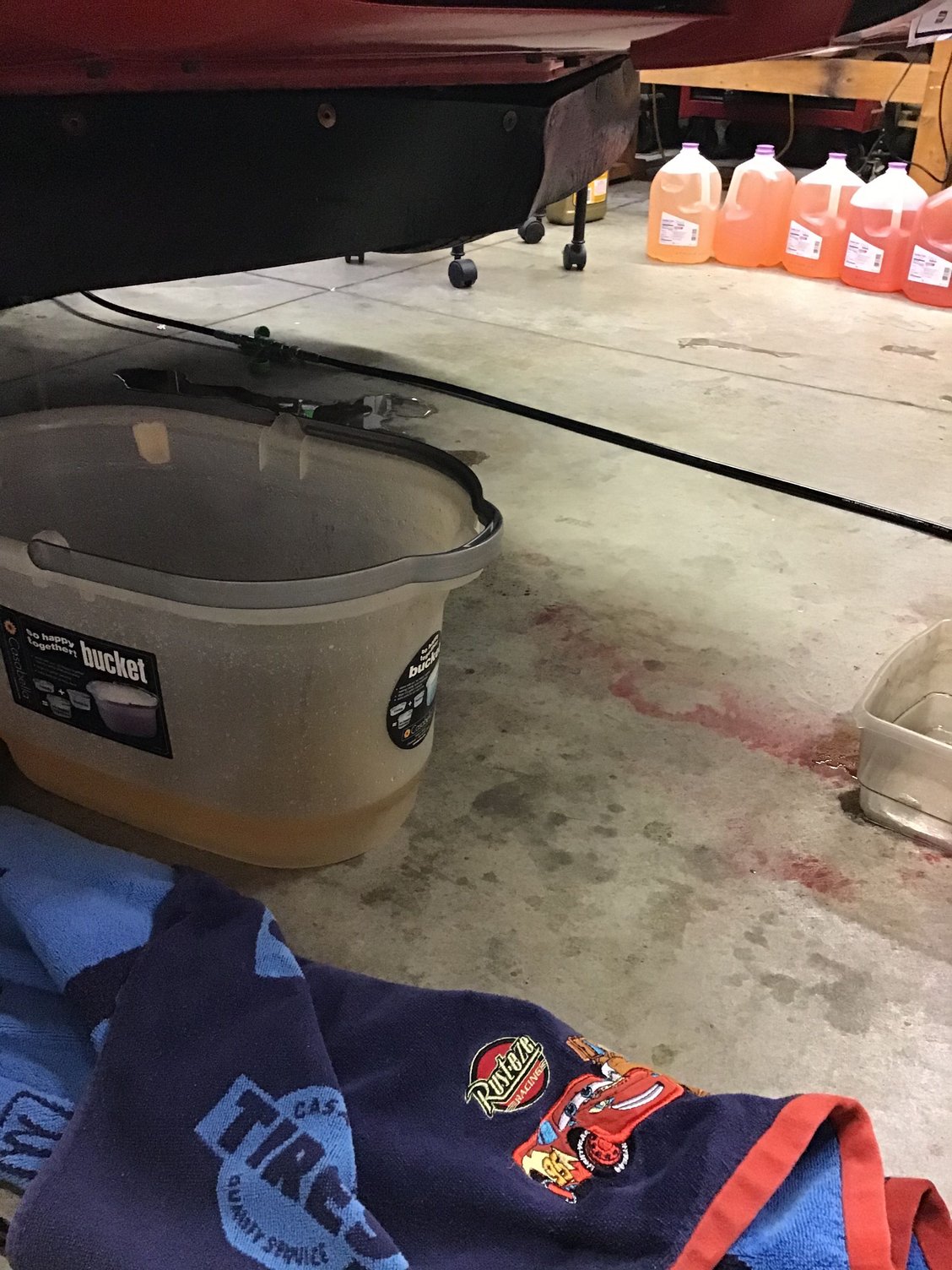

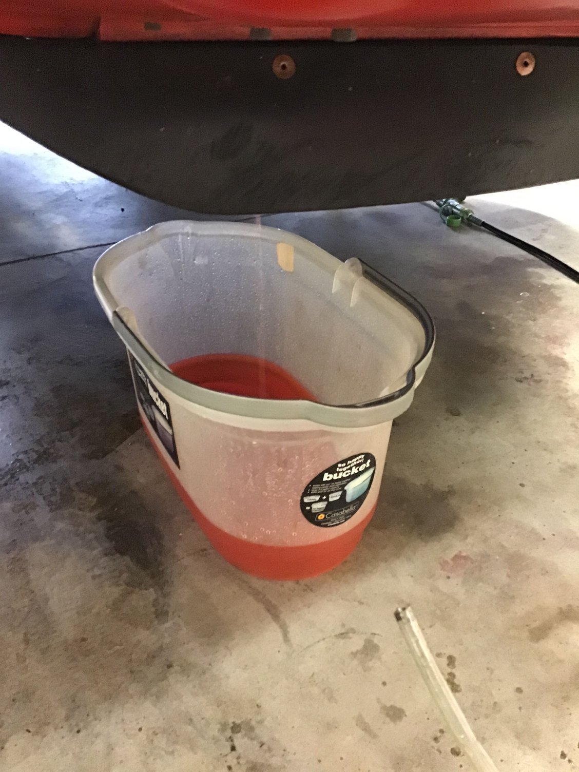

so although i think i would be ok with what i put in...i also reread my bottles because ive used a lot of coolant with new radiator, leaks, heater core etc...and guess what i mixed 50/50 and concentrate so no clue what ratio in it...
sooooooooooo.......... a few rounds of walmart distilled water and heater and drain....then off to store for what?
Old Oct 24, 2019 | 09:00 PM
interpon's Avatar
interpon
Joined: Jun 2019
Posts: 7,655
Likes: 2,469
From: Indiana
Going with this...flush number 4... will do 5 and then coolant done..
note to self...never never use internet rice and soap in overflow bottle to clean when i did ac...never gets it all..til now blow gun and vacuum.
And its green
