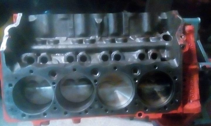

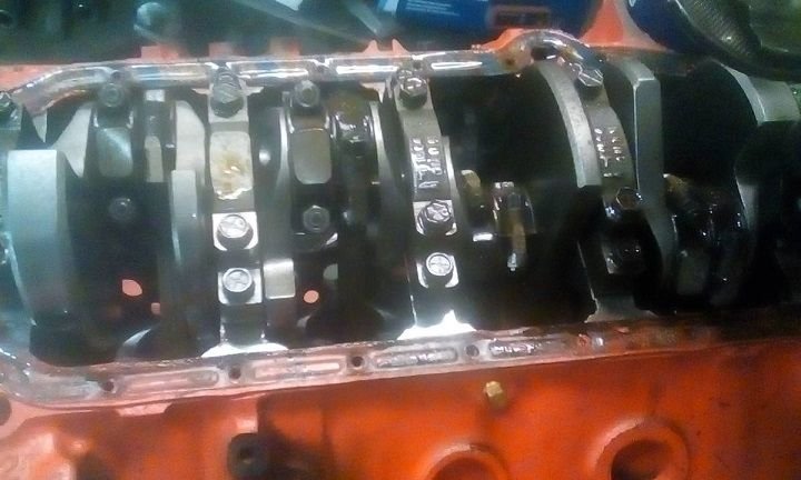

With so much talk about a big cube smallblock, I happened to stumble across this 406 cuin short block (4-bolt main) on the Raleigh CL and thought someone here might have an interest... Looks like it's located just NE of Raleigh between I-85 & I-95
406 SBC short block - $800 (Louisburg)
https://raleigh.craigslist.org/pts/d/louisburg-406-sbc-short-block/7019275328.html
I have a 406 SBC short block.It has around 500 miles on it.It is a 511 four bolt block.It has new Keith black signature series pistons with 5.7 bushed rods.It has a new cast steel crank with chamferred oil holes and lighting holes drilled in all rod throws.The block has been tapped for lifter valley breathers and deck plugs.It has a Melling oil pump and Clevite rod and main bearings.$800.
