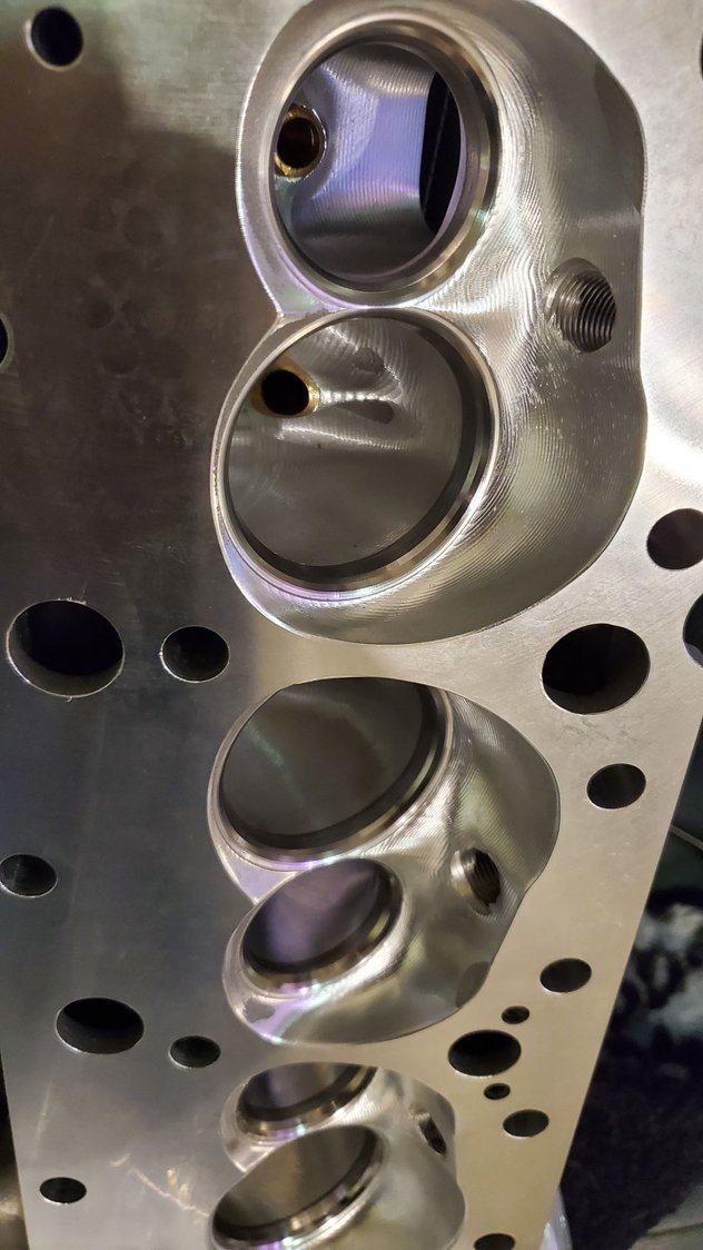

  #133
SeanGalt's Avatar
SeanGalt
Joined: May 2018
Posts: 75
Likes: 12
Default Me too..
Originally Posted by Flyboy1958
I have read lots of threads on big inch big blocks, but am starting another one. I have some threads going now about my quality built 350 with oil in runners and the engine for sale in classified, so I have decided I am building a big inch small block. What I want is big block torque, and really do not care about HP numbers at 6000 RPM. I want an engine that pushes me back in the seat with factory 4-speed WITHOUT having to go to 5000 RPM to do so.....I want it to happen at 2500-3000 RPM, which I gather a real big block does.
I have already decided a 383 will not do it, so I start at a 406. But there is something desirable to me to go to a 427, just because of the number! What my question to all of you is, what is the downside to stuffing a 4.0 inch stroke into a SBC? But there are some requirements......I need the engine to be reliable, and have longevity to take it till I am done. I am 61, plan to retire at 66, and I do not want to ever have to remove it and rebuild it again. I drive 5000-6000 miles a year, and when I retire I hope that number goes up. I want the engine to outlast me. So with those qualifications, does a 427 fit? Does the higher piston speeds wear the rings faster? Does the reduced compression height on the pistons (just over an inch) cause issues? Does the large stroke crank cause issues with the oil, as I understand I will need an oil pan with kickouts and scraper. What other considerations based on this would make a 427 a bad idea? What else? Talk to me.
Please don't start, as always seems to be the case, with the inevitable thread direction of going bigger and bigger and bigger. I will not go over 427 as I already think it is too much. I want bottom end torque, not an engine that wins a drag race or even a street race. I need it to be a well mannered, street friendly engine. I would consider a real big block, but just don't want to go there, and forget an LS engine. I enjoy the appearance of my car being original, and will not make upgrades to 5-speed transmissions, big blocks or LS engines. I have 15 inch wheels, manual steering, 355 rear end, love my factory 4-speed, etc.
Lastly, I am getting the engine dyno'd before I install it, so I am looking for someone to build it this time, rather than do it myself. The problems I am now having with my 350 really have frustrated me, because I am worried I did something wrong. While I have 40 plus years of mechanical experience behind me, I am by no means an engine builder.
I got Flotek 220 heads on my 406 I'm building.. Yours Should be a torque monster as well. No replacement for displacement !
