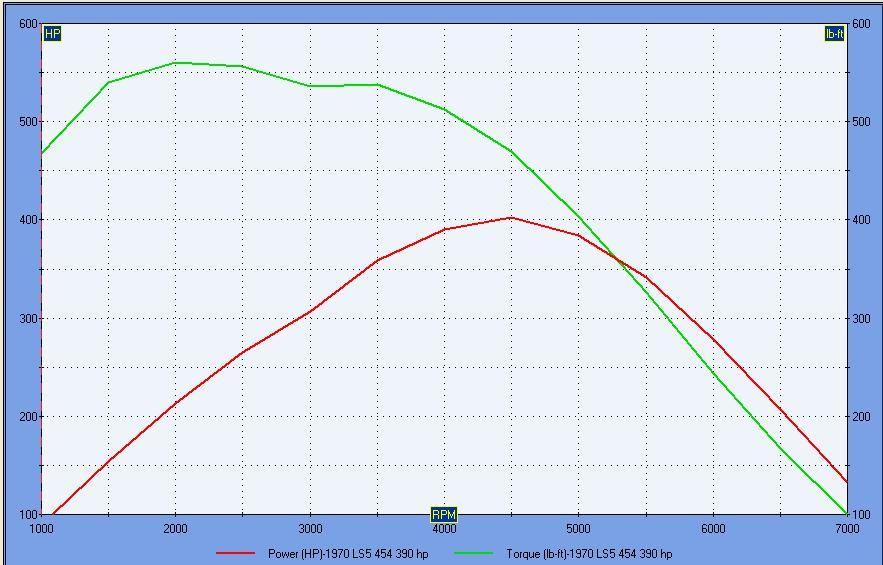

Did anyone see the power graphs in post 61?? I am not sure why it is not clear what that torque curve will feel like in the car. Seems to me the only argument would be that the torque curve shown would actually not be the same in real life. If anyone has charts that show same torque curve as these AND power at 5000 plus, let’s see it because that seems to be the argument from the race boys.

I guess I have to bring up the fact that a 454 BBC also has a rod ratio of 1.5, and they are known to last a long time. They certainly don't self-destruct in 16,000 miles. or 50k or 100k for that matter.
Since an LS5 was brought up, here is the power curve for an 1970 454 LS5 that the OP wants to emulate if possible in a SBC.
These are known to produce great low end torque, with a long flat torque curve that practically starts at idle, and the smallish factory cam makes them run out of breath around 5000-5500.
GM says they peak at 390HP at 4800 rpm. Some here not so lovingly refer to it as a truck motor because of that.
The OPs proposed 427 SBC would actually have within a few ft lbs of this low end torque level (maybe 20 lower), and make a little more high rpm HP (maybe 20). I find it amazing that a SBC can be made to mimic a BBC so closely.
All this without the weight penalty of a BBC or the severe parts penalty from swapping over to all BBC headers, exhaust, pulleys, brackets, rad, etc.
It sounds like he wants to re-use his excellent existing heads/manifold/carb. So we are only talking a short block change.
This would be many thousands less than the LS5 route. Or a compete crate motor for that matter, of any size.
