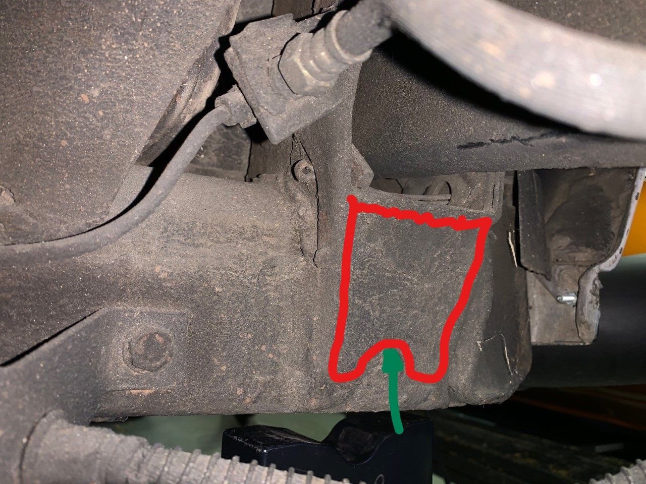

Old Dec 24, 2019 | 04:46 PM
mysixtynine's Avatar
mysixtynine
Joined: Dec 2008
Posts: 971
Likes: 45
From: Middlesex NJ
With shocks off the trailing arms will hang down lower ... the shocks bottom out before the trailing arms do in the suspension travel.
The TA front bushing bolts are shimmed and then tightened at ride height so the bushing isn’t torn up from being extended too much one way or the other. Your pass side arm is staying up because it was tightened at ride height and the bushing is holding onto it.
Your shim on the pass side is just too long ... seen it before . Whomever aligned / shimmed it should have trimmed it to fit in the pocket and be held down by the cotter pin.
Your frame looks clean to me I don’t see rot or cracks in the later pics you posted.
Your drivers side bushing material may have let go inside or the shims and bolt are just looser in that side and able to pivot with the TA as it travels.
If your tires wear well and your rear isnt squirrelly then your ok...
Old Dec 24, 2019 | 07:56 PM
  #33
austinseanchris's Avatar
austinseanchris
Joined: Nov 2008
Posts: 965
Likes: 28
From: Mt. Pleasant NC
Thanks for the useful info...Yea, what was gonna be a simple freshening of parts is turning into a whole can of worms. And Im the type thats doesnt wanna half a** things...If Im in there, might as well go ahead replace it. I havent taken the TA’s out yet, just hope it doesnt turn into a nightmare. Hate to bite off more than I can chew. Ive got all new bushings for them just hope theres not more involved. Was gonna get new ujoints for the half shafts while in there. Thought about cleaning up and powder coating the half shafts while in there. After having to have someone install the new ujoints(since I dont have the tools), it was better off to just buy new heavy duty 3” ones with spicer joints. Takes a few steps outta the rebuild process I suppose. Nonetheless, we’re gettin there...Ill probably go ahead and sandblast the TA’s and paint them while out...why not lol. Thanks to all for all the help that has been provided and Merry Christmas to all!

Old Dec 25, 2019 | 07:06 PM
  #36
bazza77's Avatar
bazza77
Joined: Jul 2010
Posts: 3,176
Likes: 633
From: perth western australia
while your down there , you might want to clean out that "pocket " it gets full of road grime and can start the rust process . Get a small screwdriver (or something) and start digging out the crap ,where the green arrow is the "drain hole"
Old Dec 25, 2019 | 07:57 PM
  #37
austinseanchris
Joined: Nov 2008
Posts: 965
Likes: 28
Most definitely will!
