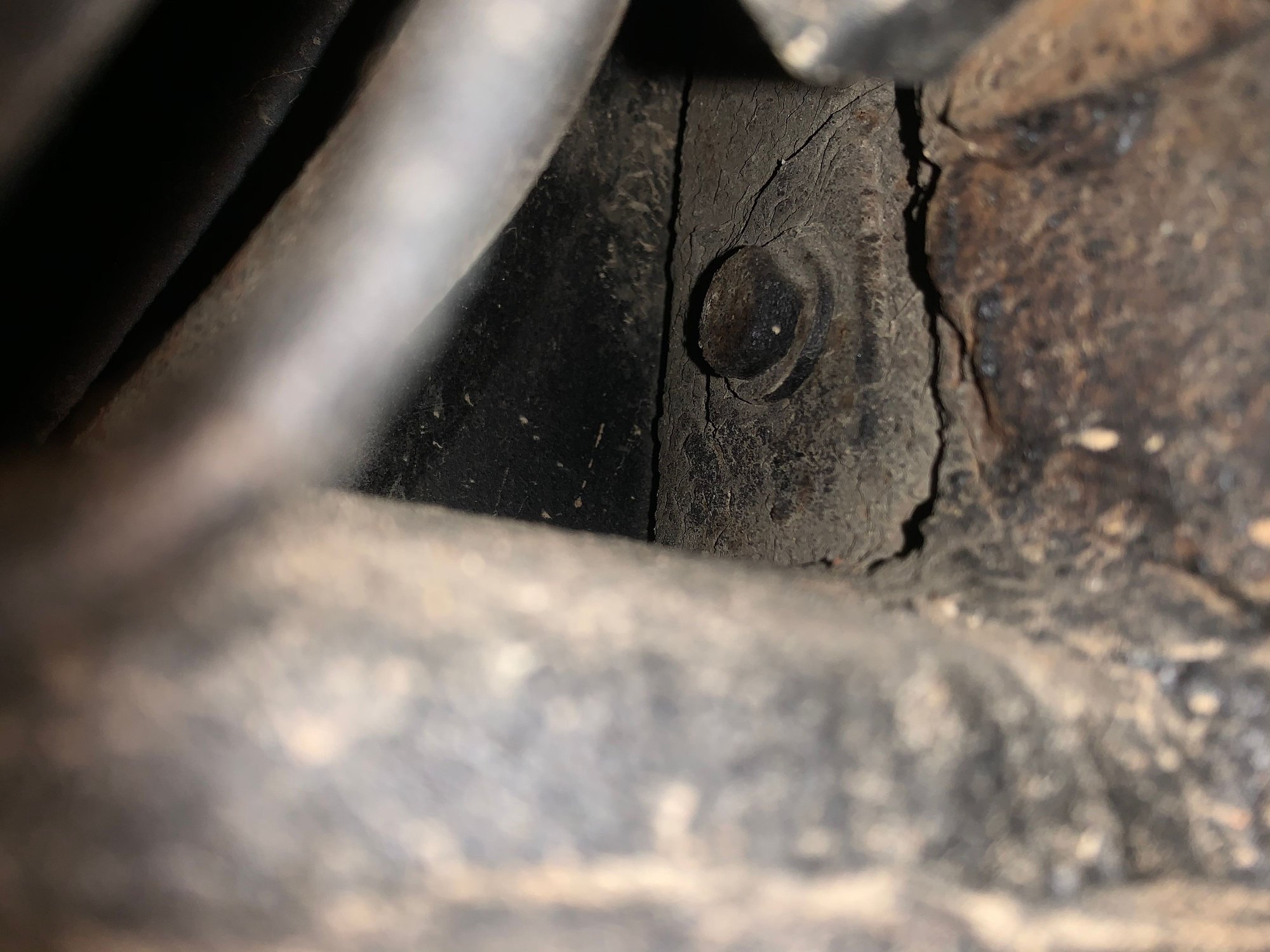

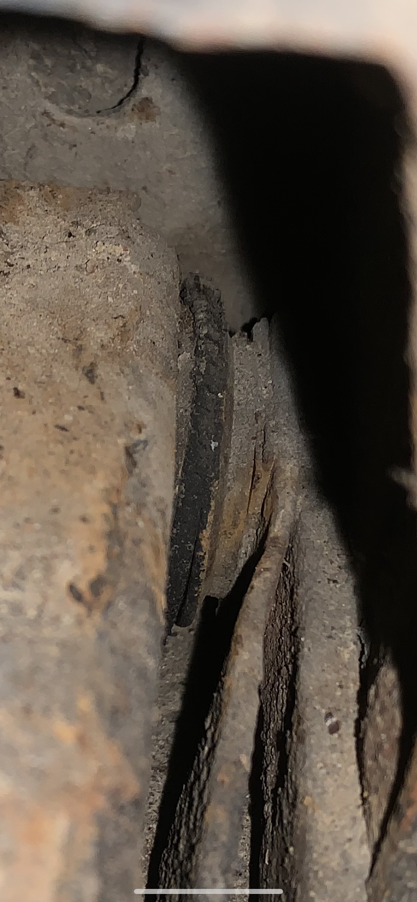

I plan to replace the strut rods with adjustable ones. The rubber looks a bit squished.
The rear spring has one leaf that seems broken. I will be replacing it with a fiberglass one to match the stiffer front coils.
Peering in the pockets of the trailing arms, they look clean. One shim flops around a tick loosely.
It will be in the same condition as the front was.
Your into u joints and a spring. Just be done with it.
If the rear needs work, you can do that next year. Just finish the drive train and suspension.

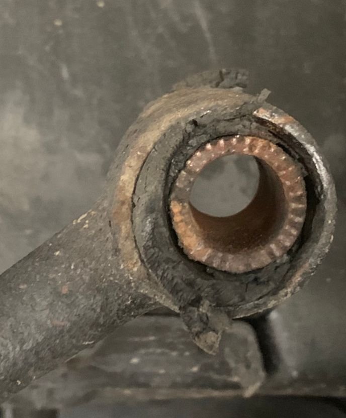

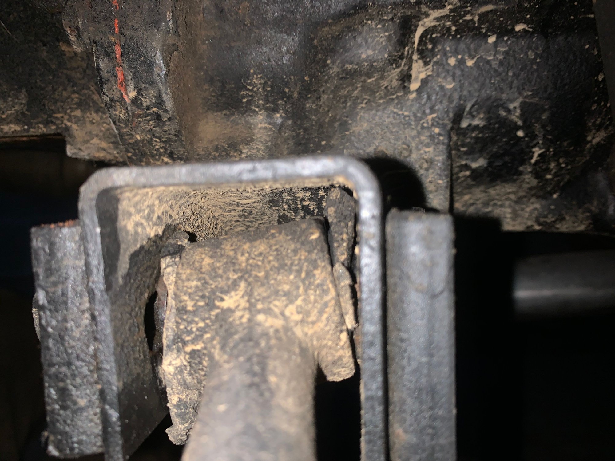

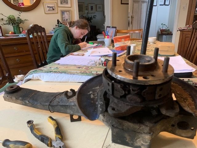

Default Unequivocal
Perished for sure. I can see the dry cracks.
Hm. That looks weird. In the strut connection to bracket under carrier.
I may luck out here. That inner TA bolt looks pretty clean.

I'll almost guarantee you those awful looking strut rod bushings are the source of all or most of the "vagueness" you mentioned. They carry 90% of the load while turning and lateral movement there is not wanted. Do those first and you may be done. If it still remains "vague" then go for the trailing arm bushings.
Exactly! Do the heim-jointed strut rods, and re-check the alignment (slight toe-in, and proper camber, which you can do yourself), and you may be all set. If you can get them out now, replace the shims with stainless shims.

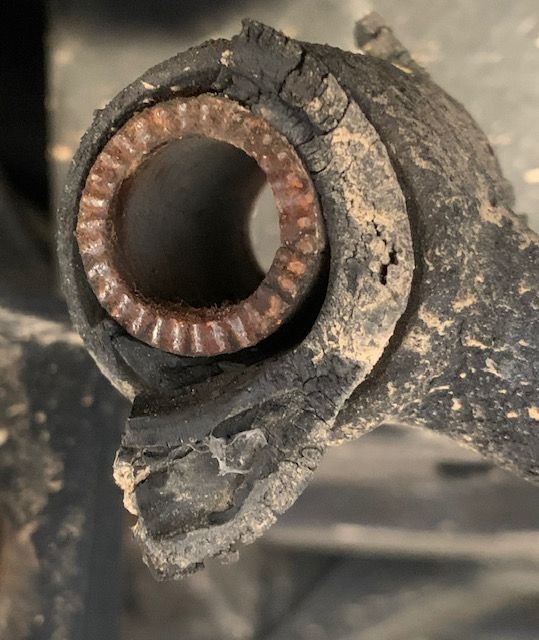

Welp, I got lucky with one trailing arm that came out without much of a fight... The other is still in there and I suspect will require a sawzall.
I think we can safely say that the rods were not doing their job, at all. I could not get the rods off of the TA, but I do suspect that side is every inch as bad.
FWIW, I couldn't get the shock bolts out of the trailing arms without removing the arms from the car, so my strut rod replacement quickly escalated to a complete rear-end rebuild. But yours may not have to!
Are those really worth it ? The rods with him joints, that is.

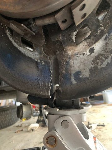

Also found a dust shield with issues...
At this point I think I may opt to farm this out for a rebuild. Those Vtech folks look pretty competitive. Do you fellas have "go-to" rebuilders ?

If wheel bearings are good, finish fighting the bushings out and replace them.
