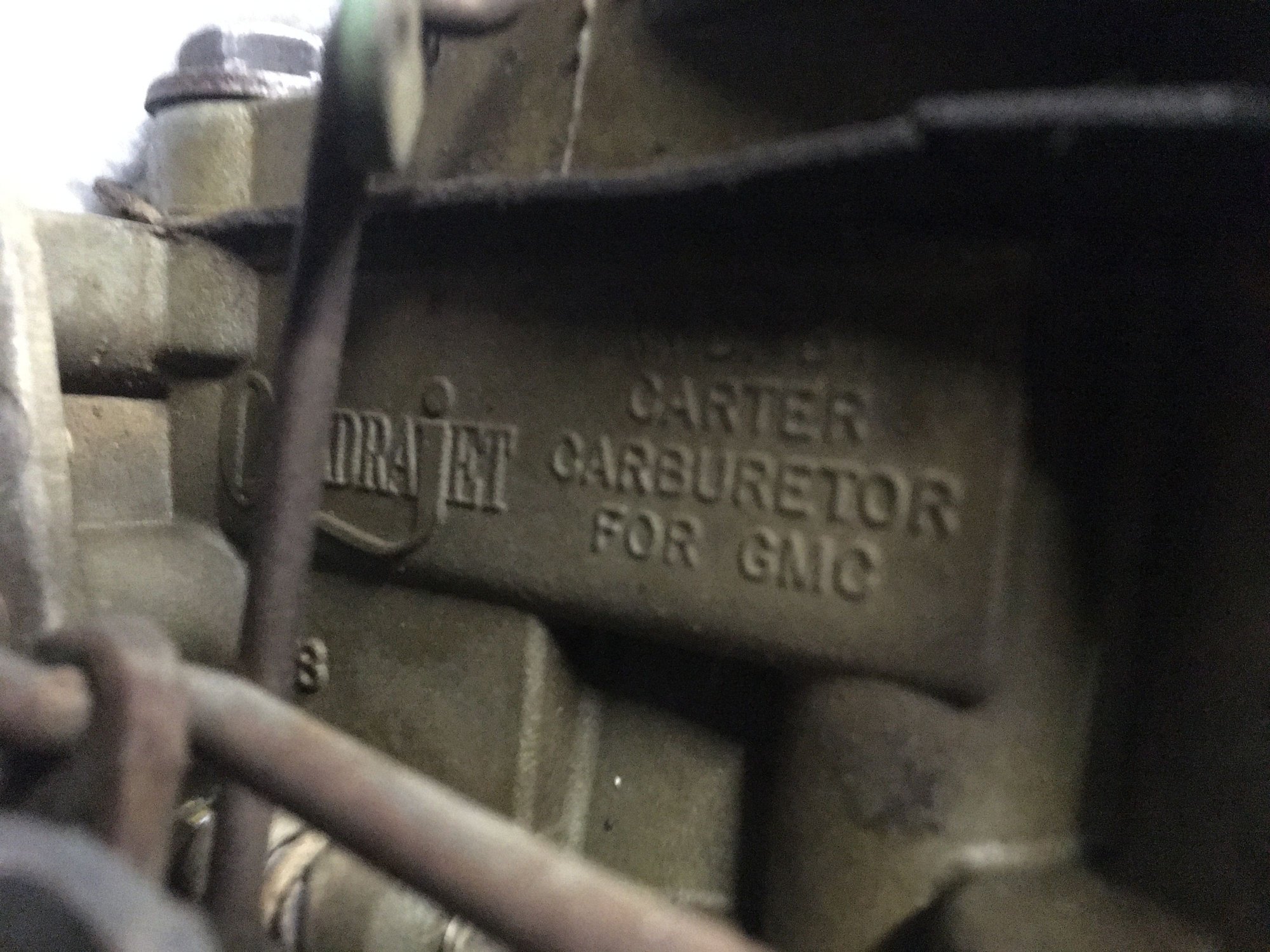

My 79 L82 has a Qjet mnfd by Carter carbeurator for gmc. I though Rochester made the carbs. When looking for a replacement I am really getting confused as many say for my car but then it says not compatible.

Carter Carburetors was also contracted to build the Quadrajet carburetor for GM cars from 1966 into the late-1970s.

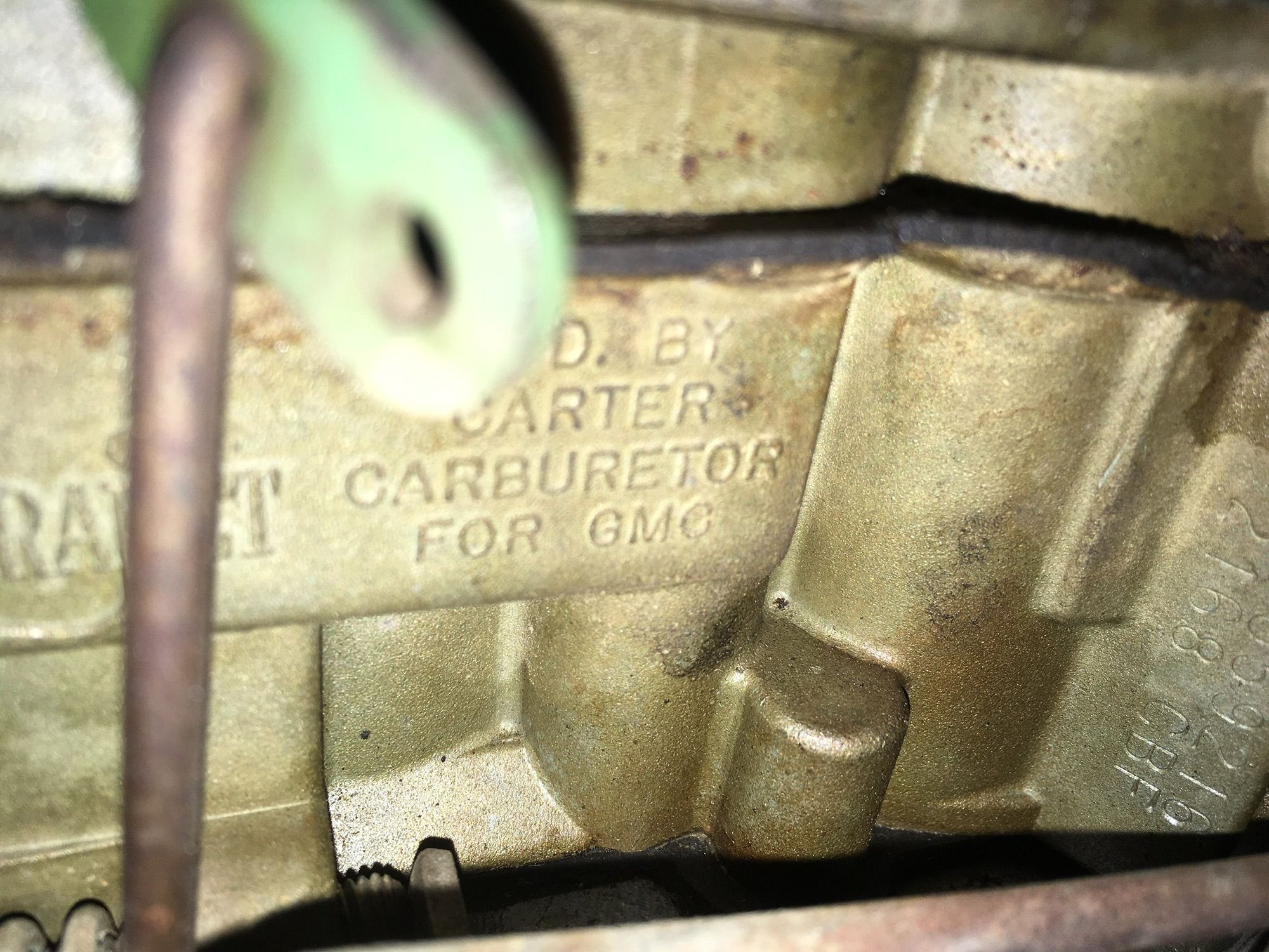

Carter produced the Rochester casting at times. If Rocester was behind schedule, Carter helped out. Not technically a "Carter" carb. Still a Rochester.
Does yours have numbers stamped on it?

It does.

If that number reads 17059216 it is original to a 79 L48 automatic with ac. Dated the 216th day of the year 1978.
If you have an automatic L82 the number on the carb should be:
automatic 17059210 or automatic with ac 17059228 for it to be original

I don’t refute the information (9216) are the #. All the other info on car says L82. No resto or show car. An old car to tinker with. Should not make much difference

A 17059216 manufactured by Carter is the exact same carb as a 17059216 carb manufactured by Rochester. They are the same carb, and both are correct and original factory-installed carbs for a '79 350 Vette with AC and AT. That carb will outperform anything else you can put on your car once it's correctly set up - don't ever get rid of it. It's a 750 cfm carb, and it's not a "vacuum secondary" carb. Have it correctly rebuilt and set up - your best option. That carb is an unmolested original carb in great condition - a perfect candidate for an excellent rebuild.
