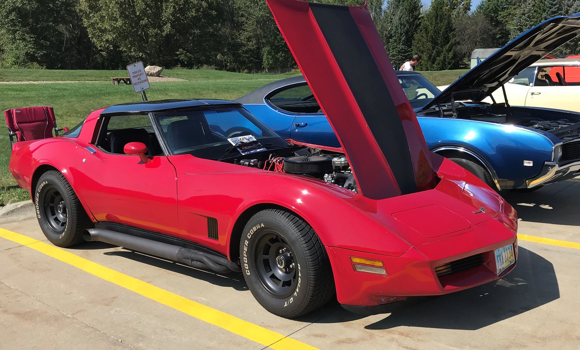

Mostly, sidepipes are just cool. But they can be loud as Jebby stated because they are close to your ears. But to me and a lot others that doesn't matter, they are just too cool to care. The subject of the inserts is one that gets beaten to death here and it is very difficult to compare apples to apples. Sound is subjective. The good thing is you can change out the inserts fairly easily for around $200 if you want to. I have Doug's pipes in black which goes with the red and black scheme. If I were to go silver, I would get the ceramic coated, that's a good option. I got mine from Summit. Originally I had Doug's middle of the road 'loudness' inserts and they sounded great but I wanted louder and better flow so I went to STS spiral baffles. Very different sounds. The Doug's glasspack type are deep and mellos, the STS are sharp and crisp/raspy. I like them both. I also installed 'caps' in mine at the rear end per this thread:
https://www.corvetteforum.com/forums...s-one-way.html
Without the caps they were a little too loud. I don't have shields on mine and we are careful getting in and out and have never burned ourselves. I tell my wife 'watch the pipes', and she says 'I know... I know'.. lol.

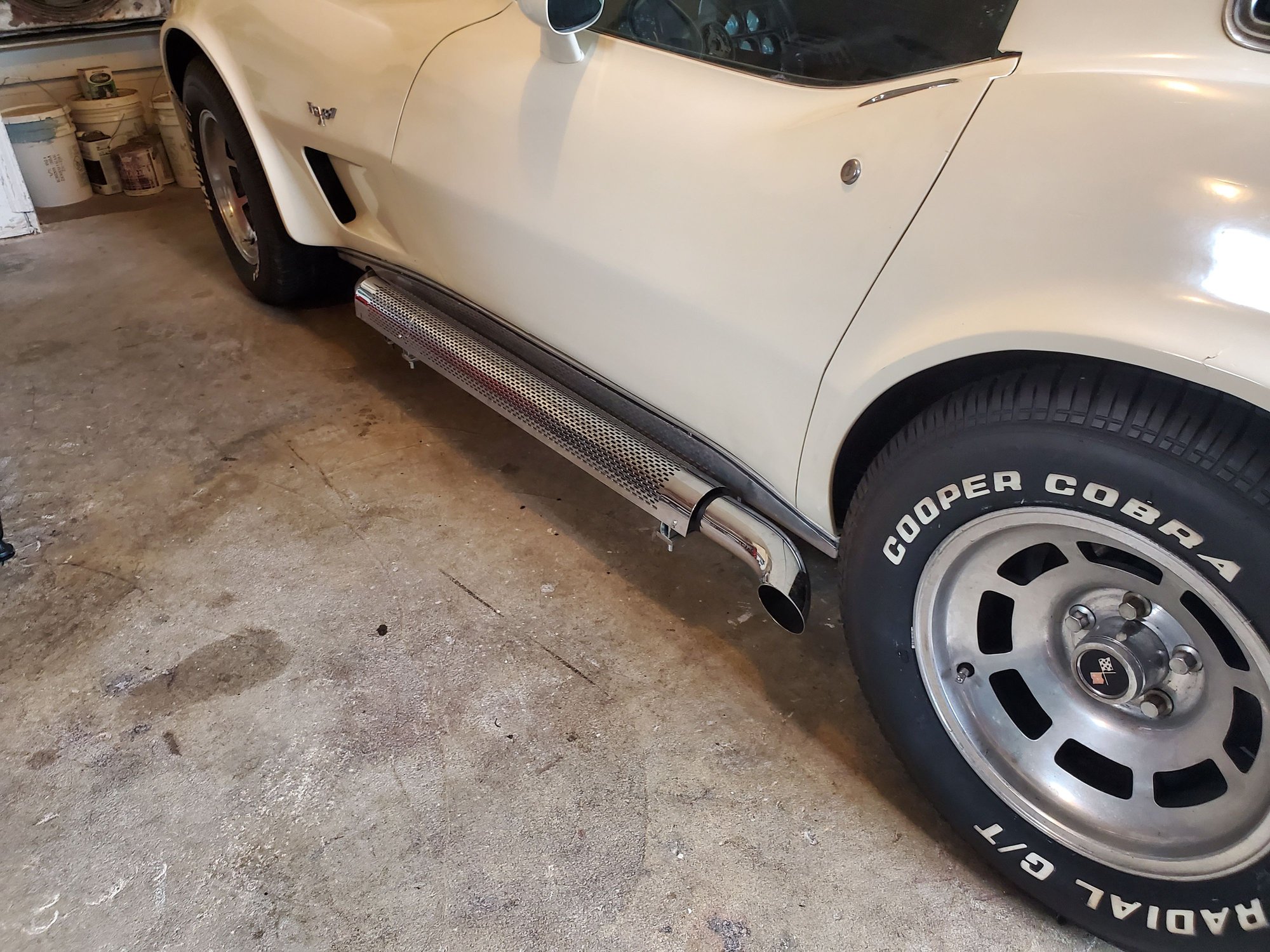

I did Patriots on mine - I would not suggest it if you have the budget for Dougs or Hookers.. I did Patriots because I was on a budget... heres the thing with Patriots that is not made abundently clear when you order them - they are meant to be mounted BELOW your rocker panels, not BESIDE like hookers or dougs - which in my opinion looks completely stupid. Why would you want them mounted below? So - I couldnt accept that - and we did a bunch of fab work for new mounts and some cutting and mounted them in a better location - to do this, youll need to be pretty handy with a welder! All in - i have maybe $400 in this whole setup, sounds freaking great, I got to choose exactly where i wanted everything mounted - but it took me a good while to do and a lot of custom work.
