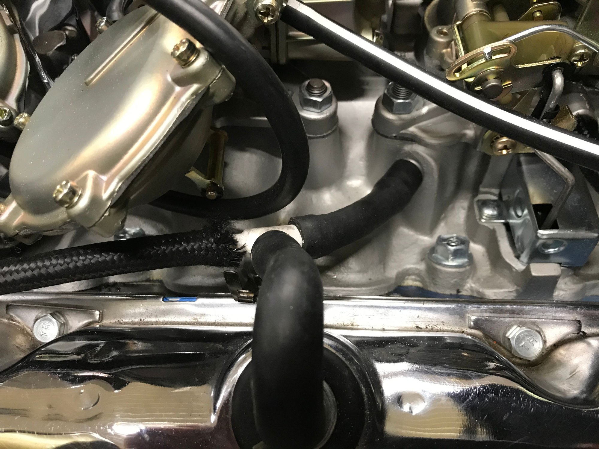

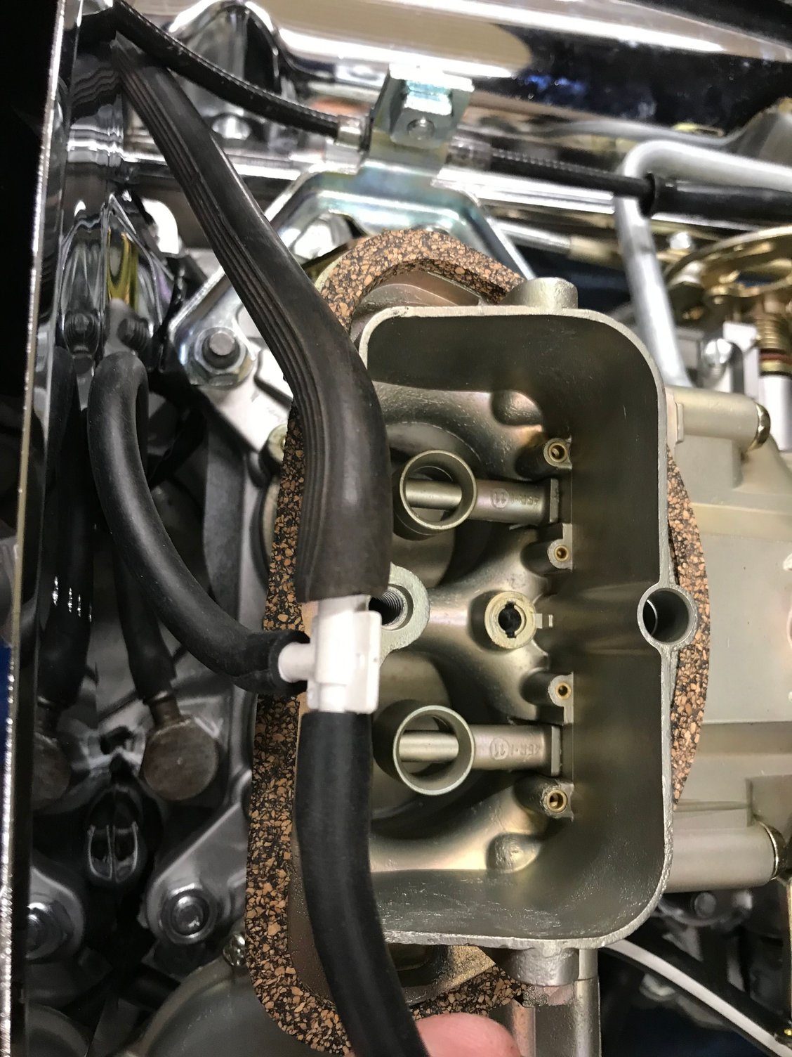

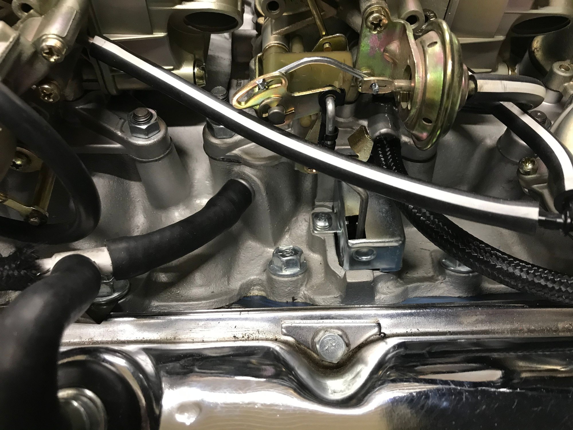

Here are some picture. You Pm me if you want more or talk about what I did. I still need to clean it up etc. I wanted to try it first. 1st picture is tying into manifold vacuum. 2nd is tying into PCV and 3rd is hose ran to canister with ported vacuum.

Hello Joey, great pics, thanks and appreciated. Will send you a PM.
