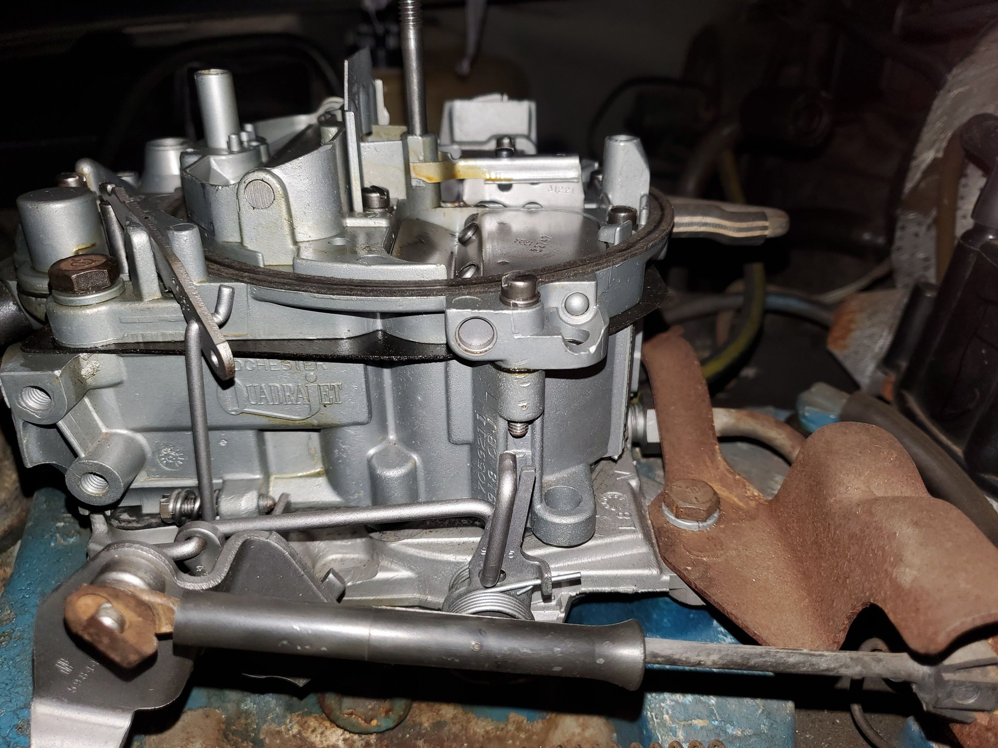

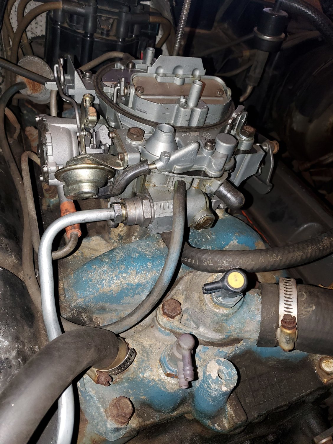

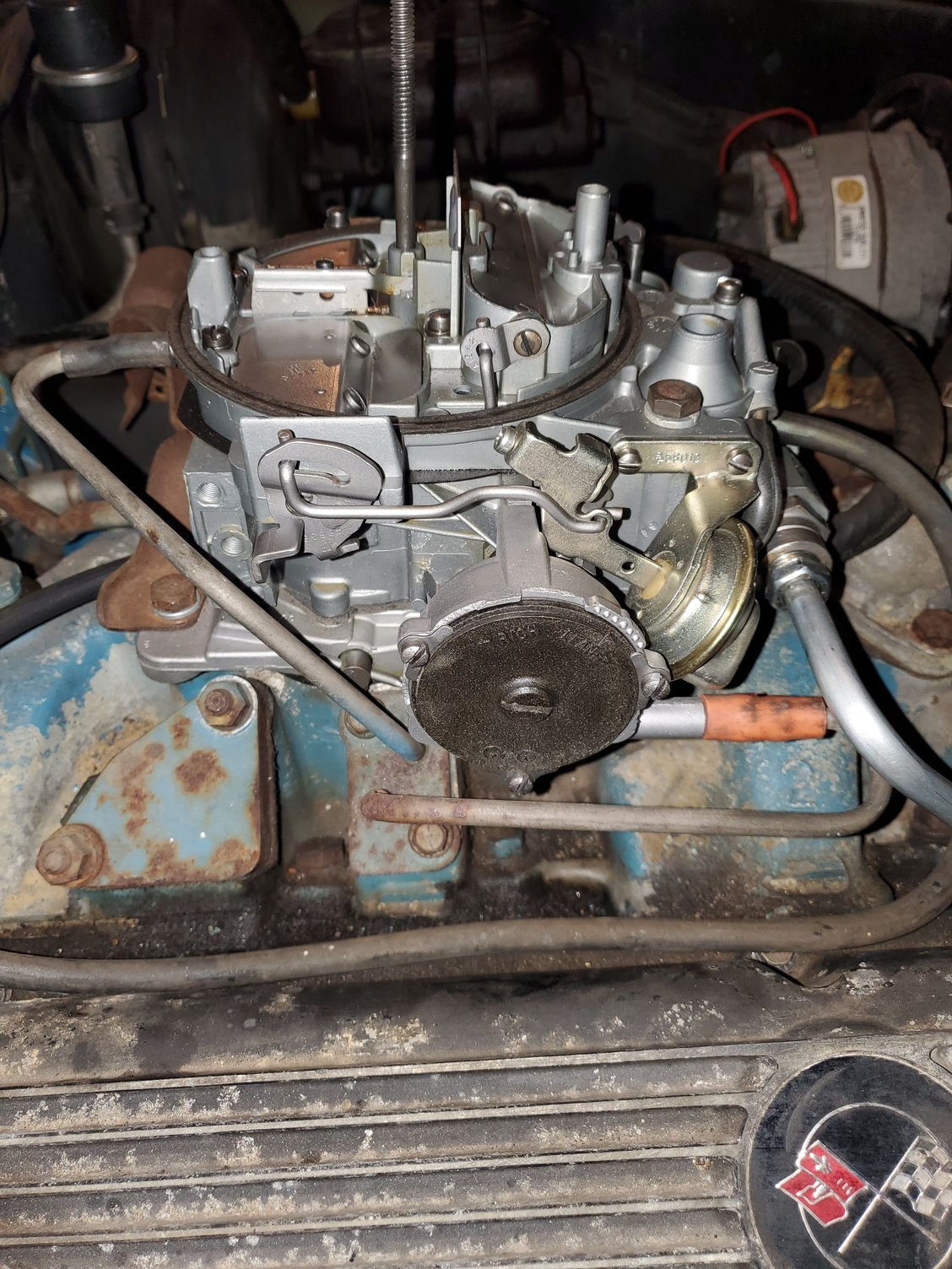

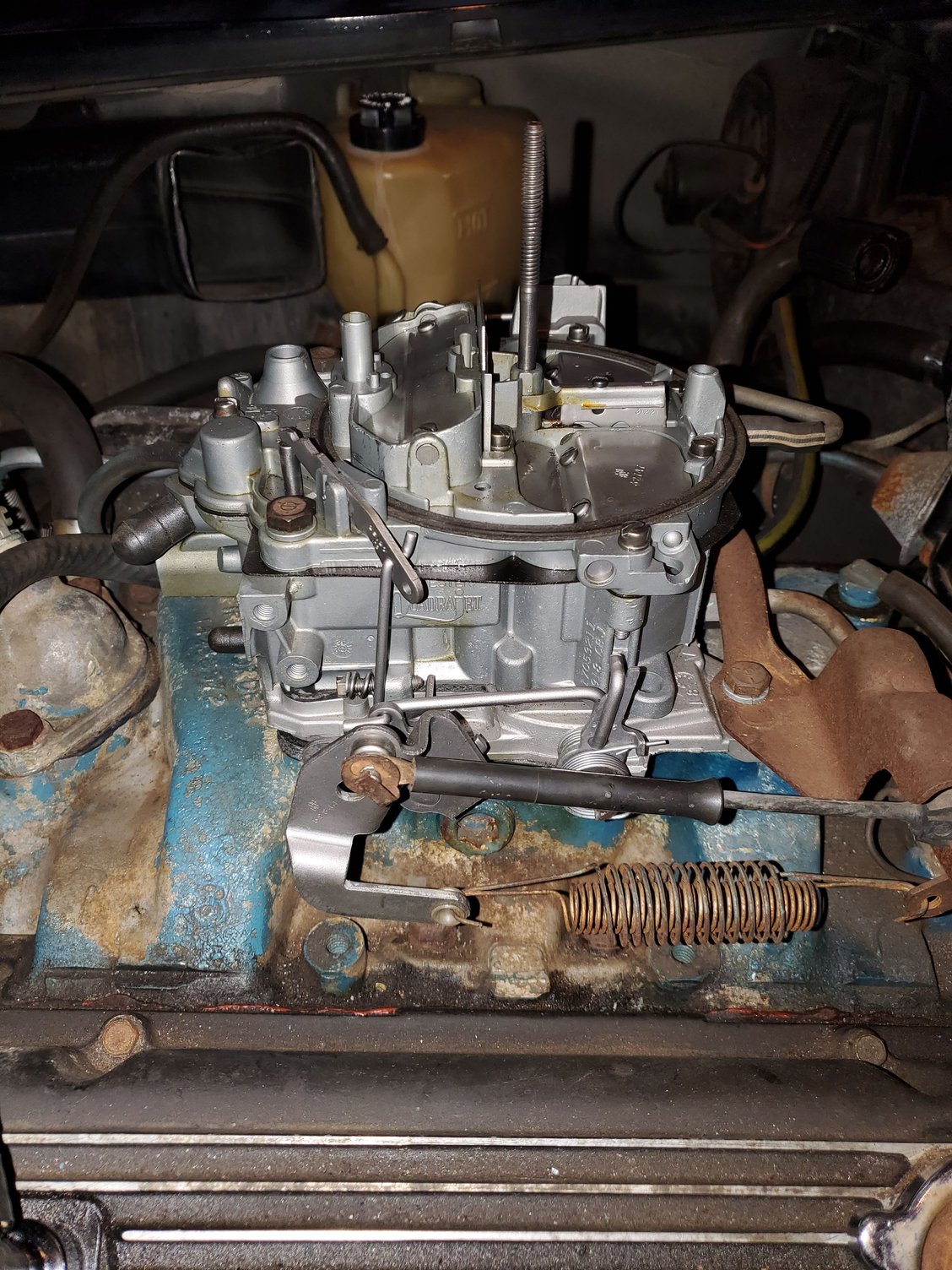

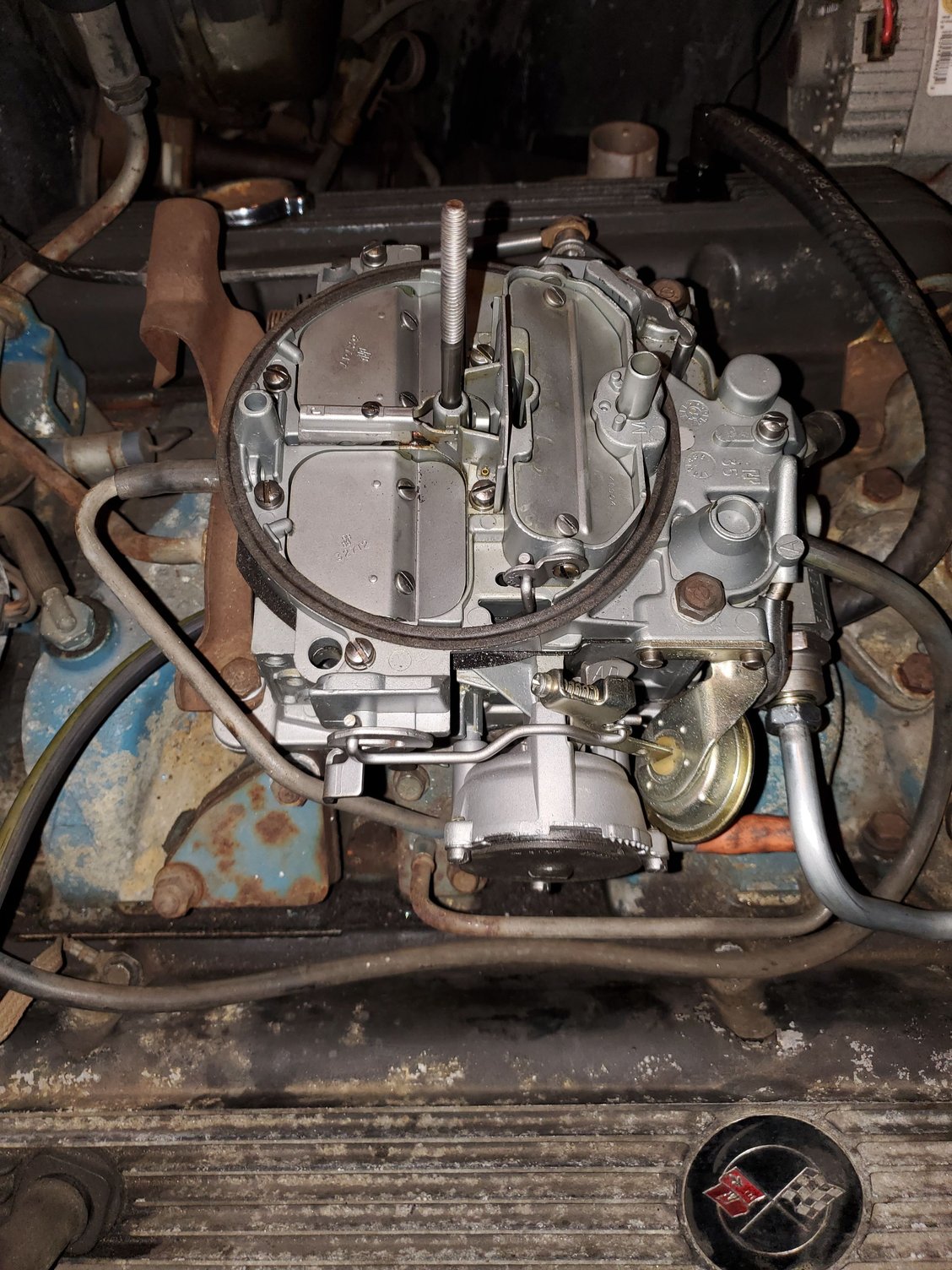

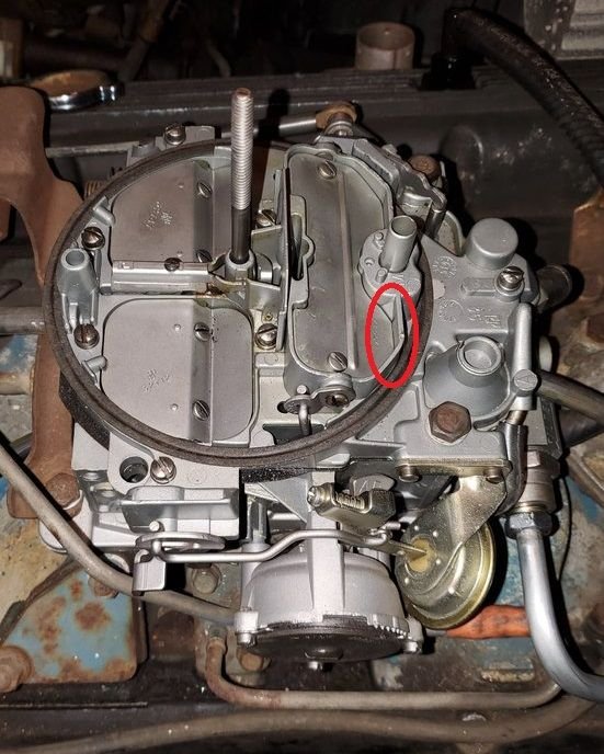

Some shots of my carb...
I tried firing it up again this a.m. and it would not catch unless I had a wide open throttle. After it caught it would run rough and smelt like a ton of gas and gas smell from the exhaust. Felt like it was flooding substantially. I had the carb rebuilt last year and ran great until after winter storage and the fuel pump issue. What could cause the excessive gas getting in the carb? New fuel pump with more pressure than the failing old one? Can an old fuel pump cause carb problems? I strongly feel like it's related to the fuel pump because I didn't have an issue all last year. Thanks!

I would strongly suspect that the needle and seat in your carburetor have gotten gummed up over the winter from the ethanol gas causing the flooding. It's best to make your last fill up before winter storage using non-ethanol gas. A crude but possible solution might be to pour or squirt some carburetor cleaner down the bowl vent tube and let it sit over night or longer. Short of that your carburetor will need another overhaul. I don't believe the new fuel pump is the issue.

What @Roy W. said sounds correct. As long as it was the correct fuel pump, it shouldn't be at fault. It could be putting out too much pressure if the return line were blocked, though.
At this point, I'd strongly encourage you to contact @lars and ask for his Q-Jet papers (and his timing papers, too, they're awesome). For the hard start, it could be something simple, like a choke and fast idle adjustment (the choke looks too closed in the photos, but I'm no expert). But it sounds like the bowls are overfilling. His email is all over the forum, PM me if you can't find it.

That's a real shame what the "reputable shop" did to your carb. Nobody reputable or knowledgeable about carbs sandblasts all the original finishes off the carb and destroys the carb like that... Those people should be shot.
But if it was running OK before, chances are high that you simply have a piece of crud in the needle/seat assembly, or that the float has gotten jammed down into the bottom of the float bowl and is stuck. You'll need to pop the airhorn off the carb, remove the power piston & rod assembly, remove the phenolic filler, remove the float, and remove the needle/seat. You'll then need to blow the carb out real good by blowing through the inlet filter and out the seat hole. Then, blow out the seat real well, clean the needle, and re-assemble it, checking the float level and checking the float for any binding (make sure they installed the right float in the carb - many "reputable rebuilders" install the 4MV float or a brass float, and these will jam and bind in the M4M float bowl). Make darned sure you have the power piston correctly installed with the rods inserted in the jets before you re-install the airhorn.

The fuel pump is a mechanical fuel pump from napa. It is identical to the one I took off. The return line is connected so it has the supply, the return, and the fuel line to the carb. All is new. Why do you think it is too closed? Can it just happen randomly where it could work one day then get too closed the next? Something is definitely not working right! Appreciate your continued help!
I don't know what would cause the choke adjustment to change, but it doesn't look right to me. I think there should be a bigger gap at the front edge on a cold engine. I had hard-starting issues when I didn't have the choke set correctly. @lars's Q-Jet setup instructions have the procedure and measurement.
EDIT: Please read @lars's reply below for the correct choke adjustment.
That is the least of your problems, though, but now you have the attention of folks who are much better versed in Q-Jets and able to help. Checking the fuel pressure is a great idea, if you can do it safely. You could rig up a simple T in a spare fuel line, but make sure you switch back to a solid steel line from the pump to the carb for normal operations.

Joe -
With the engine off and cold, the choke should, in fact, be fully closed with no gap at all - the photo shows the correct and normal position. You can see that the engine is not running, because the choke pulloff is not retracted. Once the engine starts, and the pulloff retracts, the choke will crack open 1/4", if correctly adjusted.
