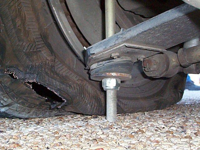

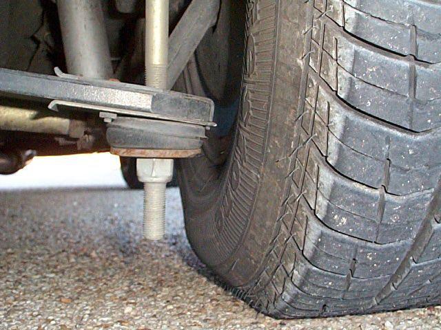

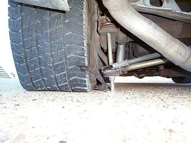

I was going to stay out of this but I can't let all the bad info in this thread go. It has been well known on this forum for over 15 years that the TRW style springs manufactured by Muskegon Brakes commonly have too much arch. Yet the Corvette parts sellers still sell them and play innocent when someone has an issue. Its pretty simple; if you are manufacturing a spring that requires 10" bolts for proper ride height, they should be included with the spring. The reason they aren't included? Because they are unsafe as the following pictures illustrate.
The spring end can gouge the tire sidewall and cause a blowout under spirited driving. 10" bolts are not an option! If the spring requires 10" bolts for an acceptable ride height; it is defective and should be returned to the seller for a full refund including shipping.

Wow....that must have been a noisy blowout. I wonder what happens when a composite spring breaks in the middle? Does the fiberglass body fall down and contact the wider tires?
Broken Composite Spring
This is exactly what I was talking about in my earlier post.
I urge you to replace that spring with a proper and safe spring and bolt set up in your car.
If I remember correctly the blowout pictured above occurred at a low speed.
Just imagine at highway speed.
Zip already agreed to take the spring back.
Why risk it?

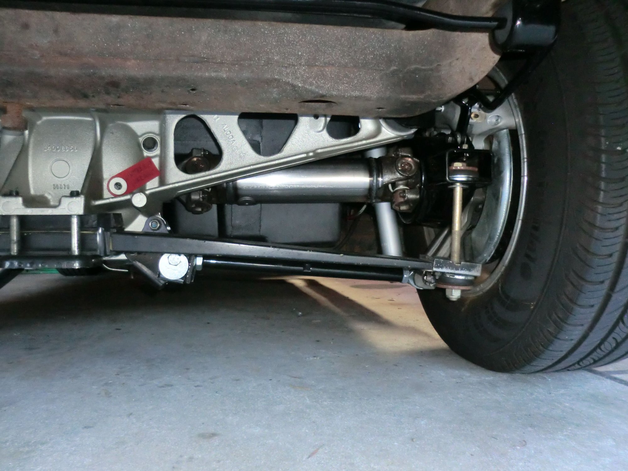

Here's the obligatory photo of my 80s rear end, with the VB&P spring, 8" bolts (only using 7), and nearly flat half-shafts. And no spare tire, either. She sits on 255/60R15s, which is a stock tire size.
Perhaps if these threads keep ending up on the Forum, we can save a future member some grief.

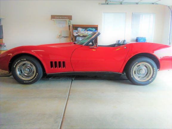

Old Mar 19, 2020 | 07:15 PM
  #71
Bikespace's Avatar
Bikespace
Joined: Mar 2017
Posts: 11,953
Likes: 4,508
Originally Posted by Redvette2

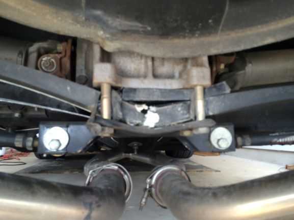

After reviewing all the great information that came from your post string and looking at my car again, I think I am just going to leave the stance of my car alone. If anybody asks I will tell them it is designed that way to improve the torque transfer from the wheels to the pavement during 1st gear burn outs. Best of luck in your quest!
Side view with 1.5 inch rear higher.
Tell them the wedge shape is to push the rear of the car down at higher speeds. It prevents oversteer. GM did this with J-Body cars, like this Cavalier.

Originally Posted by Bikespace
Tell them the wedge shape is to push the rear of the car down at higher speeds. It prevents oversteer. GM did this with J-Body cars, like this Cavalier. There are rubber bumpers that should prevent the trailing arm from moving too far upwards. If you've removed these bumpers, or run wide tires beyond the fenders without flares, that's on you.
Thanks...I also was thinking that extra wheel space in the back is to help generate more smoke during the burnouts. As far as the bumpers...yes my tires are right at the edge of the fender. Going to look for those bumpers first thing tomorrow.
Edit Update: I have bumpers...whew.
That must have been an interesting ride. Two thoughts:
1) End of bolt should have been trimmed.
2) Blowout is nowhere near where the end of the spring is. It is much closer to the tread.

Originally Posted by 7T1vette
What fool would use a bolt with EXCESSIVE length and not cut it off? That was the problem....not that the bolt was longer. Let's get real with 'causal relationships'.
The problem was the end of the spring punctured a hole in the sidewall of the tire. The end of the bolt could have been cut off and you still would have had the same relationship of the end of the spring to the tire with the same result of the punctured tire.
