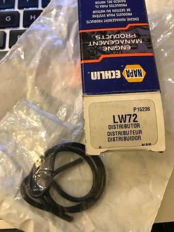

Wire came in today. Can you see what's wrong?
VS. what it is supposed to look like...
Barcode on the back of the plastic bag doesn't match box.
