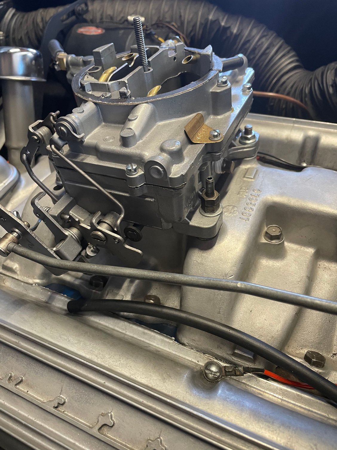

I just went through a situation like this with my 62. 327/340 AFB 3269S. It was carburetor percolation due to the carb getting too hot. I had block my exhaust heat riser ports with fuel injection intake gaskets. Then I added a 1/2” phenolic spacer under the carb. These two cooled down the carb considerably. The other thing I did was I added a small electric pump on the suction side of my mechanical pump for vapor lock. I am at 5300 feet here in Colorado and vapor lock is an issue. I also should add that my car has a new fuel tank, sender, fuel suction lines, fuel pump and rebuilt carb. The hot die off has been an issue with this thing since I got it in 2021. Now the problem is gone.
