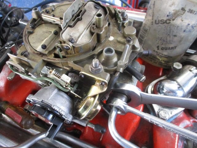

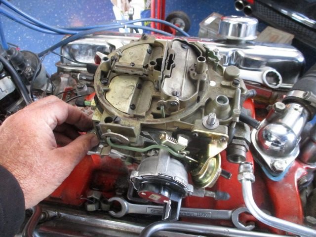

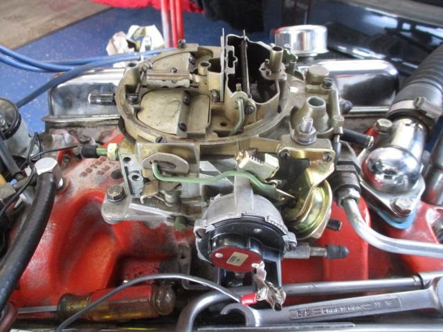

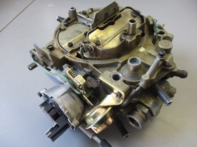

I just received his carb a couple of hours ago. Here it is on the workbench for inspection prior to test:

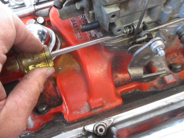

Checking the setting of the idle mixture screws, I found them to be imbalanced, with one set lean and one set rich. I set them both to a nominal setting of 6 turns out from seated:

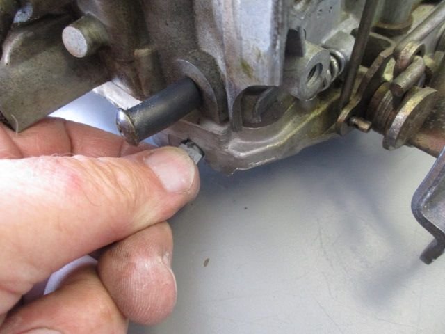

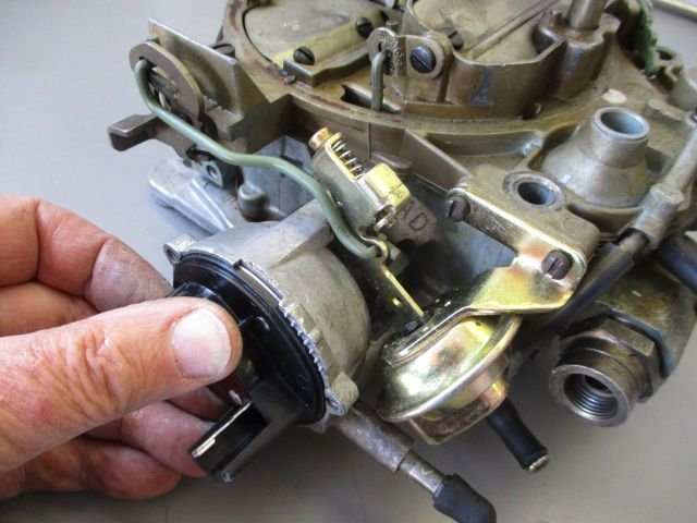

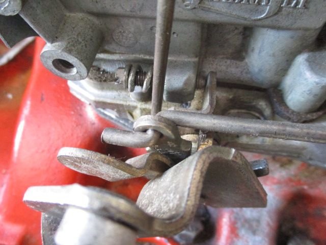

I also checked the odd clocking of the choke housing. The clocking and setting turned out to be OK:

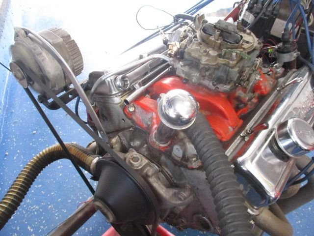

Carb was then bolted up on the test engine:
Fuel line snugged up to the inlet fitting:

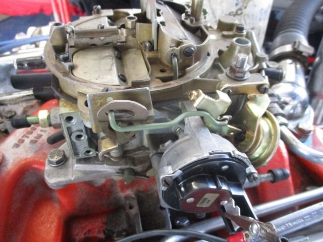

Since I had just completed testing of another Forum member's carb on the engine, and since the engine was up to operating temperature, I applied power to the choke to get it to open and to verify its operation:
The choke opened as it should:

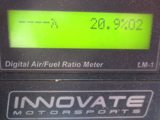

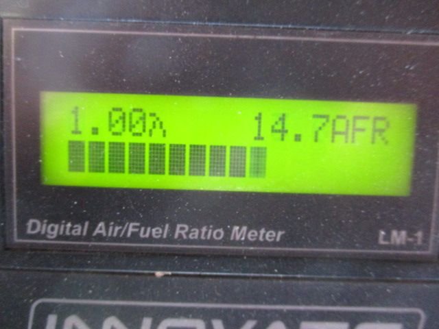

Calibration of the wideband oxygen sensor was verified prior to engine start to make sure I was not going to get any false air/fuel mixture readings:

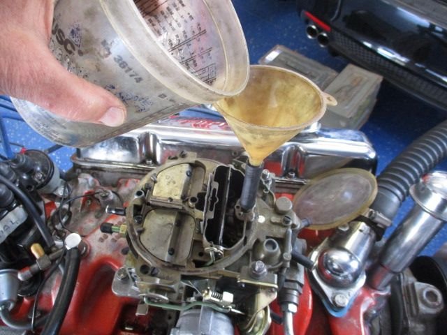

Carb bowl was filled with fuel to assure instant start:
Engine fired up instantly at the first touch of the starter. The carb running on the test engine:

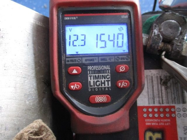

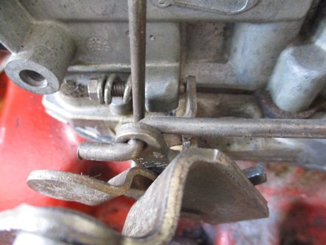

The hot idle screw was adjusted very high - screw here seen in the as-received position screwed in pretty far to hold the throttle open, confirming what Dennis has stated in his previous post about needing to have the carb set to a high idle speed to keep his engine running. This high idle setting was "forcing" his engine to idle:
This setting had the engine running at an idle speed of over 1500 rpm:

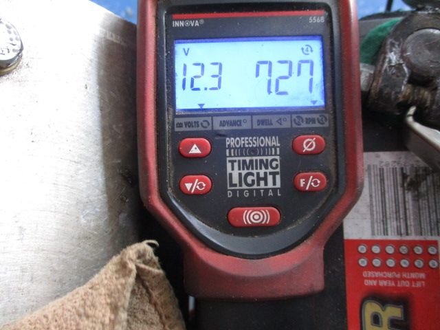

I then backed the idle speed off to see just how slow I could get the engine to idle at a stable rpm:
The carb's idle circuit is working perfectly, and I was able to get idle speed down to a smooth and stable 727 rpm before it wanted to kill the engine. My cam does not like to idle below 800, so I was amazed that the carb would allow a stable idle speed at this low of a setting. The carb is running and idling exceptionally well:

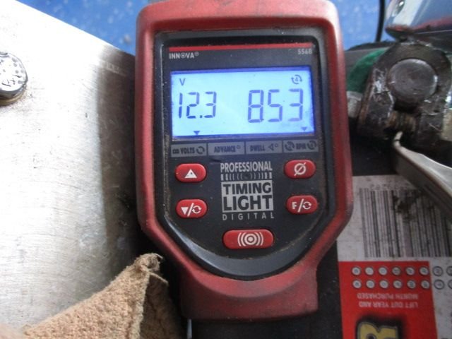

Note the significantly different position of the idle speed screw at the "correct" idle rpm versus the screw's position shown in the similar photo above:
At a smooth and stable idle rpm of 850, the idle mixture is right on the perfect number at 14.7:1. The carb could not be running better:
Throttle response is excellent, and all aspects of the carb are in perfect operating order. He absolutely, positively does not have a carb problem, even though the engine builder would certainly like him to believe something to the contrary...

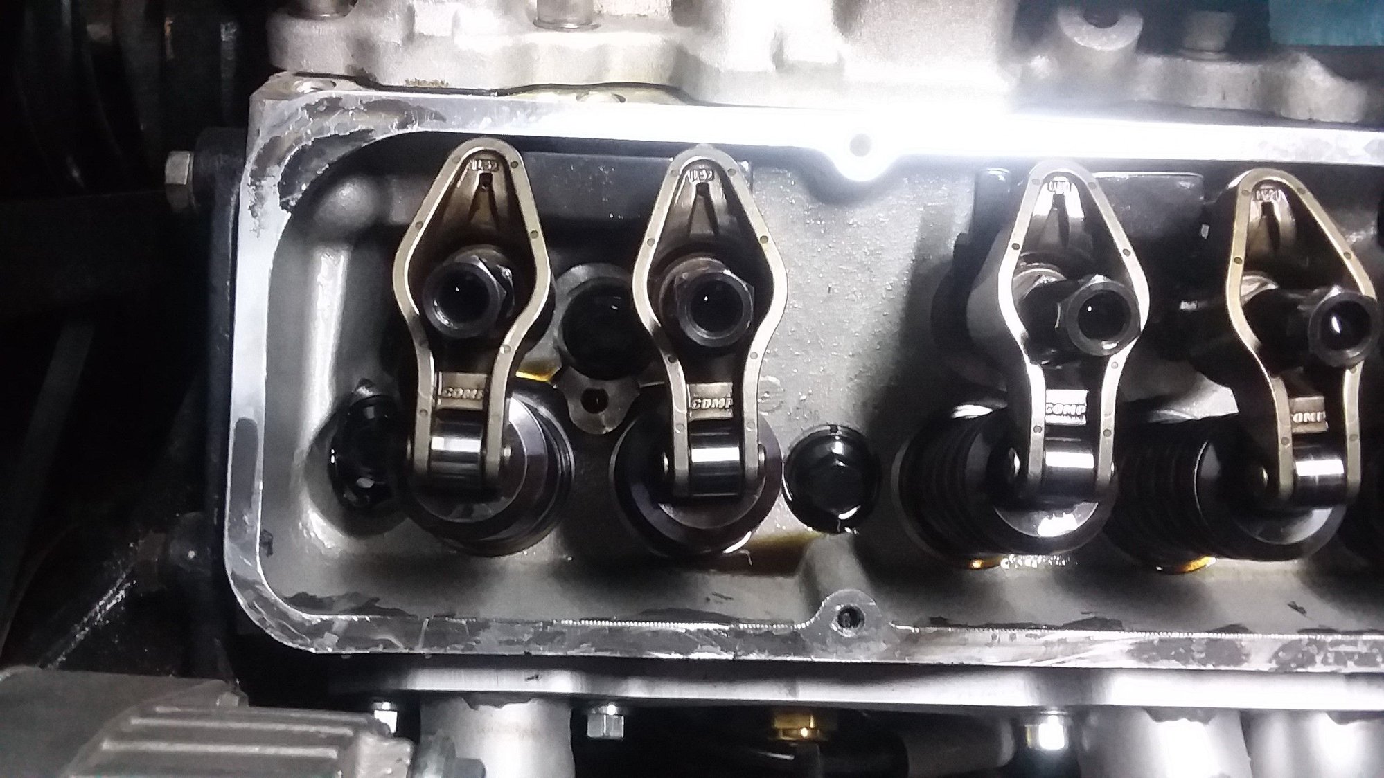

My weekend project now is going to be try to take the cam measurements outlined in the other thread. I have a machinist rule as you suggested. Depending on what I discover I will be in touch with the shop on Monday. Stay tuned.

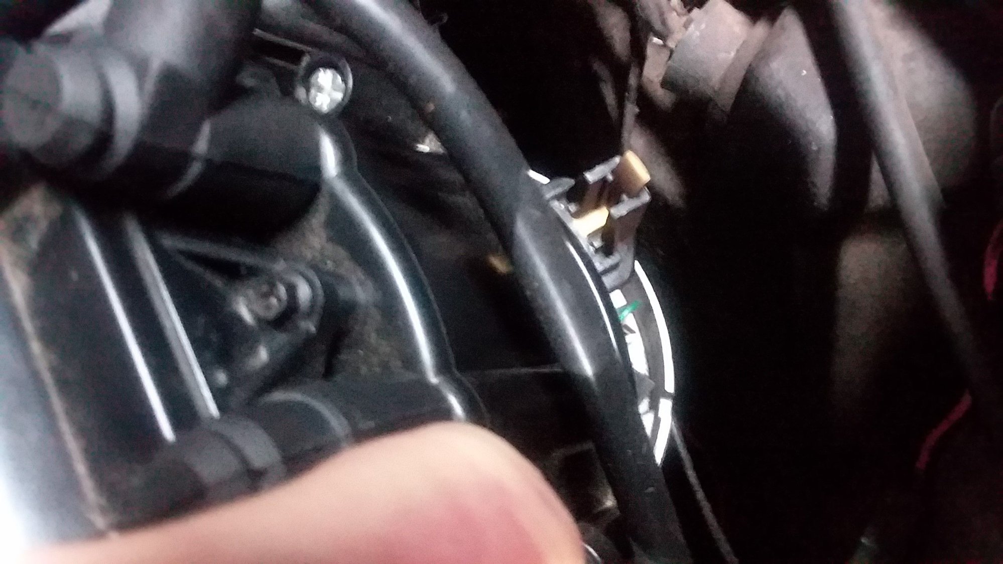

I did the cam timing check and if I am doing it right and measuring correctly the intake retainer is closer to the head than the exhaust by about .050" So this indicates that the cam is in the engine correctly?
exhaust on left, intake on right?
TDC?
rotor pointed opposite #1 terminal

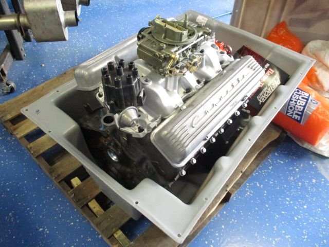

Improperly-built engine received from Chicago in a flat rate box:
Upon teardown, so many problems were found that it probably would have run very similar to Dennis' engine...
Lars
