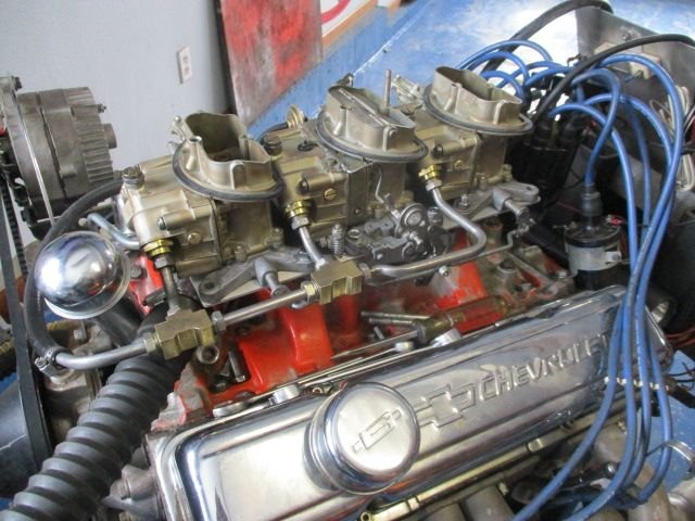

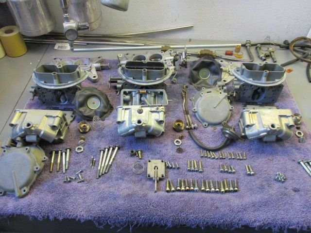

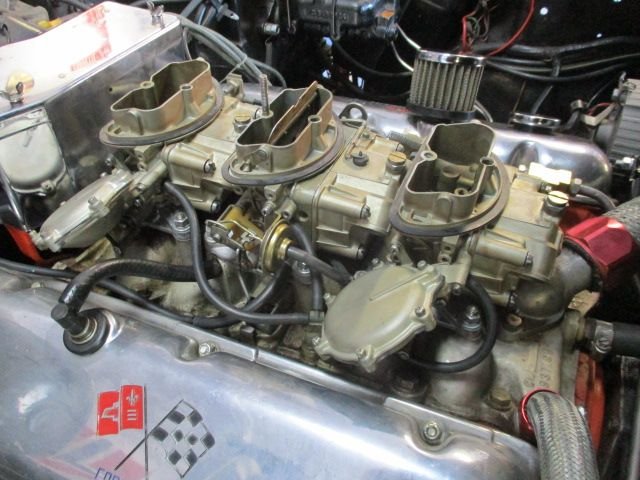

Some photos:
All 3 carbs disassembled:
Testing the system on a 357 small block:
Back on the engine and running perfectly after setup and tuning on the test engine:

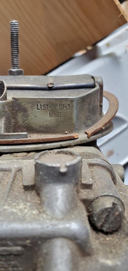

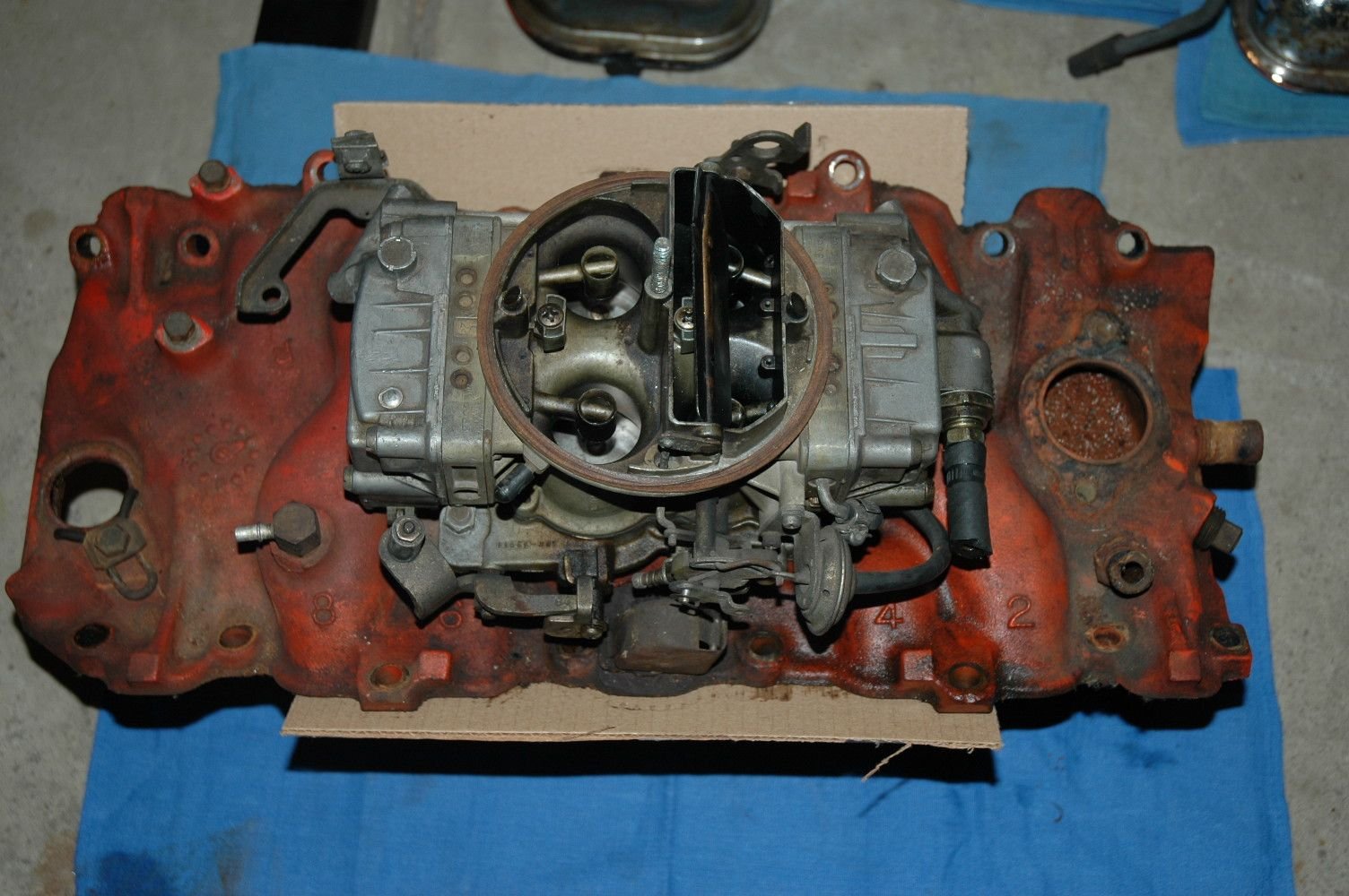

I'm going to include this question on this post because I know you guys will have the answer. This is the intake and carb that came on my 68 427/400. I bought a tripower setup and had it rebuilt many years ago. After talking about rebuilding my tripowers I thought I'd practice on this setup. My question is what rebuild kit do I need for this and is this intake and carb worth anything and is it something that anyone would be interested in buying? The intake is a 3955287 from the 70s and off a 454/390hp. Who knows maybe I'd put it on the 68 and give it a whirl. What do you think?
Thanks guys,
Jim
Old May 6, 2020 | 06:07 PM
lars's Avatar
lars
Joined: Aug 1999
Posts: 14,380
Likes: 6,391
The 6210-3 is a little Holley 650 cfm model 4165 spread bore aftermarket carb. It is set up as a "direct replacement" carb for a Q-Jet, and has the hookups for the Q-Jet divorced choke. It takes carb rebuild kit part number 37-605 ($48 from most sources).
