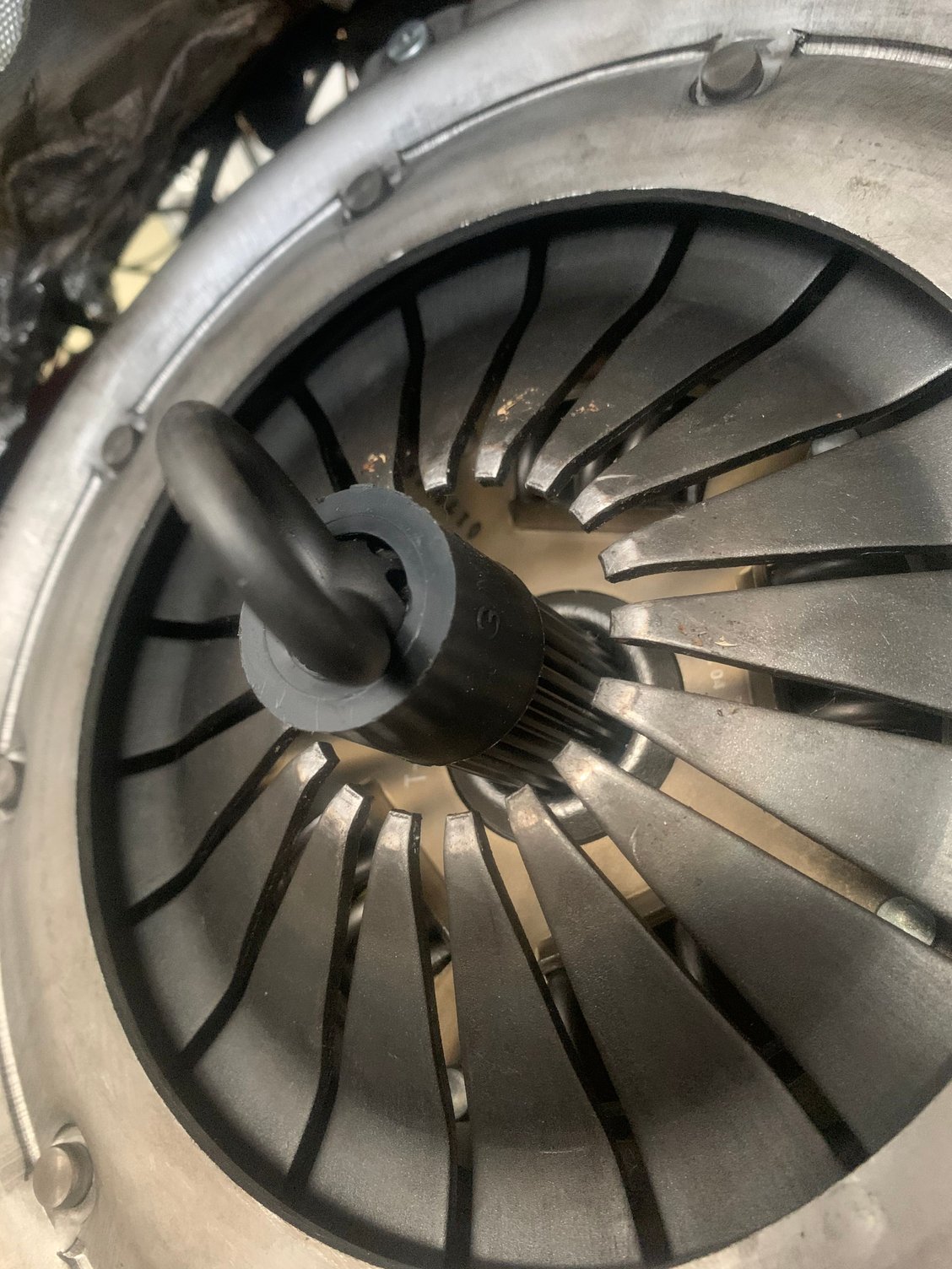

In goes the thing that looks like a thingy.
Installing the pressure plate was no problem.

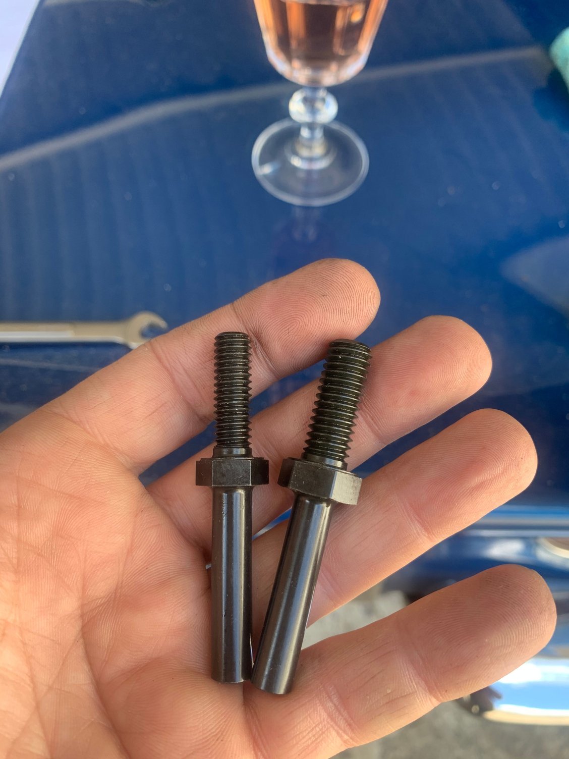

Studs to guide the throwout bearing.

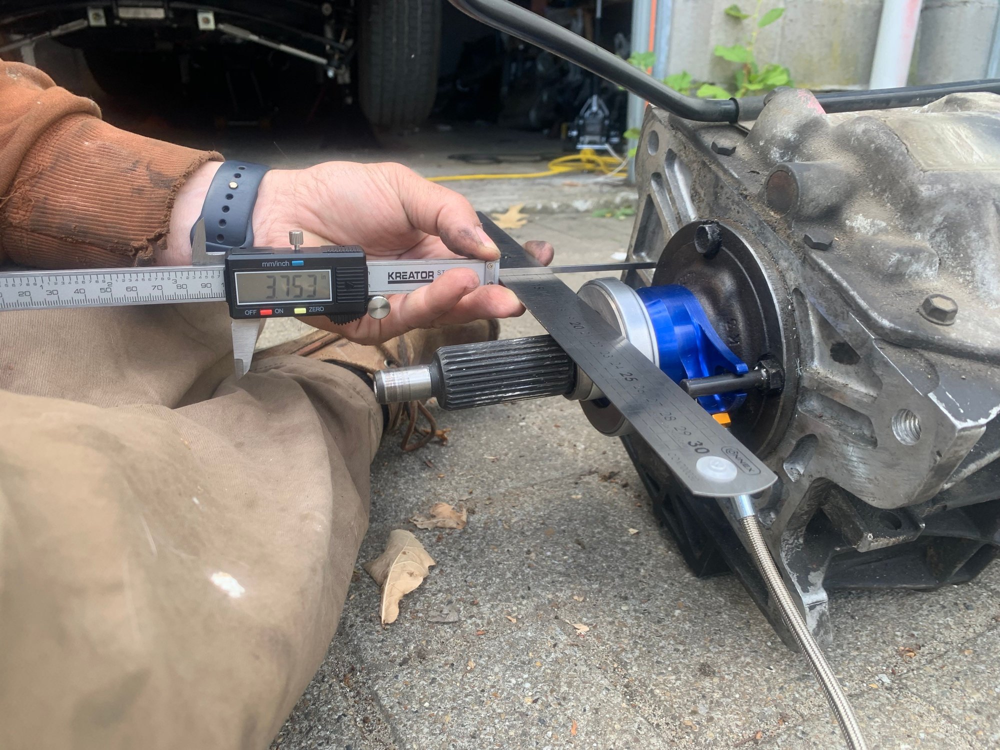

And here is our pickle. The distance from throwout bearing to trans is larger than the distance from pressure plate spring fingers to the bell. What that means is that there is an overlap of 0.200.
I can’t shim the throwout bearing closer. On full release the bearing will already be, not only touching, but depressing the pressure plate spring fingers. Furthermore, I need at least 0.100 air gap. I could add washers between the block and the bell, but only to a maximum of 0.200... I would still be 0.100 short.

Mmmm. The only thing that I can think of that might resolve this without having to purchase a low profile hydraulic release bearing, is that the clutch disc has been replaced. Maybe, as the release he never been actuated, the spring fingers need to settle.

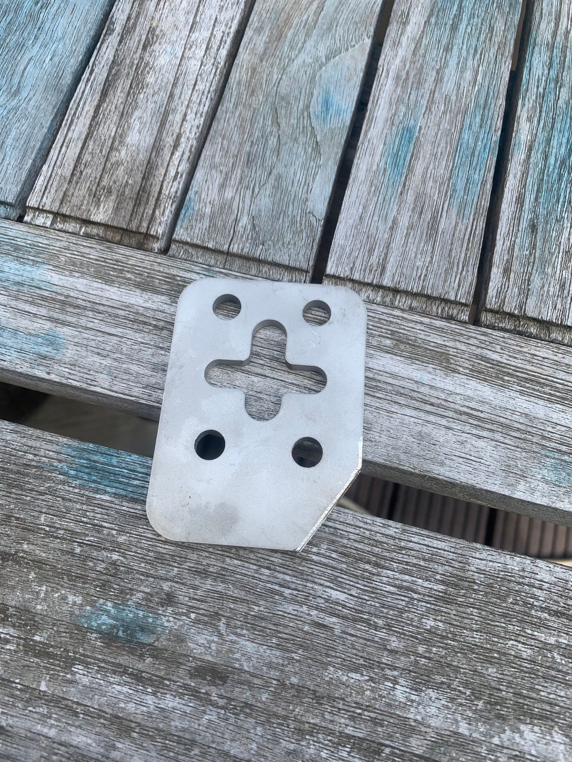

This is always available for a block that's not drilled for a z-bar stud, if needed.

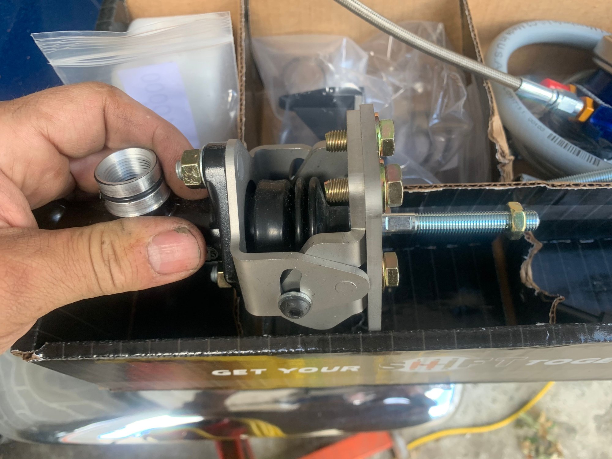

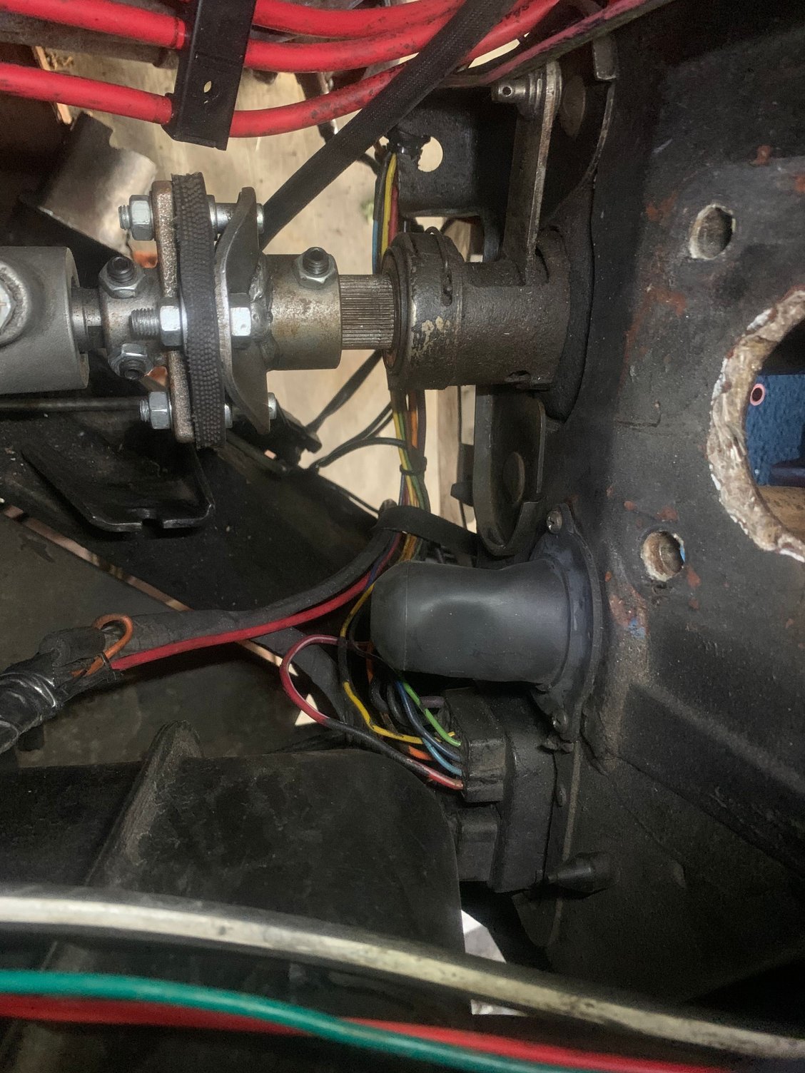

Hmm. Pressing on... although I’m not sure the American Powertrain kit will even work.
I thought it would be possible to install the master cylinder without removing the booster. What was I thinking
AP solution to effecting the correct actuation angle.
Mounted on firewall. So far I have to out of three bolts in.
I guess there’s no returning the kit now. I trimmed the back plate to clear the steering column base, but it turn out that plate + firewall are too thick for the bolts. I’ll keep it any way... for the day I come by longer bolts. That being said, the firewall is lined with steel and is quite sturdy.
The kit starts getting confusing when the instructions cover over stroking and pedal home.

Ha !!!! Well what do you know ! This is helpful!

So show us a pic of the backside of that release bearing. It attaches to the input shaft cover. And you need about .3 inch. Where does the throwout bearing sit?
