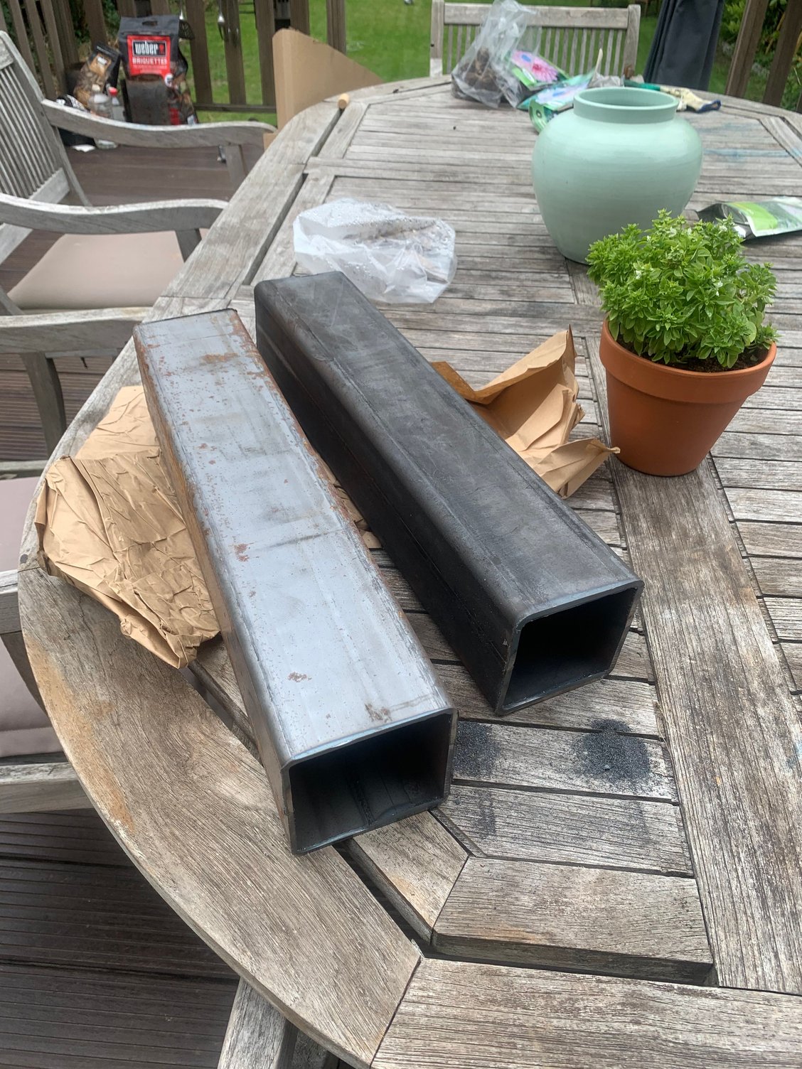

Angle iron came in
I should be able to fabricate some brackets out of this.

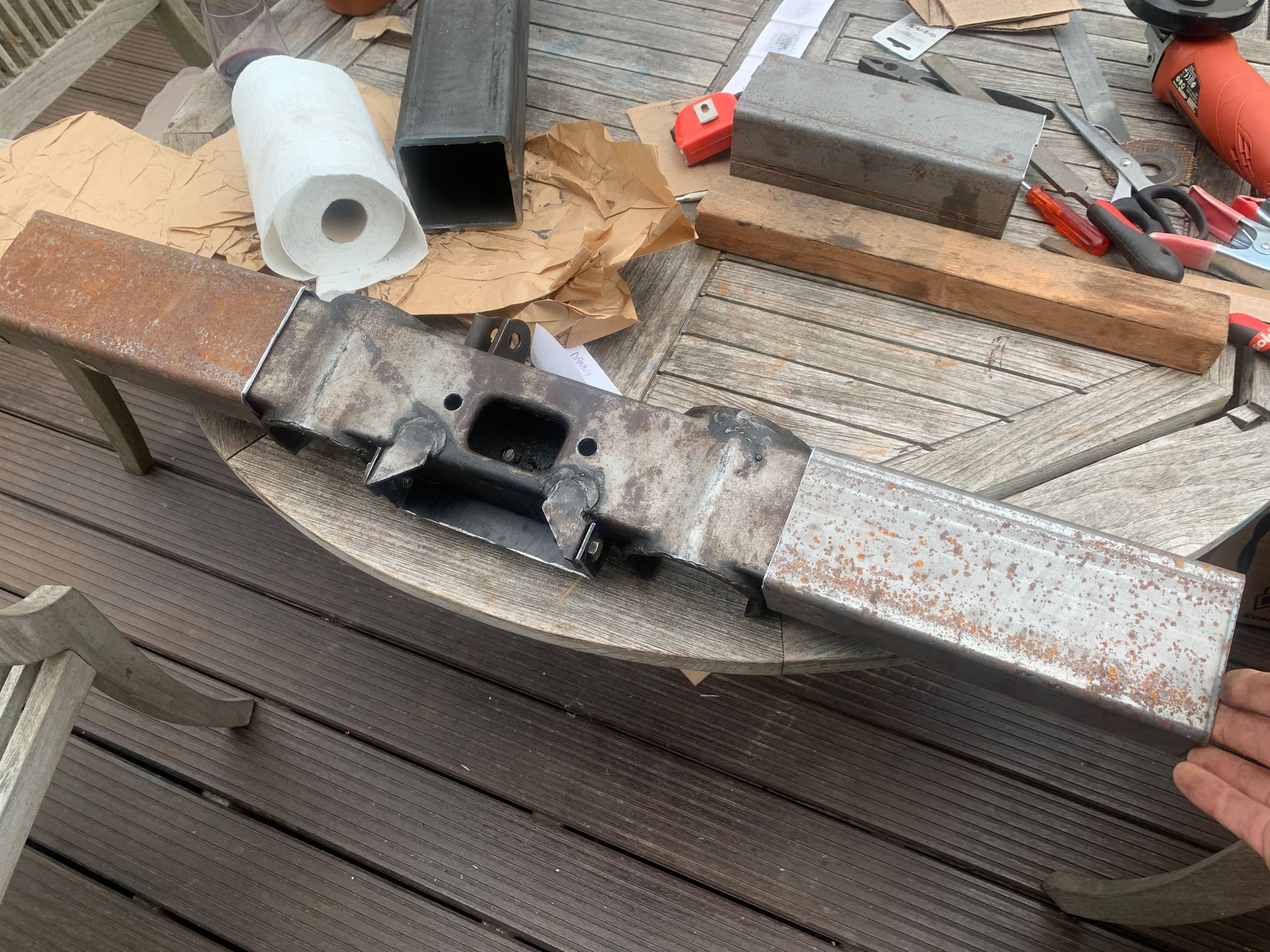

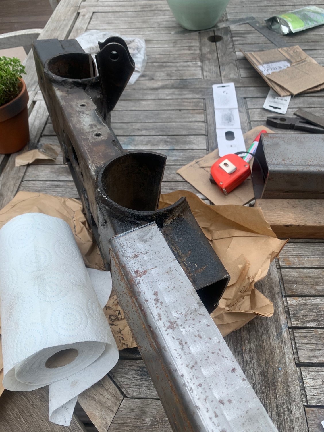

Looking reasonable.
This looks good.
Some holes to drill. Another plate to grind and a bracket to relocate.
