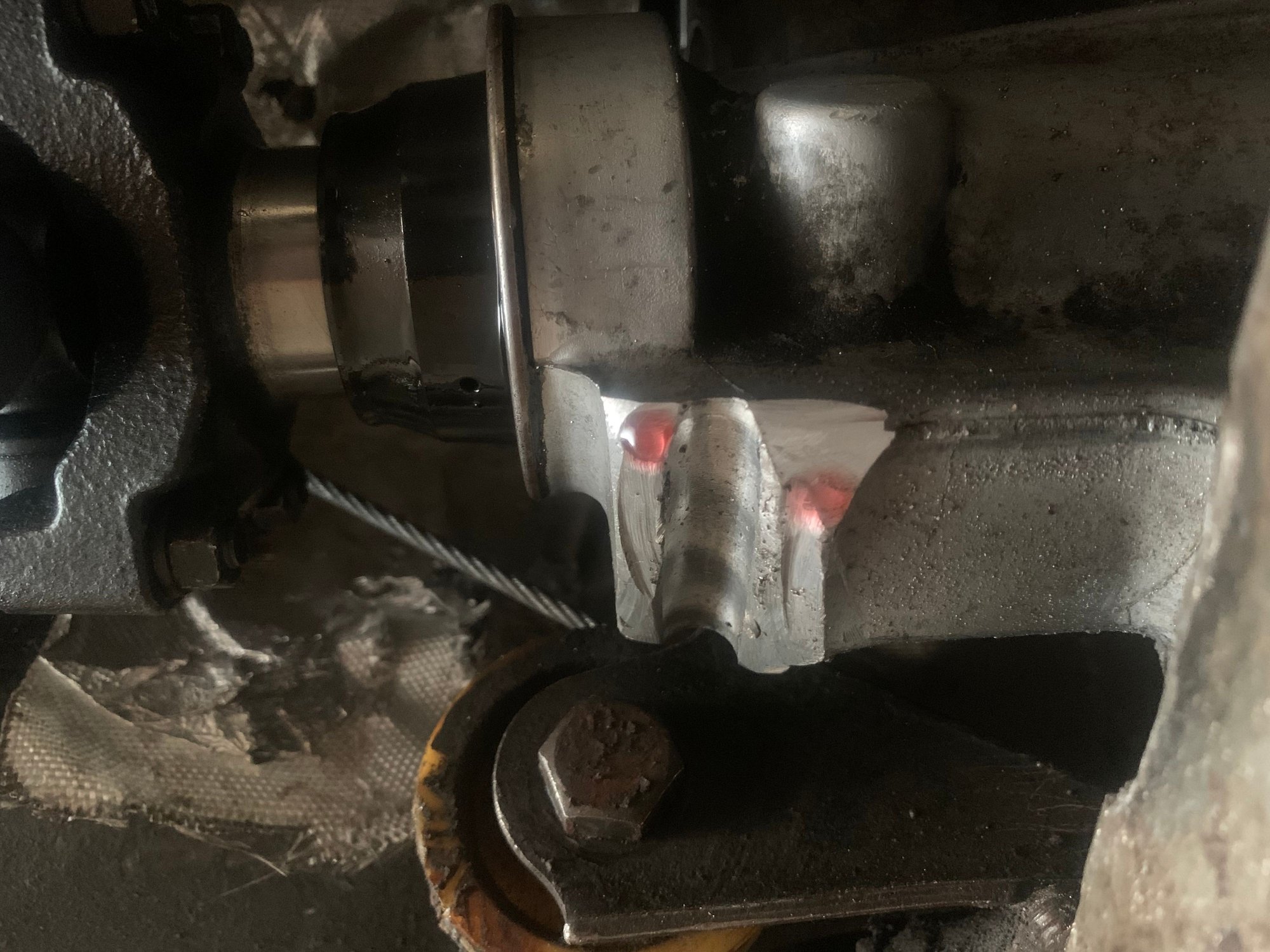

On the other hand I discovered this:
It looks like it is leaking out of rear seal.
I pulled the upper plug and did the finger-dipstick test and found it was way low. Hopefully no damage.
I’ll have to check that vent tube. Maybe it’s kinked.
The question now is that rubber boot. I know the seal is under it. I’d rather not damage the boot as I replace the seal.

Do ensure both tailshaft housing Bushing and outer Surface of Yoke are Not worn; if either damaged or worn, No seal can seal.
