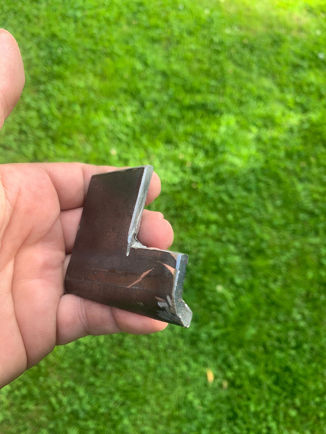

Need to trim the base plate so the fanned bracket can clear. Things need to be as low profile as possible.
Hmmm. I did a better job than I thought.
Reasonable clearance.
A simple bracket
To weld to the stub.
Bbbrrrrzzzapppp

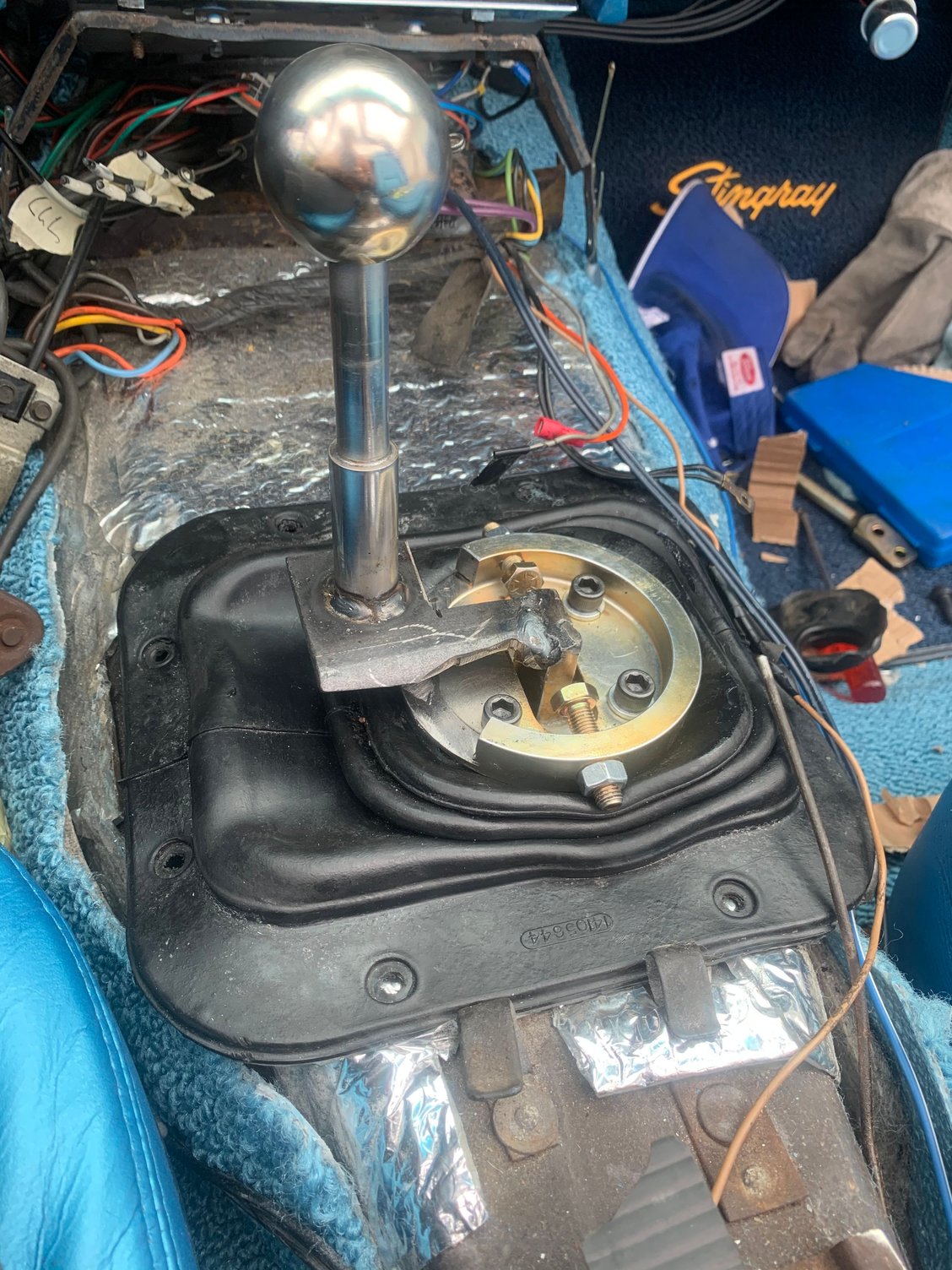

Mocking it up. I still have to get the lower rubber boot in (I’m going to hate messing with the console) but so far, I like the way it’s coming along.
Can one remove the console leaving the climate controls in place ? Can the console be popped over ??? I’d hate to disconnect everything.

Yes. You can remove the console and leave the HVAC control head and its metal frame in place. Gotta do a little careful wiggling, but not difficult. You do know about the two nuts on the underside of the forward tunnel brace? Those connect to the two studs at the bottom of the gauge bezel. Remove those nuts or any force on the studs will break them. If I recall correctly, there are slots in that forward brace, rather than holes; so you can just slide the tunnel off the studs (I think). Suggest you use a mirror to check that situation out before disassembly.
You also need to remove the fiber optic cables from the plastic lens gizmos mounted to the trans. tunnel.

I couldn’t resist. I took the console out and started in the lower boot.
I’m not exactly sure how I’m going to screw this down but I’ll bet the hardware shop will have something that will work with fiberglass.
BTW, I am really pleased with the action of the shifter.
i just need to figure out how to reinstall the abused console.

Originally I was trying to come up with some clever way to screw in the lower boot. After some thought, I decided to try riveting it in place. The base (metal) of the boot was quite compliant and easy to shape to fit the tunnel.
Some duct tape and some dumb-dumb to seal. I think it worked out well.
I HATE working on the shifter console. Brittle plastic. A jumble of wires and cables all threatening to dislodge each other. Strangely, the bit I was most worried about was quite straight forward. I was really worried it was going to be .
And there you have it. Now for a test drive
