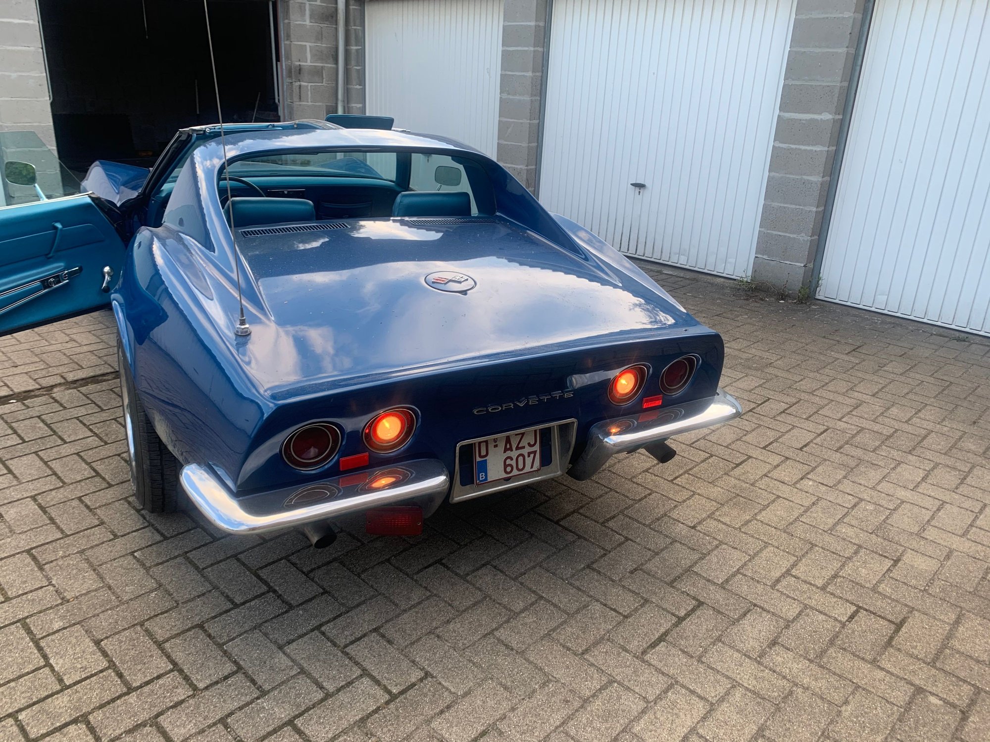

First time on all fours in a long while.
The light switch works.
Shall we go for a test drive ?
