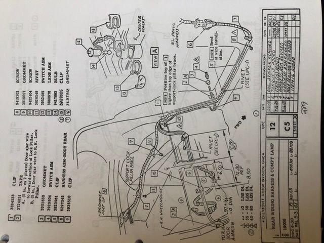

On my 68, the red and black wires go to the middle compartment light. The wires on mine come out of the rear harness at the same location as your 69.

From the 69 AIM. View A shows the compartment light and connectors. The wiring schematic shows the wires as being black and red.

cool I didn’t realize there was a compartment light.
