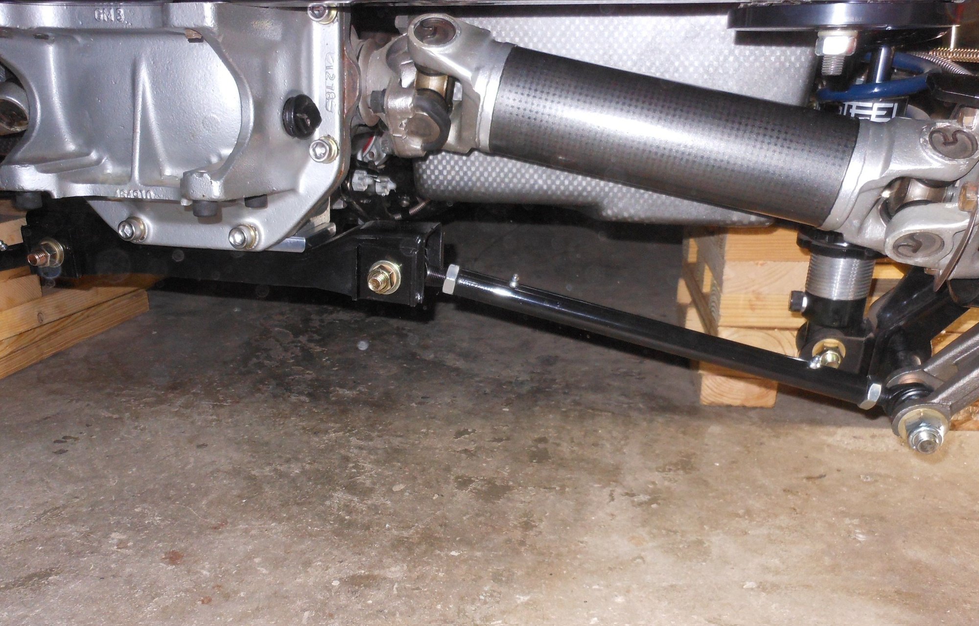

Works GREAT!!! 2 x 4s- I used 3 1/2" deck screws to build and carriage bolts to connect two stands together- 18" height -Super sturdy.

I made some years ago using this design:
The main supports are 2x lumber sandwiched between 3/4" plywood. I used 2x6s 15" long to make the base set. Width is 12". I also made a shorter set using 2x4s that will stack on top of the base set (lower right image). You can fill in the spaces between the 2xs if you want more support but it makes them much heavier. I've used this set on both my Vette and my Suburban without issue for many years. Add gate handles to them to make moving them around easier. If I was building them again today, I'd figure out some way to pin them together when stacking. There is no issue once the weight of the vehicle has settled on them but they can move independently a little when loading and unloading.

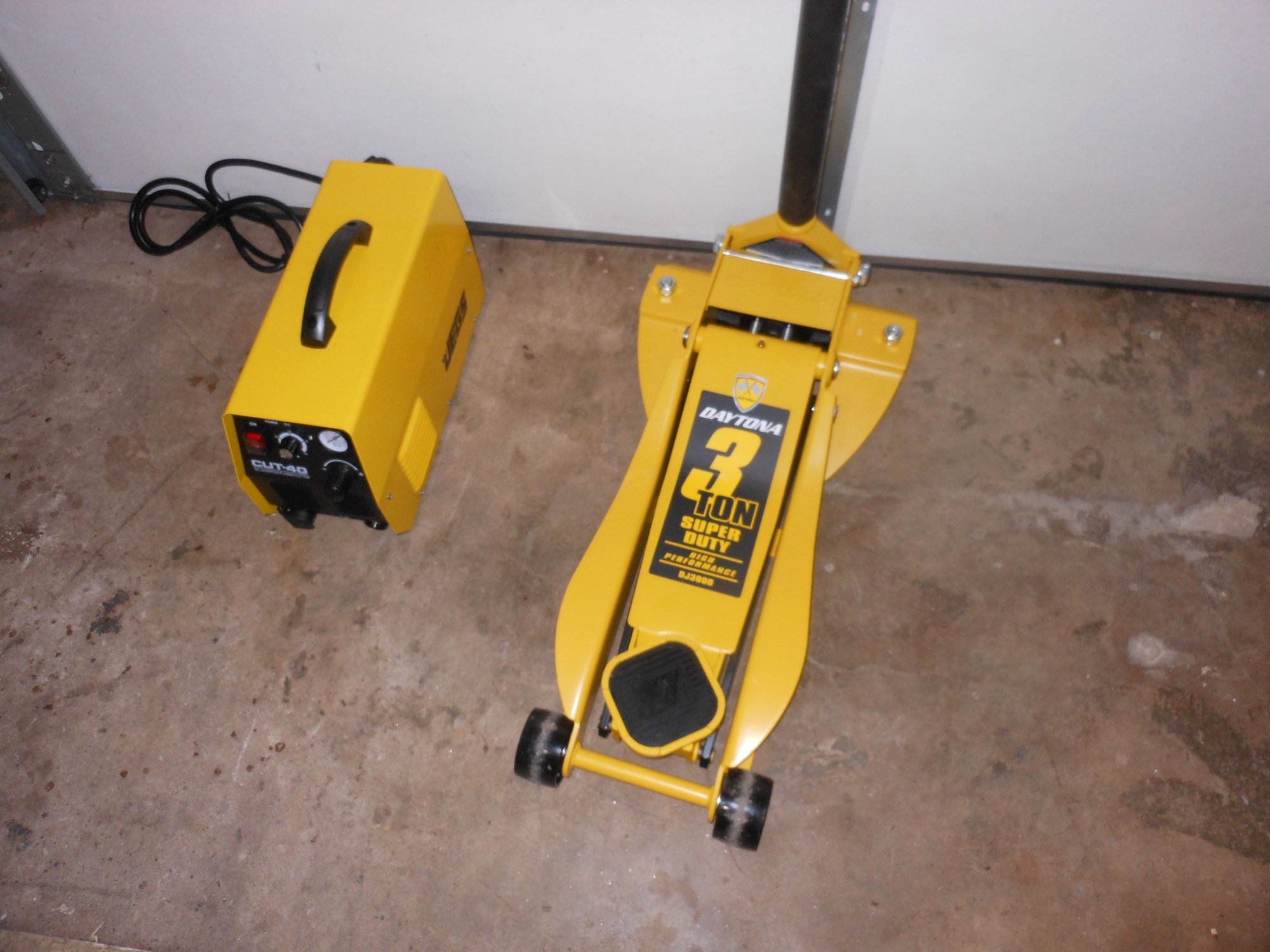

Originally Posted by sunflower 1972
Just curious, what do you use to get the car that high up so you can use the wheel cribs?
I've got a HF Daytona Jack - almost 2ft of lift- and I'll put it a couple of 2 x 10s underneath it.
