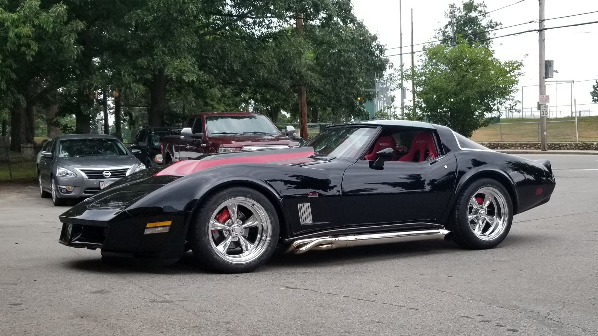

On the bright side, I love the jump from 15" Torq Thrust to 18". They came out great, however I had one wheel that was showing a ton of roadforce. I managed to get it down to a somewhat reasonable level, but I think it may be a bad rim. I may have to try to get it replaced, not sure how much luck I'll have with that though.

BTW - those 18" wheels look fantastic. Not too busy some gaudy things I've seen.
