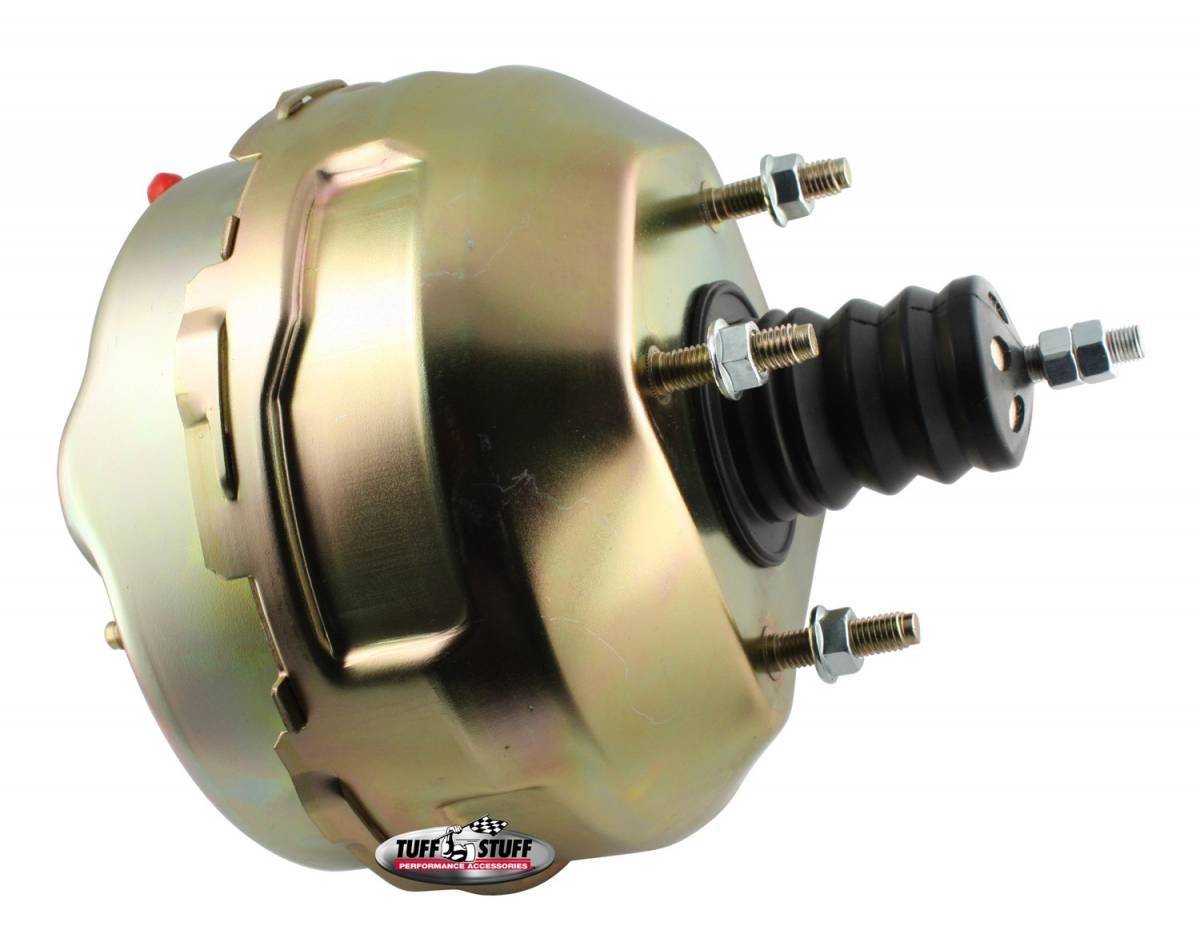

Is it a Tuff Stuff booster?
No it is not tuff stuff but looks the same as theirs. Bought at corvette pacifica.

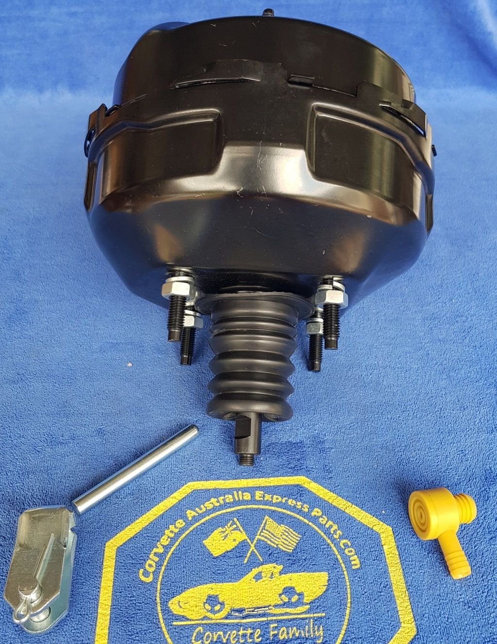

I did call the vendor and I'm stil waiting for feedback.
In the box was a clevis to brake pedal connector and a metal "rod" for I don't know what.
Is it possible that it has to be cut to size and used as a master cylinder "spacer"?

Post a pic please. Does the back of the booster look like this?

This is the booster I've got.

Ok, so yours is different than mine but I'll suggest this. The brake clevis pin connecting point and the distance to the tip of the m/c rod is a fixed distance. Take your old booster assembly off and before doing anything else, measure that distance as accurately as you can. Now on the workbench, measure your new booster distance. They should be close to the same if not the same. If there is a difference in length, thats all you need to figure out how to get it the same as the old one.

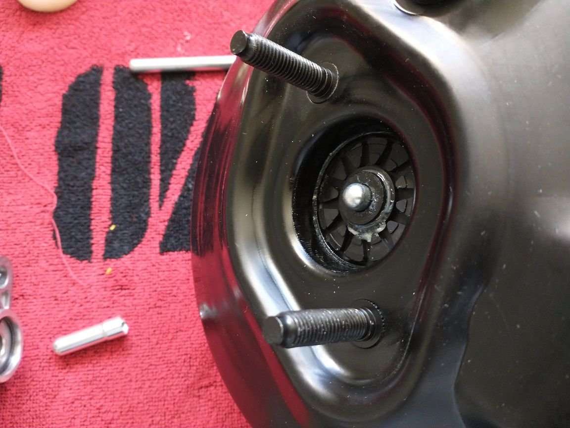

Got around and mocked up the setup.
Probably will work without any issues with the Wilwood supplied spacer plug.
To Brake booster

you just have to measure the distance that the spacer goes into the plunger and the distance it will stick out of the booster. THere is a tool for this but you can do it with a digital caliper/ vernier.

I tried that but the measurements are inconclusive..... wait you gave me an idea.
Will measure again and post the reply later today!

OK! I measured the distance roughly with the vernier and the space measured is 1.3 mm. The gap should be around 0.020" that is 0.5mm.
Since the space was measured with everything disassembled the assembled booster an master with the master cylinder bolts tightened the gap should narrow to around 0.5mm or there about.
